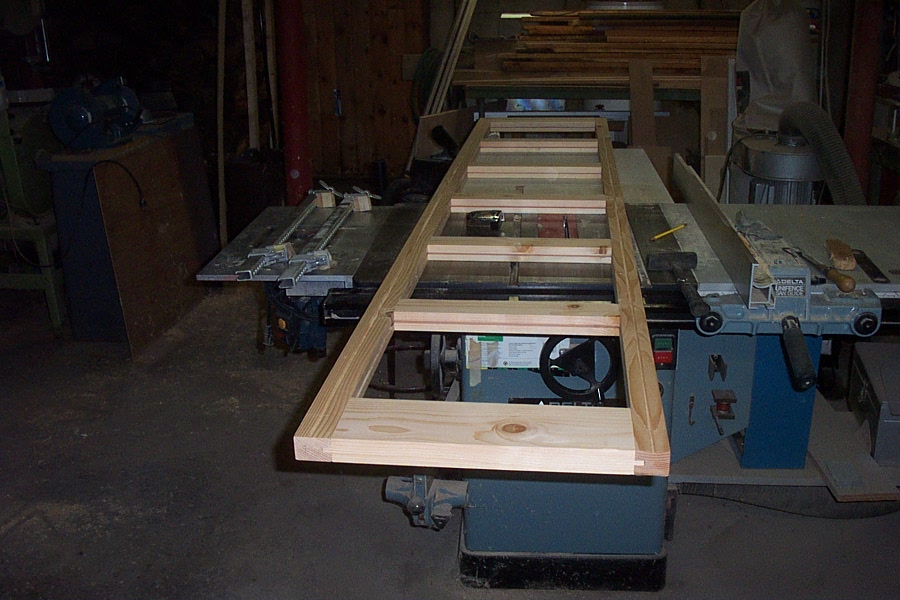

Good Afternoon Guys,
I thought everyone would get a kick out of my boredom, and not wanting to be outside when its 90 degs ! ;)

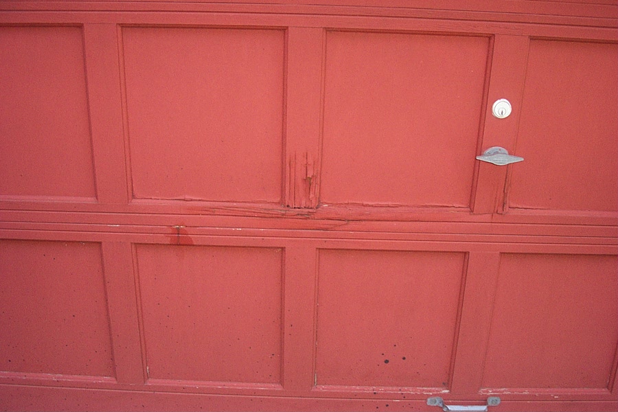

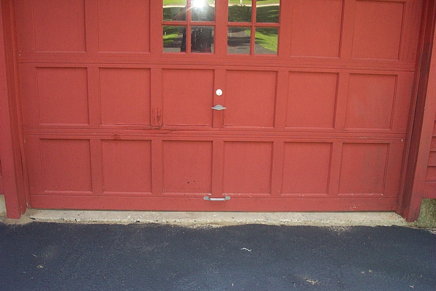

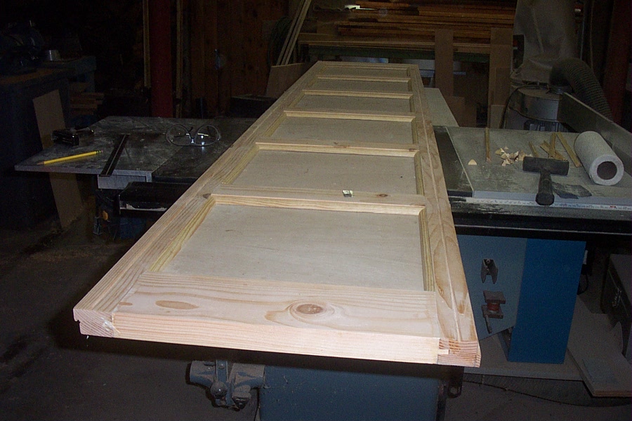

Sometime ago the second panel on my garage door started to rot out, probablly because my old dog would sometomes pee on the inside of the door when I had him in the garage ! :rolleyes:
I called Overhead Door and they came out only to let me know that they didnt make a 6 panel replacement panel anymore ! :mad:
So this morning I headed down to HD and bought some materials to get started on this small project !

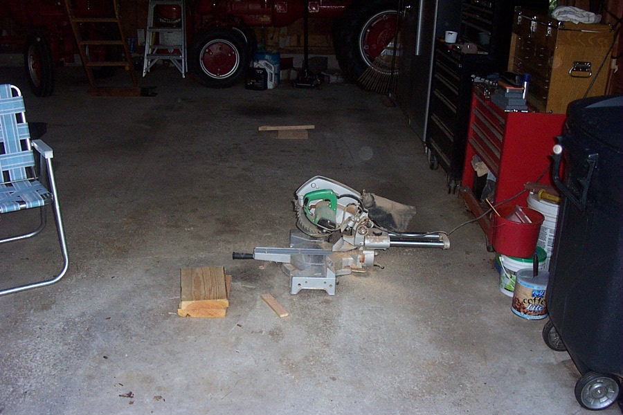

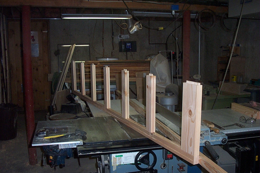

I bought Douglas Fir, 2x8 x 10'. Of course as you know that stuff is 1 1/2" thk. so we had to plane it down to 1 3/8".
I cut the boards on my chop saw to 9 ft, and then brought them down to my shop for further work. This is what I got done this afternoon.
I have the assembly dry fitted, and still need to make the panels, and cut up all the 1/4 rd stock to trim the panels out. I kind of ran out of steam at about 4:30 ! :)

That looks like a lot of work, Scotty. Wouldn't it have been just about as cheap and a lot less work to just replace the door with a metal door? I've helped put up both wooden and metal doors, and hope I never have to mess with a wooden one again.:rolleyes:

Bird, the problem with metal is that it wouldnt fit the character of the house very well. The house is a 3 bedroom colonial saltbox and metal just doesnt look right to me . ;)
Anyways, Im kind of thrifty if you know what I mean ! :)

Scott, do you have torsion or extension springs? Be careful if tension is still on the door when you replace the section. 2 people and 2 pair of vice grips works great for holding the upper sections out of your way while you replace the bad one. BTW, the new section looks great. 12 years ago when I was in the business you could have ordered a section like that but you wouldn't have liked the price. I'm looking forward to the progress.

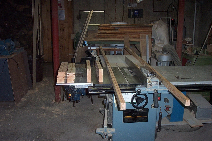

Yes I have torsion springs on both doors, and thanks for bringing that to my attention ! I have Overhead Door openers, so I was thinking I could unfasten that section and slip in the new panel if I can hold down the bottom section some how ! ;):confused::) I was hopeful that I could slightly open the door with the opener and then stop it so I would just have enough room to put the new panel in !
Anyway, today I cut up the six panels fitted them in and glued up the entire assembly. I used that Gorrilla glue, its waterproof, but dont get it on your fingers ! :rolleyes: It doesnt come off easily, and Im thinking I will have to wear it off ! ;)
I let the assembly dry and then just lightly sanded the joints. This afternoon I cut up the 1/4 rd stock and fitted them into the recesses. I have not glued the yet, or finish nailed them, I guess I will do that tommorrow !
Guess thats it for today ! :)

This mornin I glued and finish nailed in my 1/4 rd moulding pieces in. I took the panel up to the garage and put one coat of stain on it. Tommorrow I have to drive the oil truck so I probablly wont install the panel until saturday.
One thing I might point out is that when Overhead Door manufactured these panels, they used large shaper cutters for the rails and stiles, rather than the tongue and groove I used, this way they didnt have to make moulding pieces. That shaper set is quite expensive but the way to go for production !
