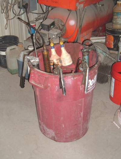

Lenny,
I have posted this pic before BUT time to post again. Dump the expensive grease cartridges, which never really empty out, and move to a foot operated grease pump with 6 foot whip and locking grease nipple attachment. No power needed, 1-2 pumps per grease nipple, breaks thru dried up grease in nipples, saves massive amounts of time greasing, and buying bulk grease is much less expensive.
Yet for $219 (Northern Tool price) I can buy a LOT of grease!

I use the AirTec G200 lithium grease. I also use (in the older messy grease guns) Tractor Supply Lithium HD routine variety. I'm no connoisseur of lubricants. Use the Air Tec at the farm and the cheapy stuff at my 2 other locations with less equipment to service.
Thanks JWR and all who contributed to this thread. Because of your help I can look forward to greasing things with my new rig in coat and tie!
I ordered an AirTec manual gun, and have brought the Lock-n-Lube out of exile. Based on ideas I got here, I also made a right-angle adapter and a straight extension, both of which I can connect to the LnL to reach the fittings that were not accessible with the LnL before.
I grew up on a farm. Dad had a pump that fit on 5-gallon pails of grease for filling, and we just accepted that grease guns were messy things. But now I've become sissified and don't like it.
Since I don't use a large volume of grease I went with the Li400.

In time you may have an epiphany moment and think of an adapter, extension, doo-hickey, etc. etc. that reaches that one zerk that is tough to get. I have a small tool bag with gloves, rags, extra full tubes, the Grease Rejuvenator, Kroil, PB Blaster, and a small plastic jar with the 90 degree adapter, grease needle, and several others I have accumulated. All have been rigged to adapt to the LnL. Grab the bag and the Dewalt and I can get them all on anything I have run into, (so far). I still need a longer hose on the Dewalt tho.

With manual grease guns, to change cartridges and not get an effing air lock happening:
- Lock back the t-handle/plunger;
- Unscrew the cylinder;
- drop out expired cartridge and insert a new one; screw the cylinder back in BUT NOT ALL THE WAY- leave several turns yet; send the t-handle/plunger back into the cylinder and push it down; finish threading the cylinder. DONE!
I've got a 20v DeWalt grease gun (after battling with manual and air-powered grease guns) and have found it to be the best at ambling all over the place to grease stuff. I carry a pair of pliers to rock and twist the tip off of zerks when stuck (only real pain/complaint I now have).
