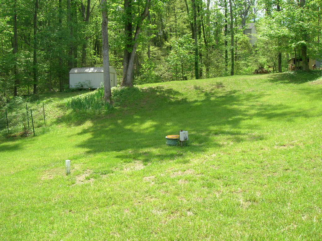

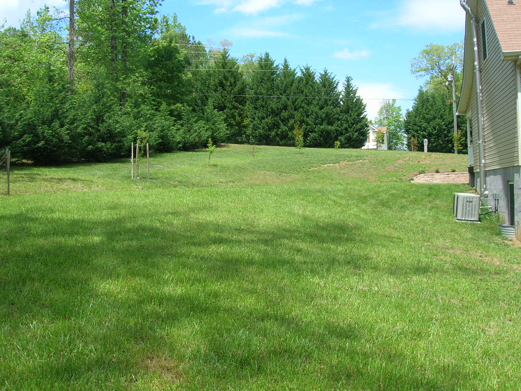

My whole property is pretty hilly. Nothing but swales and ravines. One hill that I cut drops 6 feet over a 15 foot distance. Even going straight up and down is a bit frightening.
