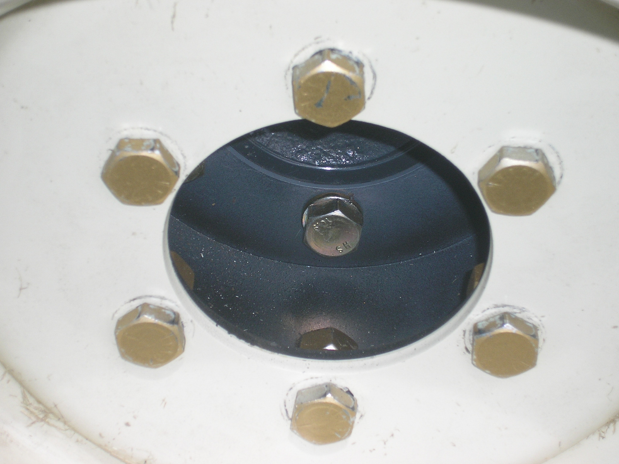

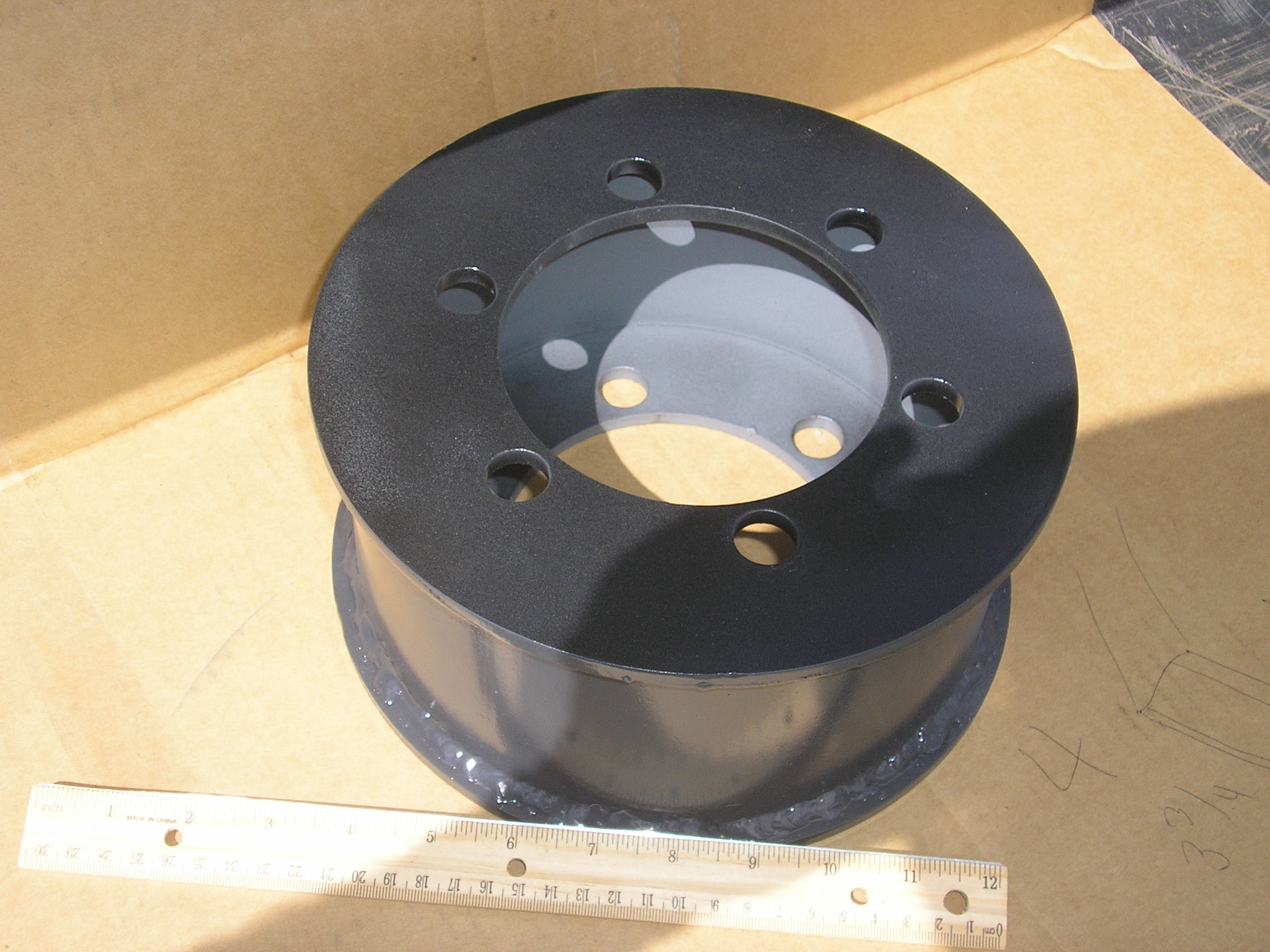

If you don't find what you are looking for, or the width isn't to your liking, I made these for less than a hundred bucks, including the machine shop cutting out the steel plate for me. Wheel gives you the pattern, plate was シ" and extension was 8" steel pipe cut to the length that would give me the maximum wheel width to fit the tires inside my 5' shredder. Made a lot of difference in stability.
