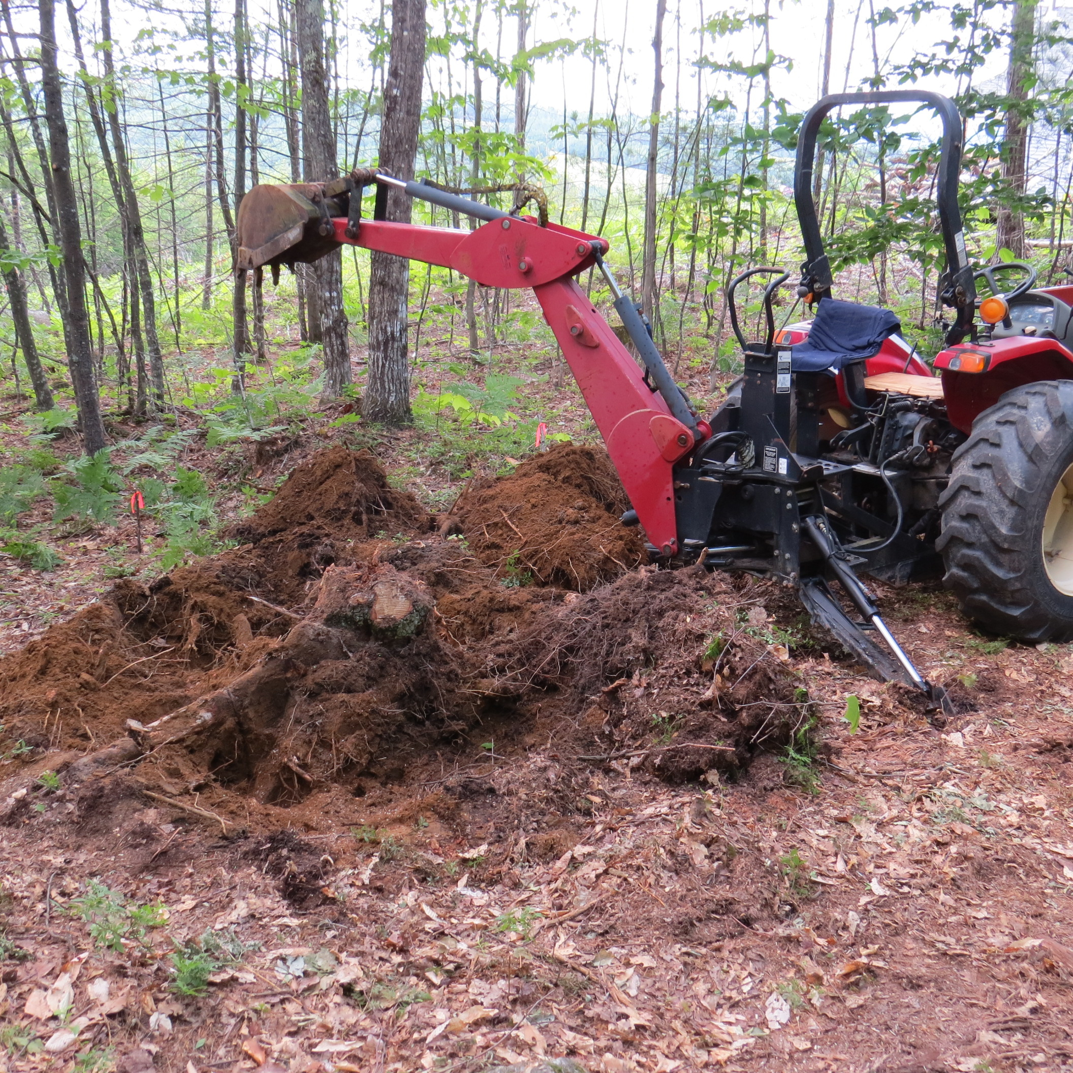

I have a 4720 and I moved my wheels out as far as they go. I live on 13 acres and there isn't much flat ground, (although the locals still call me a flatlander). I have wondered if it's harder on wheel bearings the wider you go but I would bet most homeowner users will never see a difference.
The only other thing I can think of is I could have used a 6' box blade before but now I'm looking for a 7 footer.

First picture is a better look at how far out my tires are.
I do hit lots of rocks Bob and it is very organic. Probably mostly leaves. And you don't have to go down very far, 2 or 3 feet and you'll hit ledge.

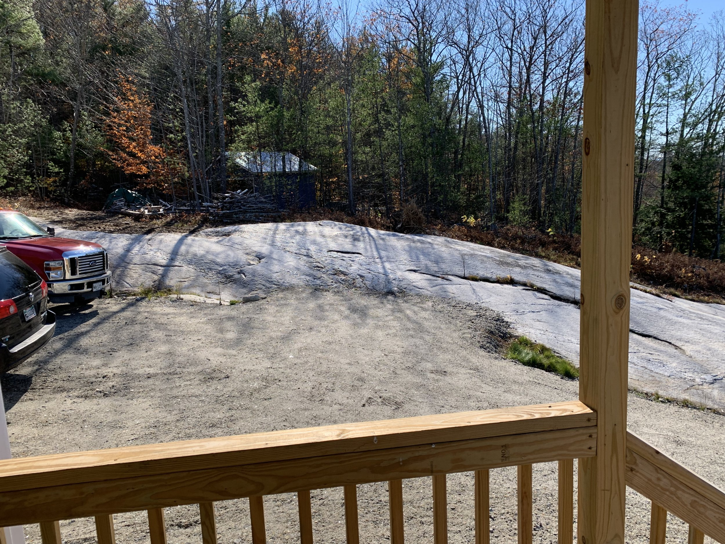

The second picture I'm on our front porch looking towards my new barn and you can see the ledge.
We built our house last year and they had to blast to make the foundation or the house would have been too tall. You can see the hills I have to deal with. Definitely have the ROPS up and my seatbelt on.

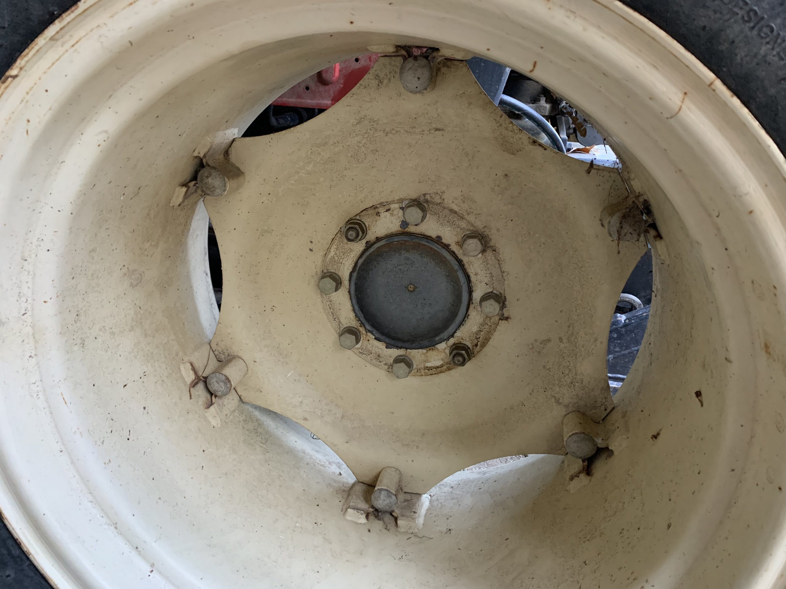

Here's my wheel. I was looking at a new TYM that was pretty cheap and one thing I noticed was it didn't have adjustable wheels so it must have been the "economy" model.
I forget what they're really called but by separating the rim, part that touches the tire, 6 bolts, from the center disk, 8 bolts to the hub, you have many combinations by reversing or moving the center disk to either side of the 6 bolt lugs. You may have to switch sides if you turn the rims around so the tires are rotating in the right direction.

Unfortunately, mine doesn't have the 2-piece rims. Specifications in my manual only show the dimensional data for the 2-piece like yours.

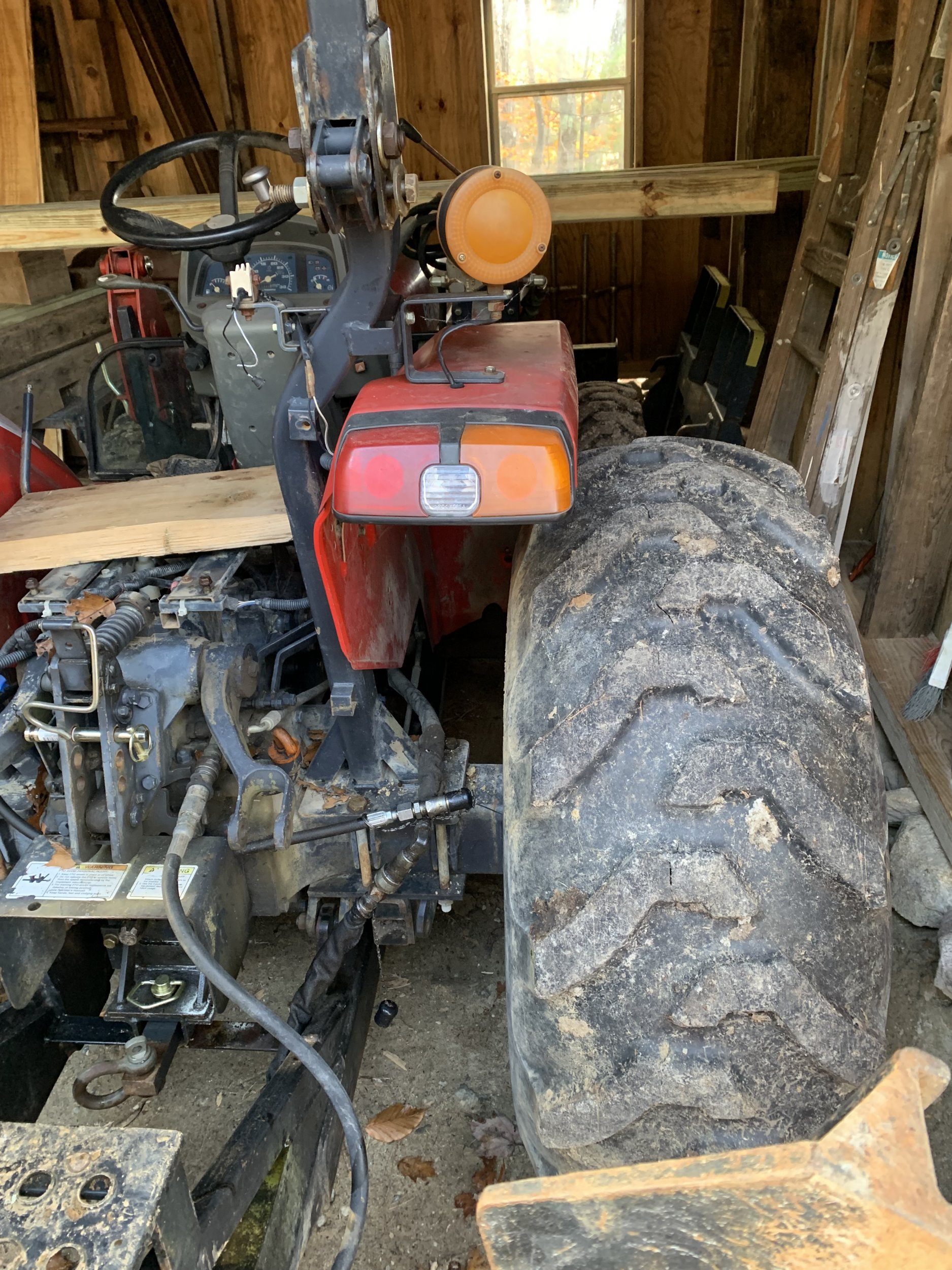

I just saw the TYM ad again and attached a pic of the one piece non-adjustable wheel for posterity.

Typically with R4 tires, they only offered fixed rims.
With R1 tires, the rear rims were adjustable and with R1 Radials, both front and rear rims are adjustable, although the later is more common in Europe.
