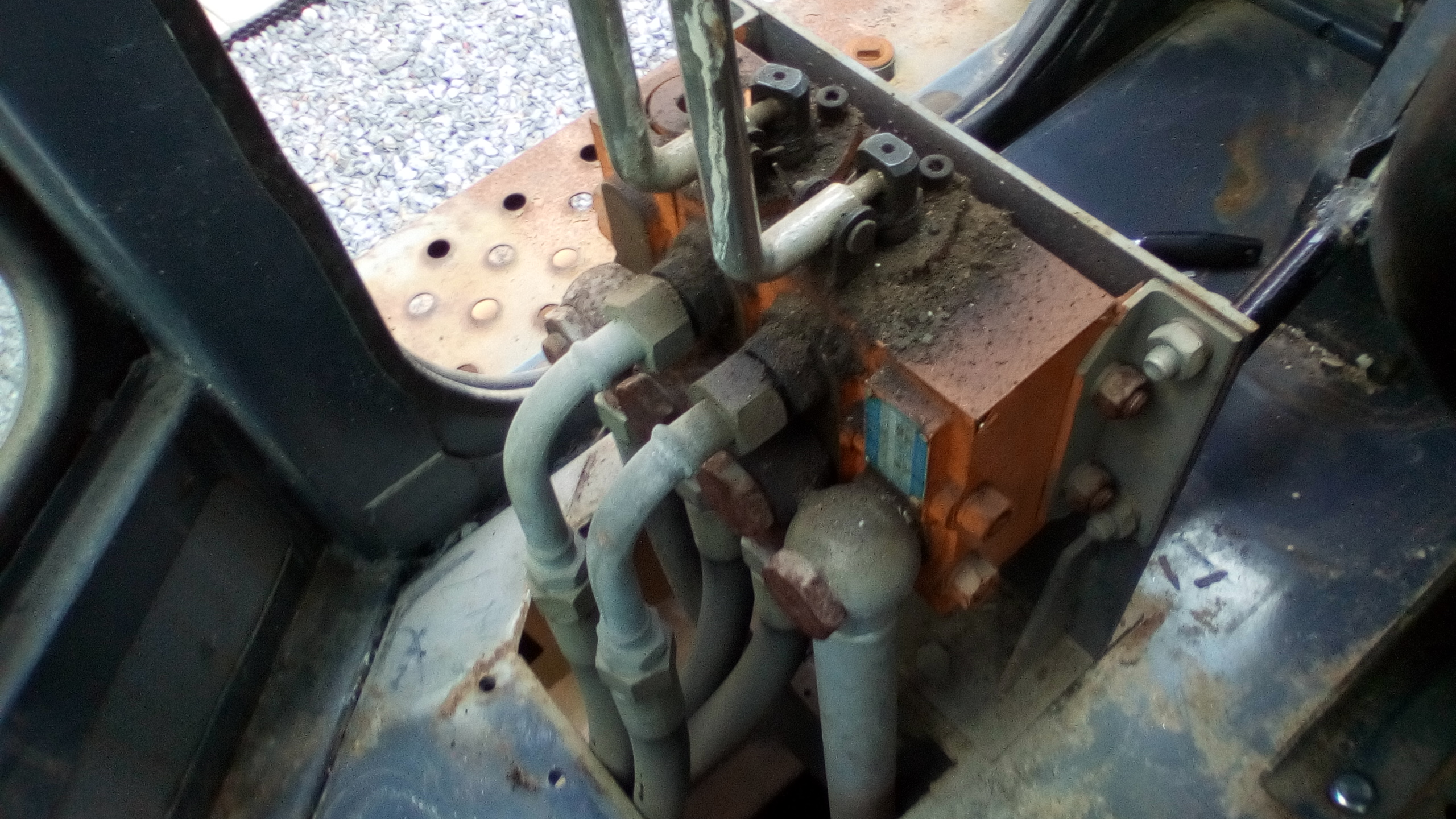

Now I removed the cover from the valves and took some pictures:
IMG_20170728_151657.jpgIMG_20170728_151805.jpgIMG_20170728_152122.jpgIMG_20170728_152132.jpg

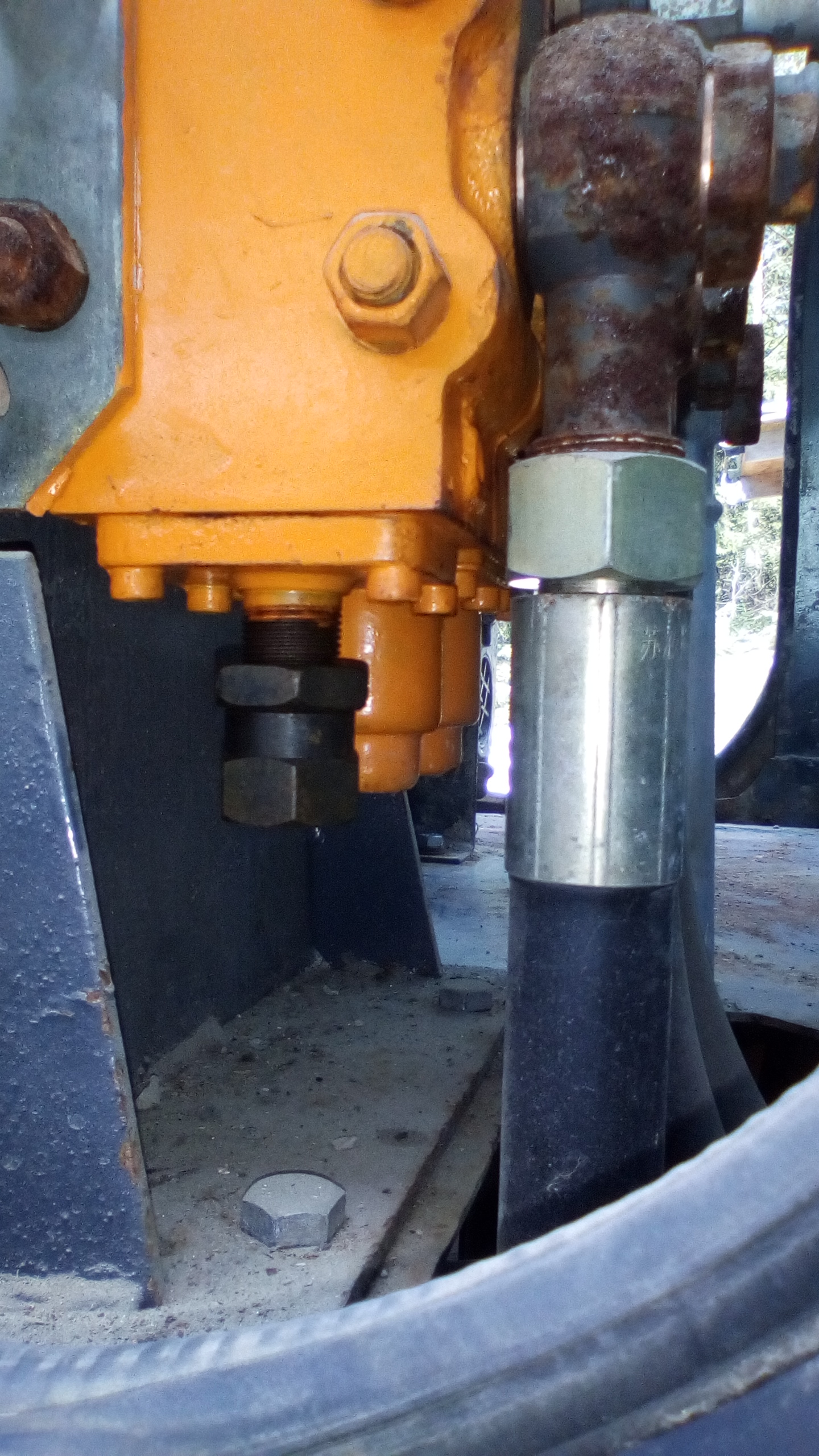

So, i went bananas with the chinese machine and tried some more with the lift/tilt. With the tilt I can fether but the range with the lever is very tight although the lever itself moves a lot before reaching the fethering spot so to speak. The "lift" is a bit worse, I move the lever, more, more, more, and next thing it starts hissing and the next thing it takes off. I can find a spot where it moves little but it is raising in steps, not slowly and controlled.
Maybe I can take the valve apart and change springs or something? And, does anyone know what the screw in the last picture is for?
/ wheel loader lift high speed only #12
The black hex adjustment at the bottom of the valve must be for the pressure relief.
Possibly the valve could be made to meter smoothly by machining just the right place on the spool. It's a matter of the grooves on the spool lining up with the ports in the valve casting at just the right place. It could easily ruin the valve if not done correctly though.

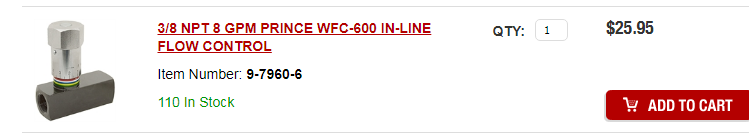

You could install an adjustable flow control valve in boom hose circuit. I did just yrs back that on a Kubota frt end loader for handling large rd bales.
/ wheel loader lift high speed only #18
I also did that on a homemade loader on a garden tractor. Made a big difference in how much control I had of the machine.
#19
Thanks for that tip, I think I will do that. Seems simple enough.
