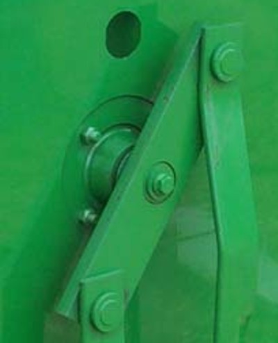

<font color=blue>...How do you change a blade?...</font color=blue>
Well, see that access hole in the rotary deck... if you have real small tiny fingers and hands and you're real strong.... /w3tcompact/icons/tongue.gif/w3tcompact/icons/wink.gif
or insert a 1 11/16 socket through that access hole - attached to a long lever with a little muscle... /w3tcompact/icons/smile.gif

Thanks again John. Your pictures are worth a thousand words.
