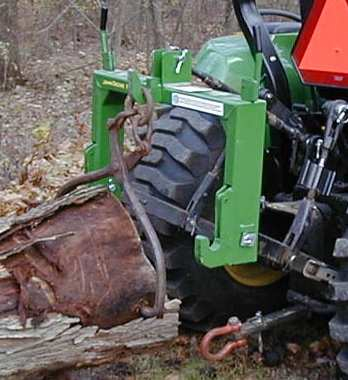

The commercial models that are different but same purpose are called a logging or skidding arch.

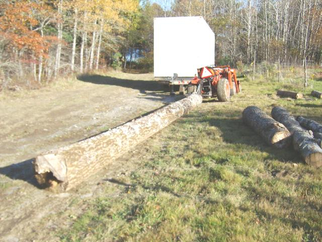

Well, it was a fun project, but it remains unused. By removing the bucket and just using the loader frame to lift the logs, they're all relocated. I did make sure I had plenty of weight on the 3 point to off-set the massive load on the loader. Well, maybe 900 lbs? Don't know. The rear end was light enough that 4 wheel drive was required, but I expected that.
