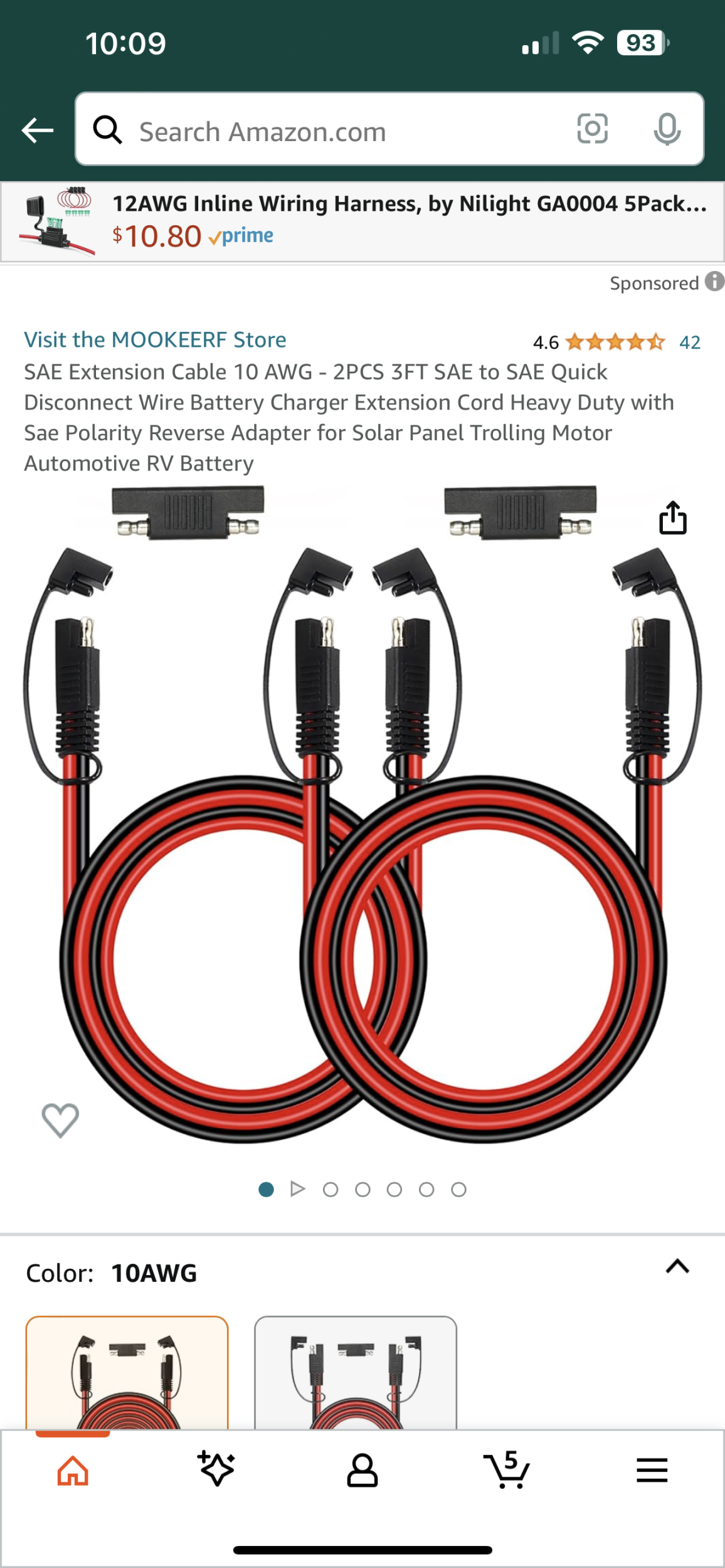

There are a bunch of other SAE ACCESSORIES as well as most battery tenders plug into them as well
