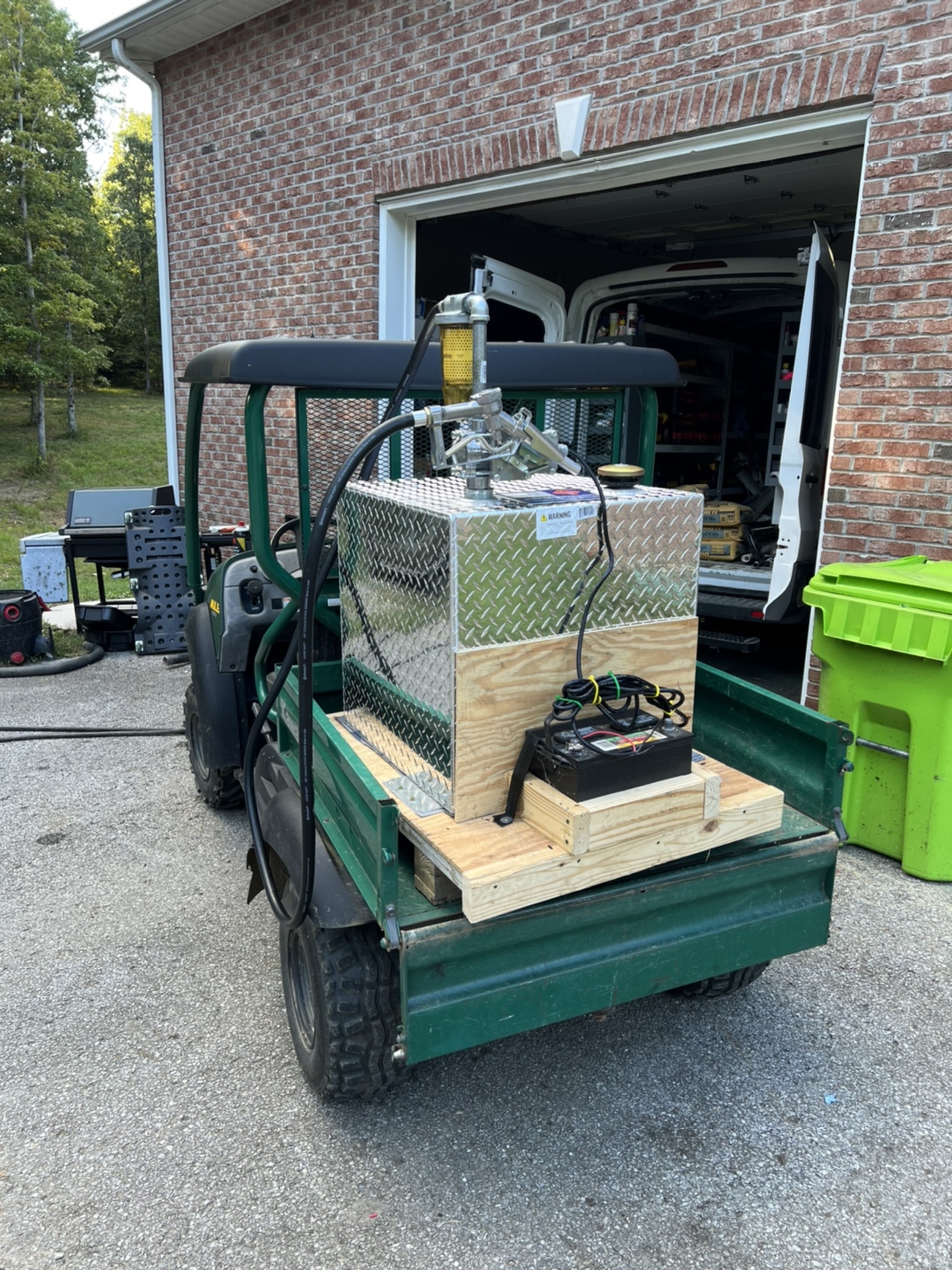

Thanks. The nice thing about these racing terminals is that I have them wired straight to the battery so in the event I need to jump the tractor off I have the terminals there to do it without lifting the hood.

I have a 100 Gal tank that I use for my tractor. I just use a spare battery and charge it when it gets low.

I put a battery on my tank. I considered using some alligator clips and hooking it it to what I was fueling but I figured I would get annoyed with those. The battery last a long time and it wasn’t even a good battery. I pumped 150 gallons with it and it really hadn’t slowed down I just charged it when I had the opportunity.

In the OPs case since it's 20 feet from ac power it's a no-brainer to simply go with an ac pump. 12V you have a battery to replace and maintain. Also I'd look at manual crank pumps which are inexpensive and don't need power at all except a little muscle!

A 120 volt pump would be the direction that I'd head in. And if your 12 volt pump is any good at all you can sell it to a contractor or excavation company.

Battery quick disconnect can put it where you want just put a 100 amp circuit breaker for safety

I got an old battery charger with 2-10a selection, cut the leads off and wired it to my 12v pump. Set it to 10a 12v and always on. Plugged it in and it works great.

As long as you have ac power available. But then you wouldn't need a 12 volt pump

My fueling station is parked in the shop, it's a 55gal drum. Tractors and mowers go to it. But I suspect if I didn't have 110v I could just run it off the tractor that's carrying it. Trailer harness would be sufficient for a quick disconnect.
I bought a 12v pump because 110v was cheaper, and 12v is easier to find. I can run it from vehicle or with a 12v power supply. If I have a 110v pump, I'd need an inverter to convert 12v to 110v.
