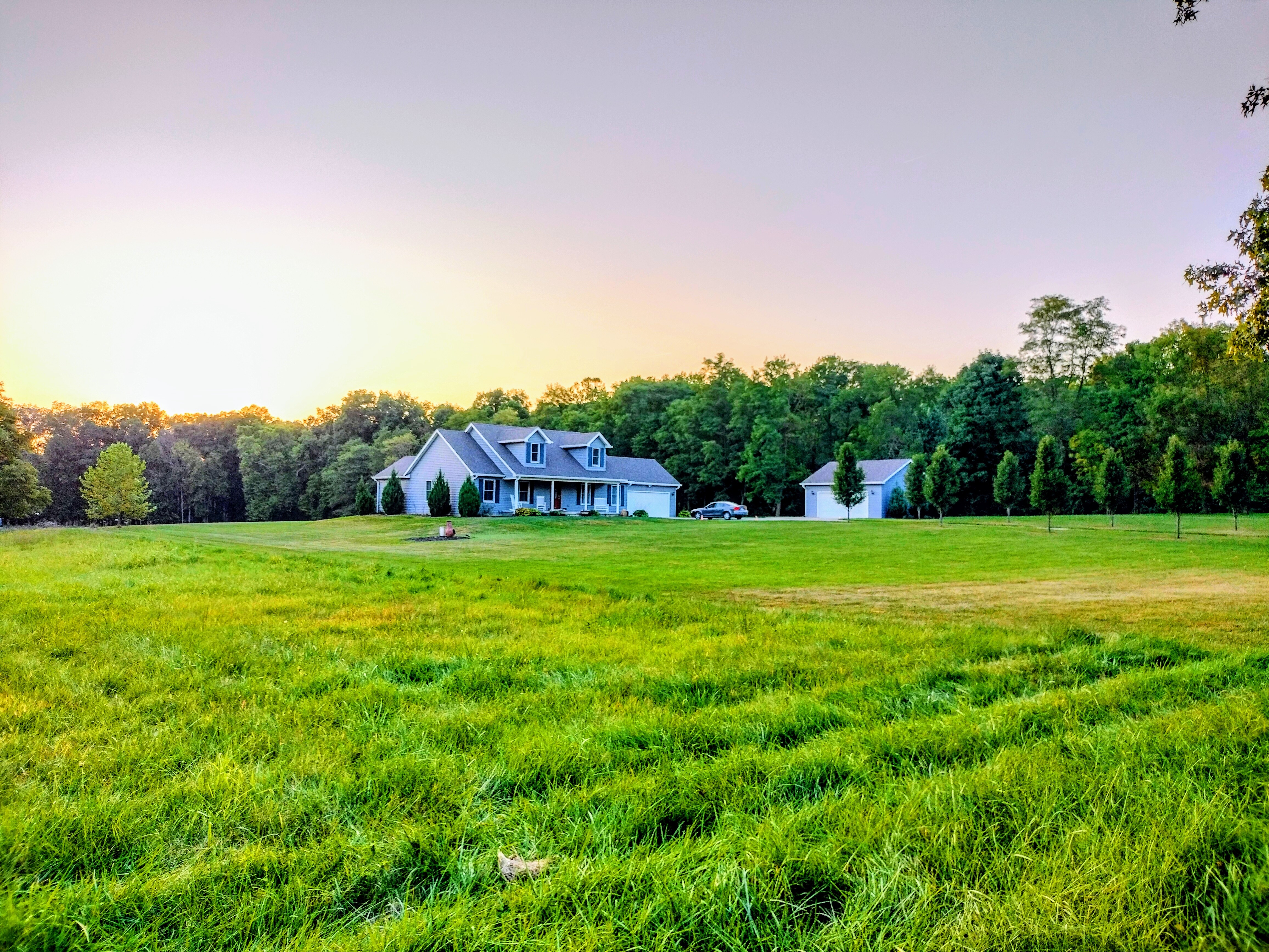

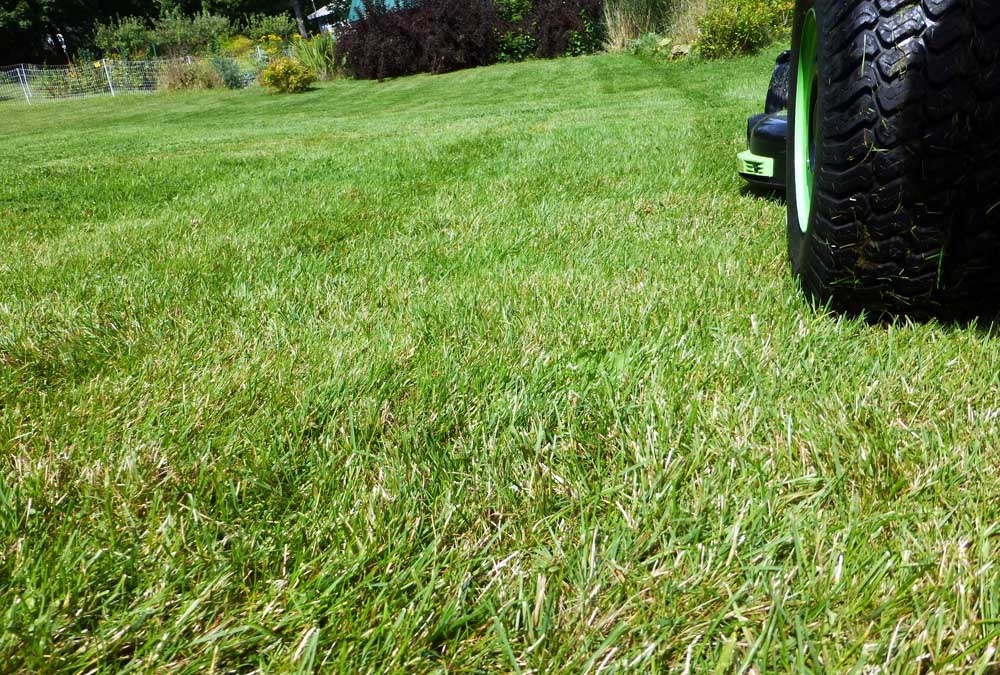

We'll be away for a long weekend so I took some mowing photos for you guys.

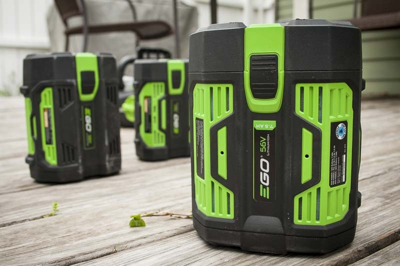

The OEM batteries are suppose to be quite good and the reason they as so expensive. My battery nerd freind said he took a one apart to see what parts they had used and told me this. Nonetheless, as long as replacements, or OEM ones are being built, I'll be happy to get 5+ years use with them.
Many on YouTube and elsewhere have been taking EGo batteries apart. There are many thousands of them out there so there have to be a few which have failed and somehow didn't meet the warranty conditions. Didn't register? Commercial use? Or "what the heck I want to cut it open."
IIRC EGo is using 18650 cells, which are plentiful, with lots of high quality options to rebuild the battery pack.
Got time to kill, go get lost at 18650 Battery Store - Trusted Supplier of Lithium Ion Batteries

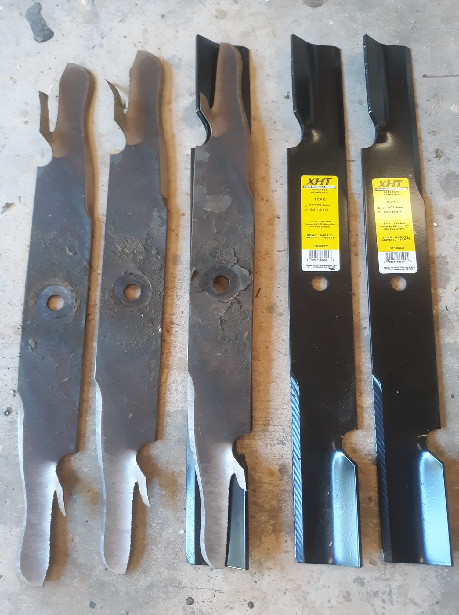

Blades last me maybe a decade?
How big of an area are you mowing? What type of grass do you have?
I'm mowing bahia and bermuda grass, plus a variety of weeds. I'm mowing about two acres a week, but sometimes I don't have the time, and I might skip some areas.
I start off the year with last years blades because I'm mostly mowing weeds when Spring hits. Then I put a new set on in May that will last till July, then I'll finish off the year with those blades and use them for weeds in the Spring.
I buy two sets of blades every year.
3 blades, 61 inch cut, on a 26 HP Scag Wildcat zero turn.
The middle of the picture shows how much metal is worn away on an old blade by sitting on top of a brand new blade after a couple months of mowing.
