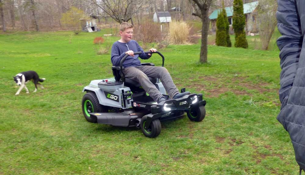

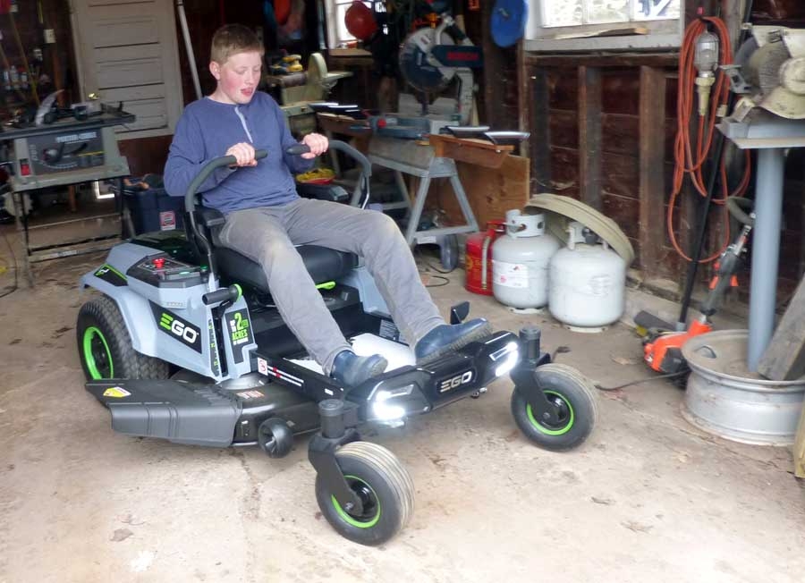

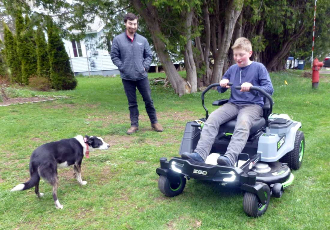

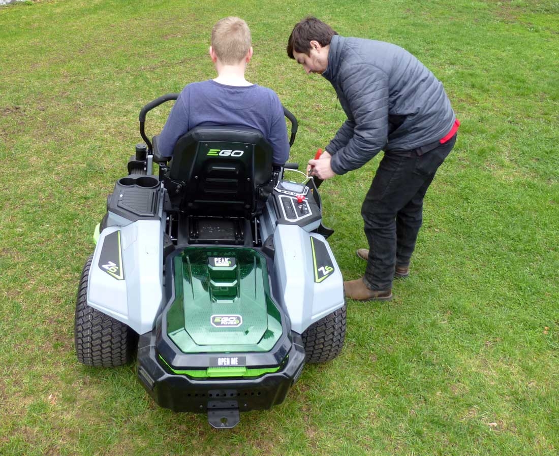

We just received a zero turn mower yesterday as seen in these pics. I operated it for 20ft while this young fellow did for 1/2 an hour in practice since the grass has minimal growth.. We have ill elderly parents and leaving town for an undetermined amount of time and Andrew will be in charge of mowing while we are away. He needed this practice time. He LOVED it :giggle:! Note the determined tongue out in the lowest photo.

Is Andrew a neighbors kid? It's wonderful you've got someone you can rely on to take care of the place while you're out, and that you've invited him to be a part of the process.
Now, obviously the kid is going to enjoy anything he can operate, it's all new and fun; what is YOUR opinion on it thus far? I see you went with the bars over the wheel, any particular reason why?
Congratulations on the new mower, and it's great to see you've got someone you can trust to take care of the place while you and the missus are out taking care of her parents.
/ Whatever you feel like thread.
That is the 13yo who lives just down the street and helps often. The kids are home schooled and mom struggles to get him to do his homework, but when he needs to go do something like mowing, its done ASAP! :ROFLMAO:
I didn't like the reversing setup on the one with a steering wheel. May have been fine but I liked "tried and true" setup. He did struggle in the backing up process. Will I? :eek:

The controls have three settings, kind of an advantage to the electric motor drive system. I didn't get in on all the conversation but i believe the shop guy left it in the mid sensitivity setting.
