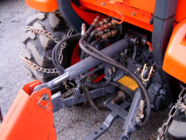

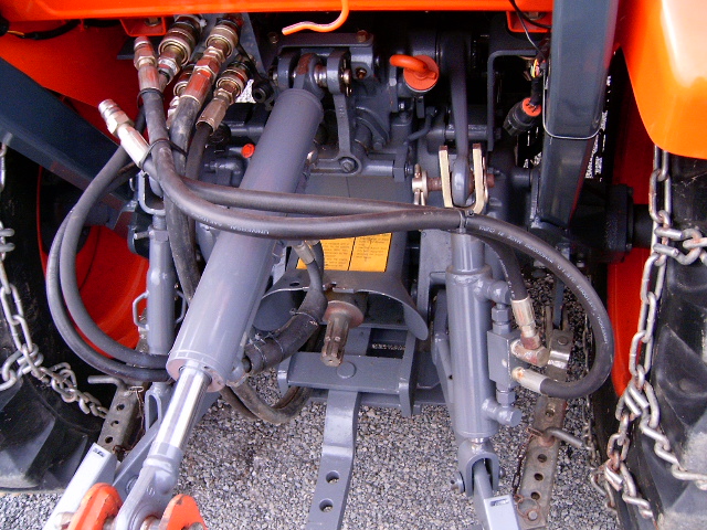

Top n tilt (TNT) is when you replace the factory top link and side link on the 3 point hitch with hydraulic cylinders so you can make adjustments to your attachments while on the fly.
I my pictures the tilt cylinder hoses are disconnected right now. I'm using those ports for my snowplow angle. I need to add another set of remotes for next year.
