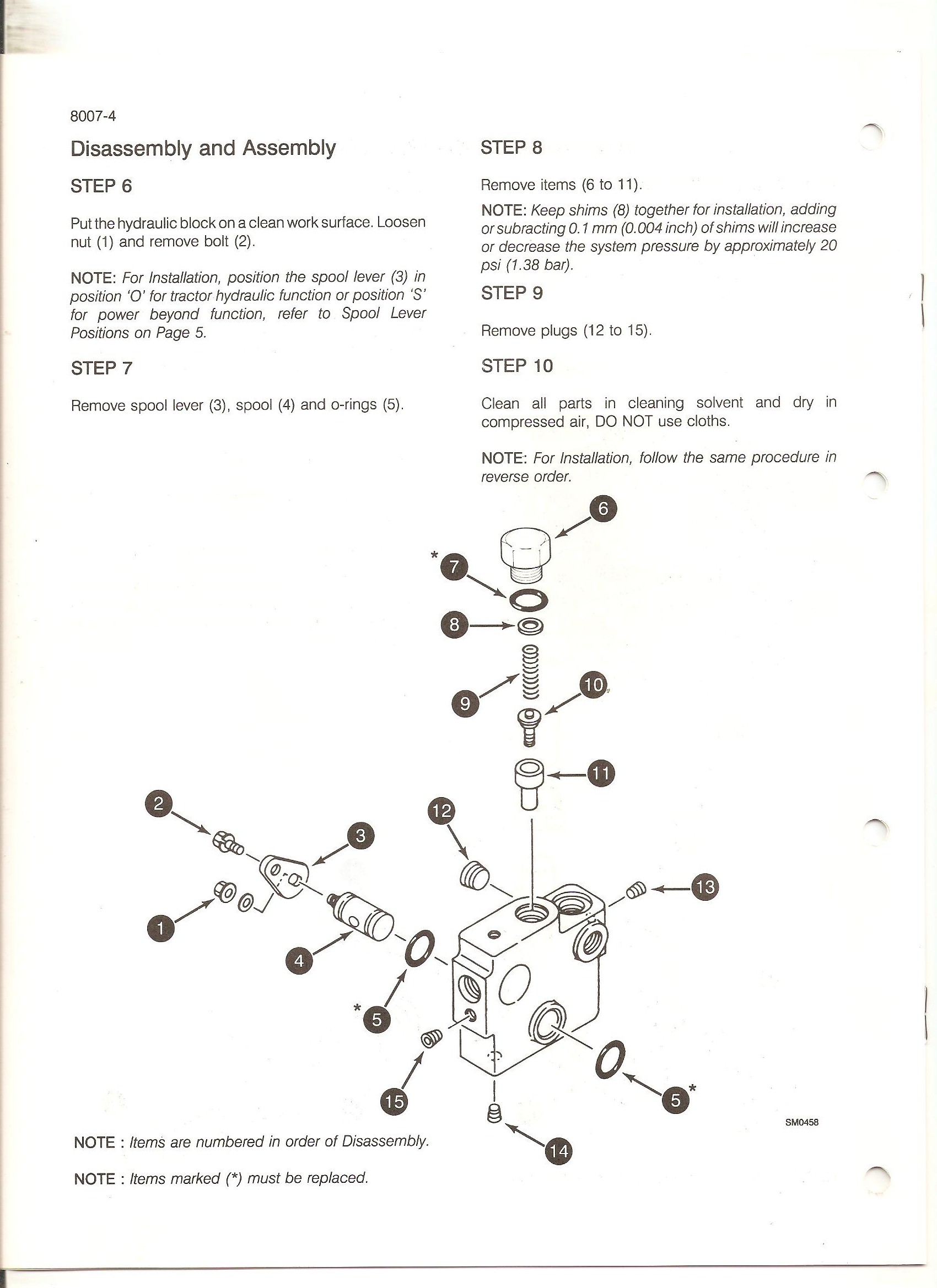

You have to check the power beyond block. (see attached). Remove item 6 carefully as it is under spring pressure and you will have hydraulic fluid come out once removed. check for item 8 (shims). Each shim is .1mm (.004 inch). Item 7 is an O-ring. See step 8, by adding or subtracting shims will increase or decrease the system pressure.
In my case my loader would not pick up its rated capacity. When I took mine apart I found no shims had ever been installed at the factory. I made my own shims from flat washers and installed the equivalent of 6 shims. Reinstall item 6 and top off hydraulic fluid.
I am not responsible for anyone who does this procedure and damages their tractor. I am only stating what I found and did to my own tractor. After my changes I was able to lift a 1300 lb. garage lift off the back of a truck.

Cool I'll have to check that out. When I first got my tractor it seemed to have lots of lifting/breakout power. Then it seemed like it wasn't nearly as good. It doesn't bog the engine down or anything, it just plain won't lift at all with much of a heavy load like wet dirt or a bucket of sand. But the strange thing is if I work the hydrostatic drive pedal while holding "up" on the loader lever, it suddenly gets a quick boost of power. ???
Alos what is the "O" & "S" on the block all about??

George, thanks for this valuable info. I am not aware of the function a shim plays. And, I am not about to go through the procedure you did. I believe my block must have been correctly assembled. Using my pin on loader forks, I was able to unload 13, 90lb sacks of redicrete from a flat bed truck at 6'. Including the substantial pallet, I estimate the load to have been about 1200 lb. I had my Bush Hog on the back for ballast, and was praying my tractor would come through a tough assignment.
Just make sure your loads are concentrated toward the pins. I had to restack the sacks of redimix before I could lift the load.

Be careful playing with the relief valve shims. If you do, you should have a hydraulic guage that will plug into one of the loader quick couplings, and I would definately not go over 2500 to 2600 PSI.

Just a note to those who replied to the post on my loader lift modification. It never seemed to lift to full capacity from the day I bought it. I'd scoop in a load of gravel or dirt and have to dump almost half before I could lift. I thought that the loader was doing all it could do until 2 years later. A friend bought the same tractor (a 2006, mines a 2004). I was helping him at his place running his tractor and was amazed at how much more his loader would lift than mine. I decided to read through the service manual and check mine by putting weight in the bucket to see what it would lift. It stopped lifting way below the loader specs which led me to check the shims. That's when I found out the factory forgot to put any in mine. System pressure was way lower than it should have been. I did use a high pressure gauge (0-5000PSI) when I added my shims.
