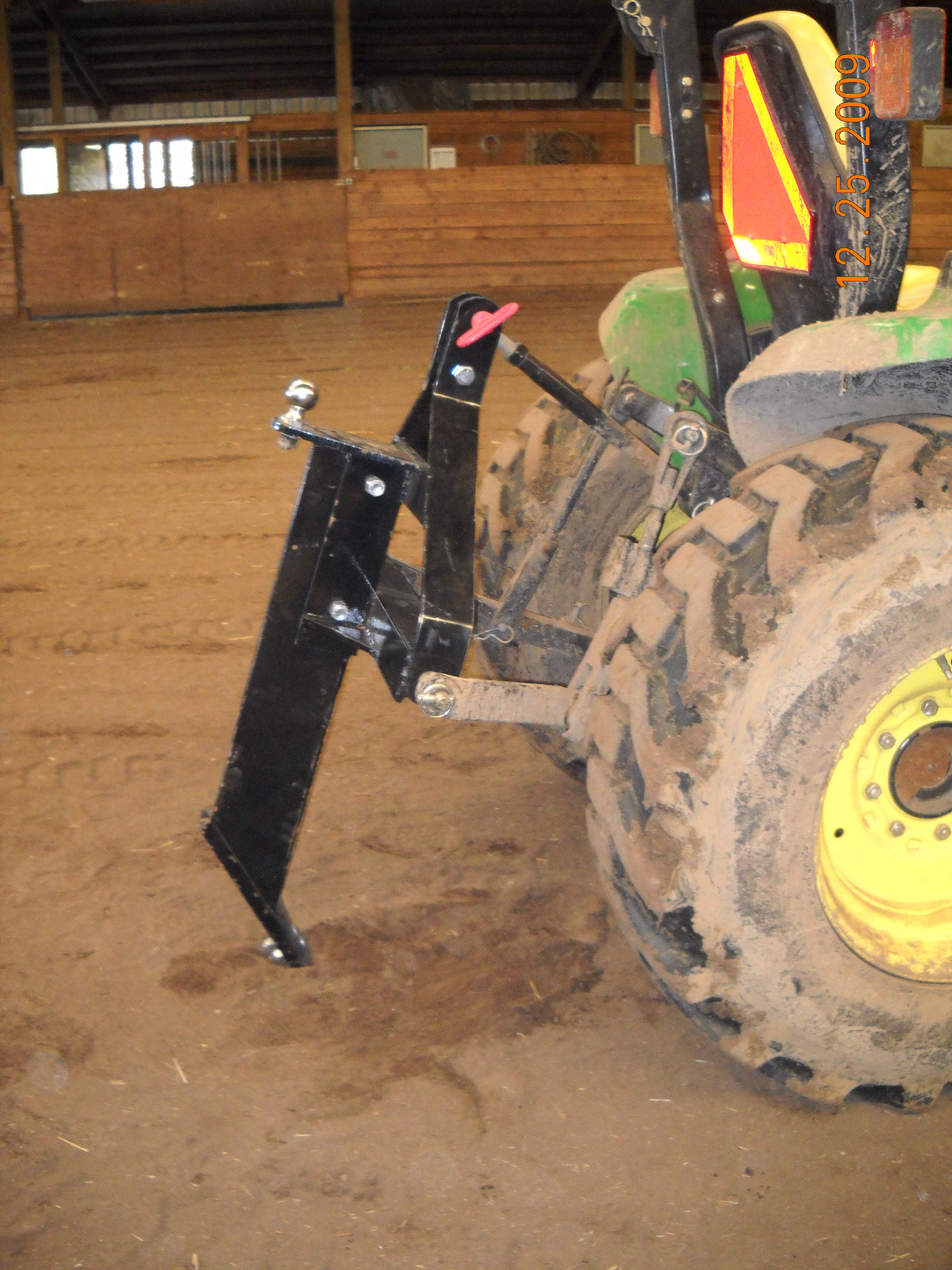

My middle buster is half middle buster, half subsoiler. I use the subsoiler to dig up the area then used the middle busters furrower to clean out the trench or ditch. this gets it deep enough and wide enough to work in. I got my middle buster from General Implement. the cool thing is that it has a hole on top of it for a trailer ball so I can take the cultivator shank completly off and move trailers around. Very useful piece of equipment.

What is the deepest trench you can dig with that setup?
/ What would this be called? #15
It can dig up to 2 feet deep in softer soils and 1 foot on hard ground. If you added some weights to it, it will dig much better. Mine is so big that my Dad's JohnDeere 3720 can barely get it off the ground with a few inches of clearance. Obviously you would need a smaller one for your Yanmar. I have mostly used mine in gravel and rocky areas and have dug 1-2 feet down. I dug a ditch with it down the side of our driveway to control water run off from the natural spring runing through our property. It worked great for that. And it is also nice for pre tilling areas for a garden.:thumbsup:

G'day we have the same over here but we call them single tyne rippers and most of them have a pipe laying attachment that will lay 2" poly pipe, the attachment is big enough to allow a joiner to pass through it making it very easy to lay long lengths of pipe in a single pass.
