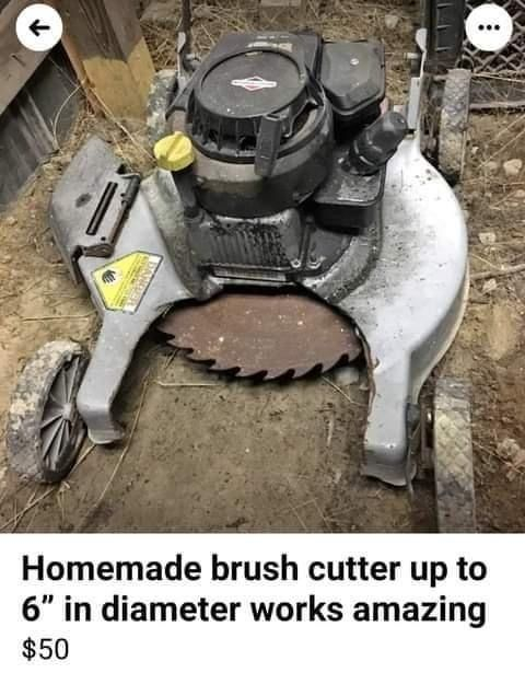

An old neighbor did something very similar. He got tired of grass growing onto the edge of his driveway. So he mounted a saw blade to a horizontal shaft Briggs. It had two wheels on the side of the handle and by raising and lowering the handle it would rock the "trencher" so the blade could do it's job. It worked but boy did it make a mess. With no guards it was also not something you would want to be near. I think that lawn mower idea would work but I would look into a centrifugal clutch and a hand throttle with a spring to return to idle. May even want to put some chains or something dangling down on the sides and rear. Any rocks caught up in what you are cutting would turn into projectiles.

That's it man...where did you find that?...
I think I would turn the starter handle away from the front though...!
This pic was posted in the ”stupid stuff” section on an Georgia based outdoor forum I‘m a member of. Looks exceedingly dangerous to me!

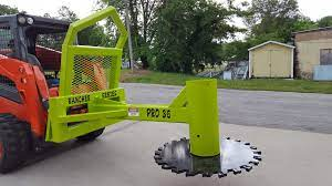

You mean like this?
