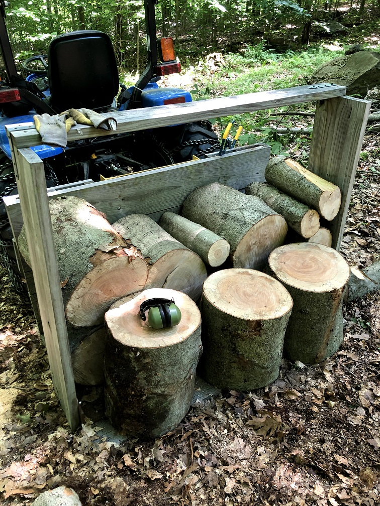

I made a platform using 2x6's (bottom/back) 2x12 (sides) 2x6 (top) using steel angle as a base support for the sides.
I use mine for collecting firewood as well as my FEL bucket. Beacuse both the bucket and the carry-all platform can be lowered to ground level its easier on my back to roll bigger firewood rounds into them. I then raise them to the height of the horzontal splitter so that I can roll the round onto the splitter and not have to pick the large rounds up to get them onto the spliter. The less bending over the happier my back is.

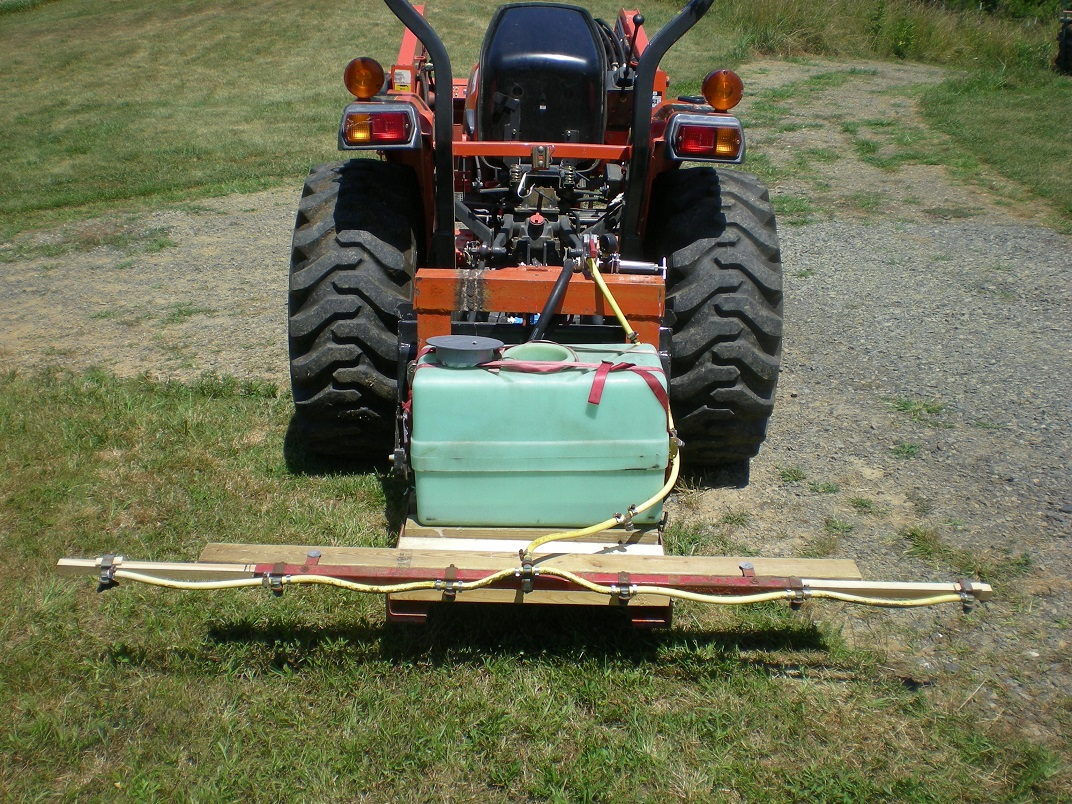

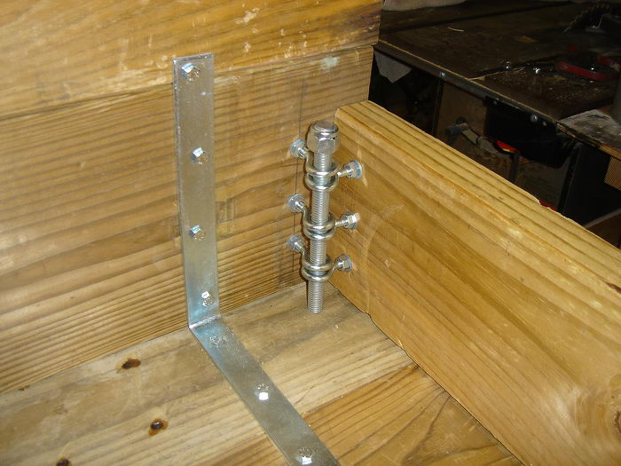

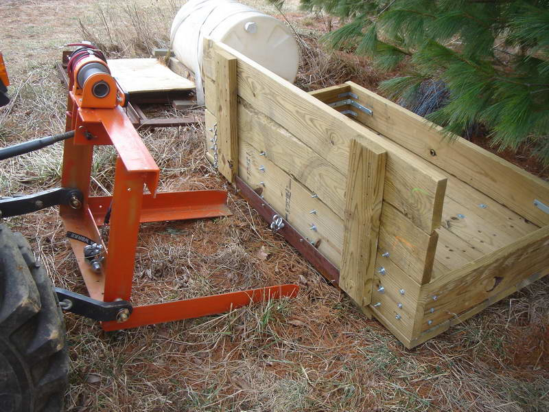

So I made my carry all to do a few things, It carried tools but could also drop them off without unhooking the frame. Originally, I had a winch which would raise up to dump the carry all (moot point when you have a FEL). It has a removable rail that frankly, I don't remember ever taking off...
It also was my counter weight holder.... before I made a dedicated frame for it. It was also the frame that my RoundUp sprayer for the driveway sat on.
My carryall now has 6 wheels under it (sorry no photo) so that when I load it up with firewood, I just drop it off in the basement, drive the tractor away and push the carryall with wood closer to the stairs...

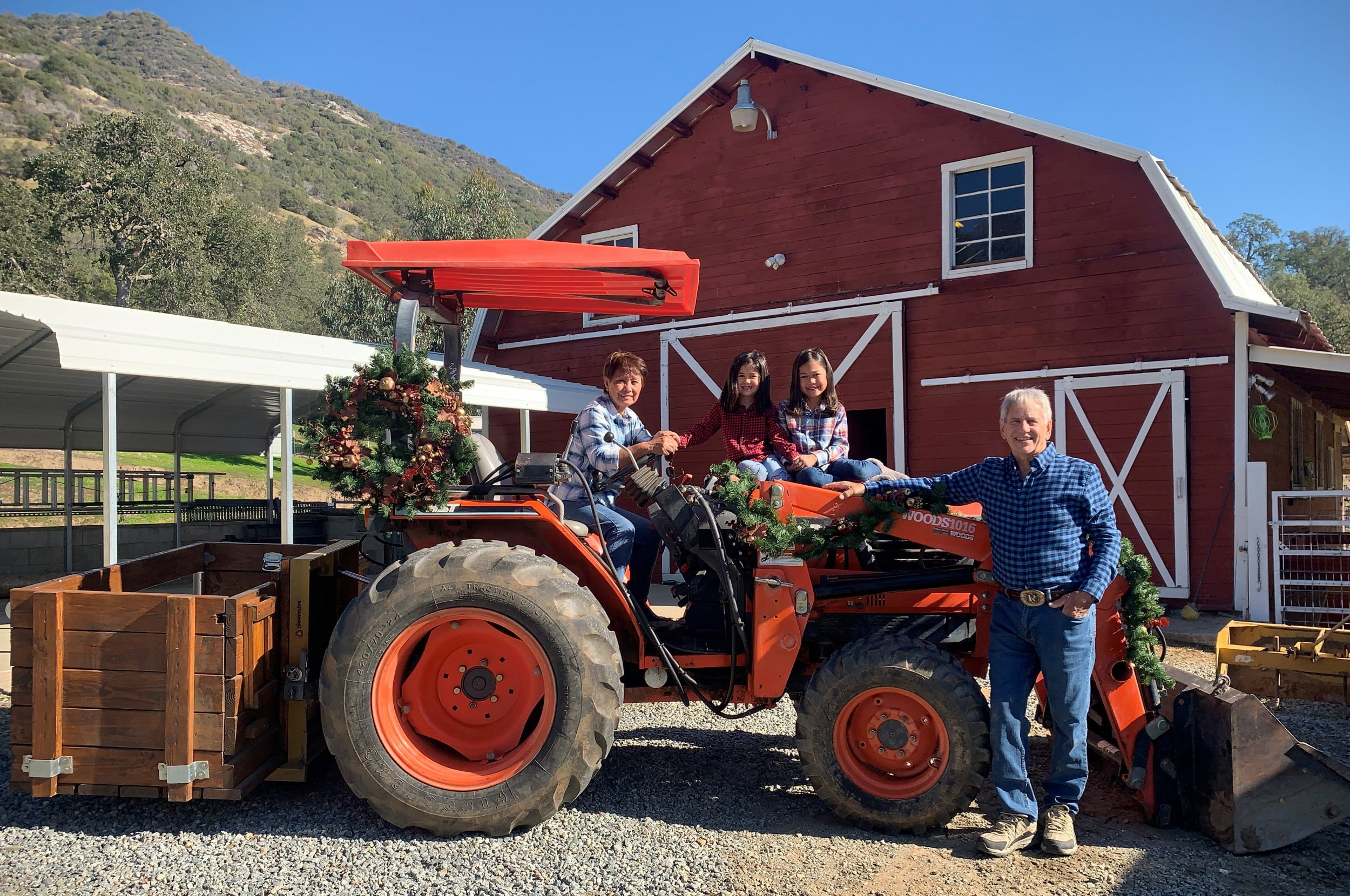

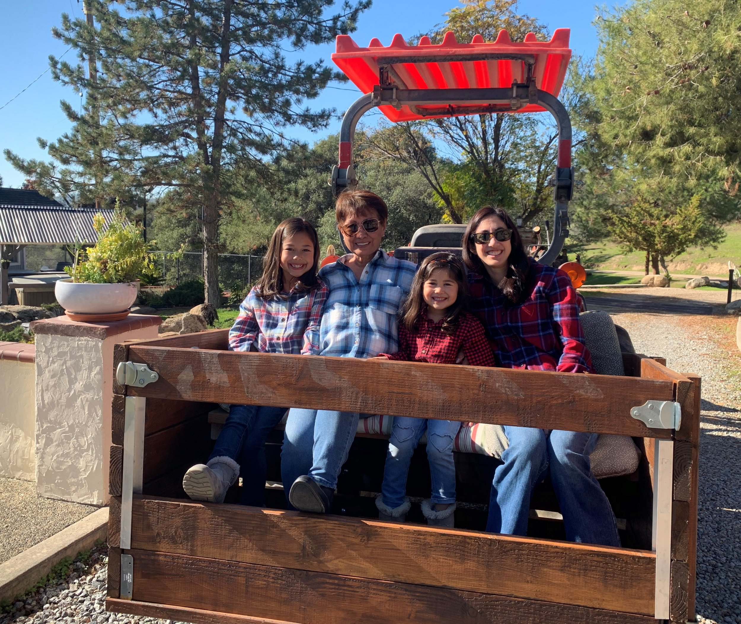

I put a removable bench inside and now have what the family calls my "ranch uber." Other uses - transporting: tools, generator (to where it is needed), hauling wood, gravel, bags of concrete, concrete blocks, and whatever I need to take to where I am working.

Examples of how some have enhanced the basic structure:
HAH! Just what I was thinking. Carry around the family to the picnic spot...or even use it for the picnic!
