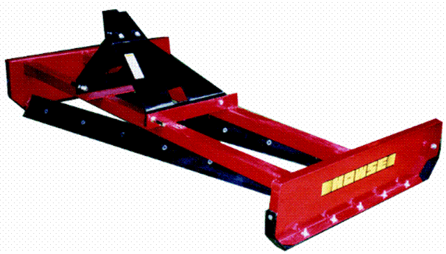

I'm not a big fan of box blades. They are fine for small porjects and a compimise tool for other things. You have a very long driveway and the box blade will just make things worse.
The problem with a box blade is it hangs off the back of the tractor, so if your front tires hit a high spot, the box blade will cut a low spot into your road. Now you have a high spot AND a low spot. Now you have to fix both. If you have a gradual bump or depression, a few passes with the box blade will make them worse.
There are special attachments for maintaining a gravel road. My favororite is the Grade-All
It's set at an agle with two cutting edges. It drags along on the road cutting the high spots and spreading the material to the low spots. It's juts about idiot proof and the results are amazing. When you look at one, you'd think it would be very simple to make, and it might be, but the angles and spacing are critical.
Prices for a grade all will be three times what you pay for a box blade, but witih the right tool, you will have a perfect driveway for all time. With the wront tool, you will ruin your driveway and eventually have to hire somebody to come fix it.

Here's a picture of the attachment I'm talking about. It's not the Grade-All brand, which I can't find on a search, but know it exists cause a friend has one and it's only a year old.
This is the Howse model and they call it a duel edge grader blade.

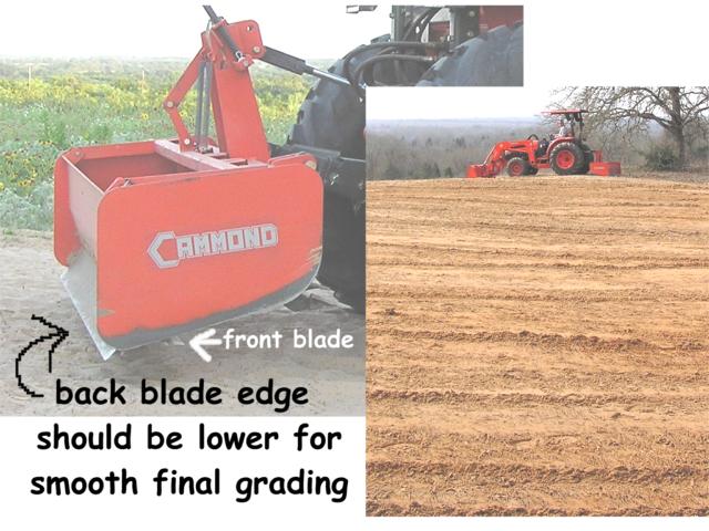

Eddie, the grade-all looks like a neat implement, but...... theres always a but, I find that my dual bade box blade works well..... IF, there's always an if, the front blade is set to 3/4" to 1" above the grade while the rear blade, which is just like the front blade but curving backwards instead of forward, is dragging on the ground. The bumps over 1" will be skimmed off and the rear blade will distribute and press down the excess road material. The end result is a smooth surface.
Since the rear 3 point hitch is floating, in the full down position (on my tractor), when the front of the tractor goes up or down the rear blade which is always in contact with the ground will also go up and down but will be smoothing not cutting deeper because of the tilt (up) of the box blade.
See attachment.
