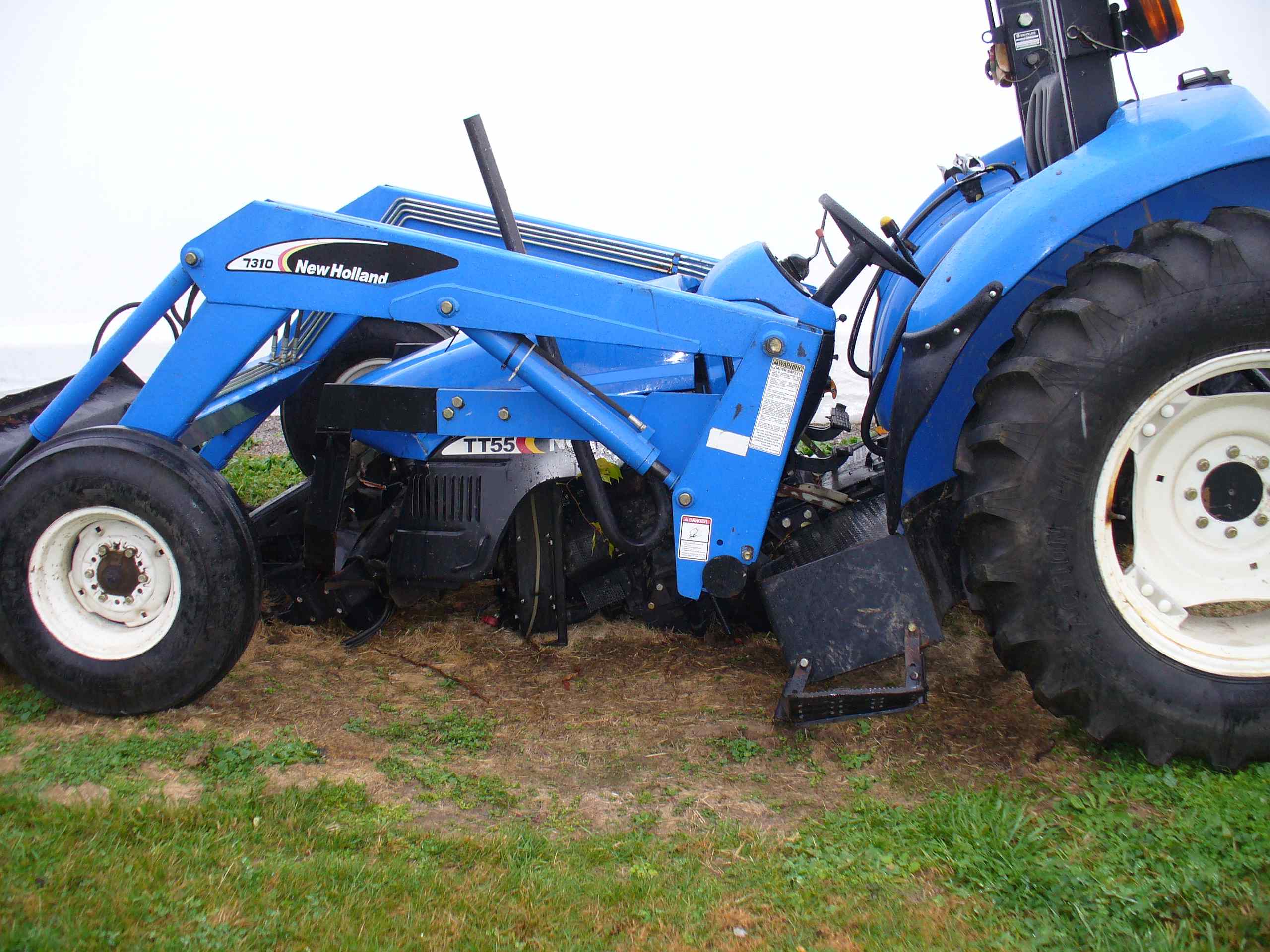

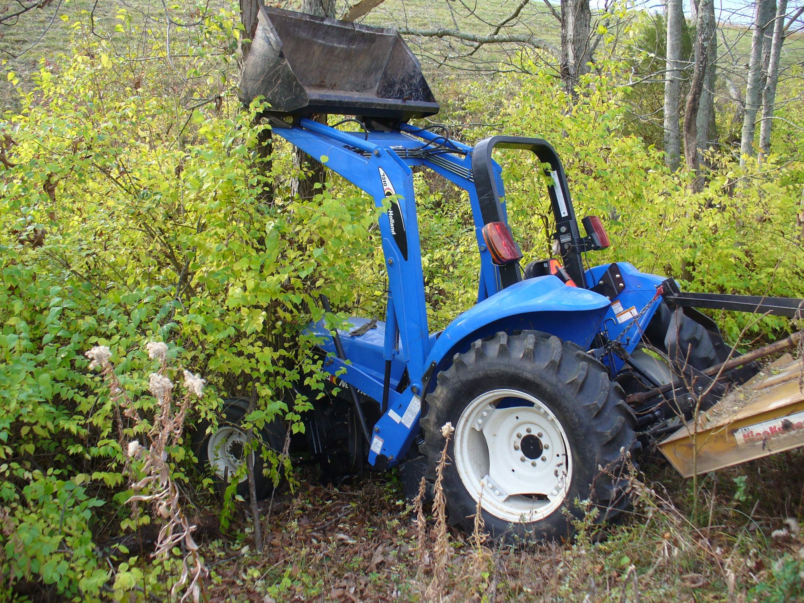

I guess from bouncing down the hill the loader bucket was bouncing too and was up as it hit the tree.
The brakes were always stiff and and seemed like they were glazed. They would grind sometimes about the time the tractor stopped. Not metal on metal but that glazed type of thing.
So, I was coming out of the back field and got off to open a gate. Had my back to the tractor and undoing the chain when something hit my leg and knocked me on my butt. Then the rear tire hit me in the shoulder and pushed me aside.
Watched it go down the hill just wishing it was all a nightmare.
I had set the parking brake but I guess I didn't give it that last click. I know now I should have put my bucket down and should of got the brakes fixed.
So learn from my mistakes and be careful out there.

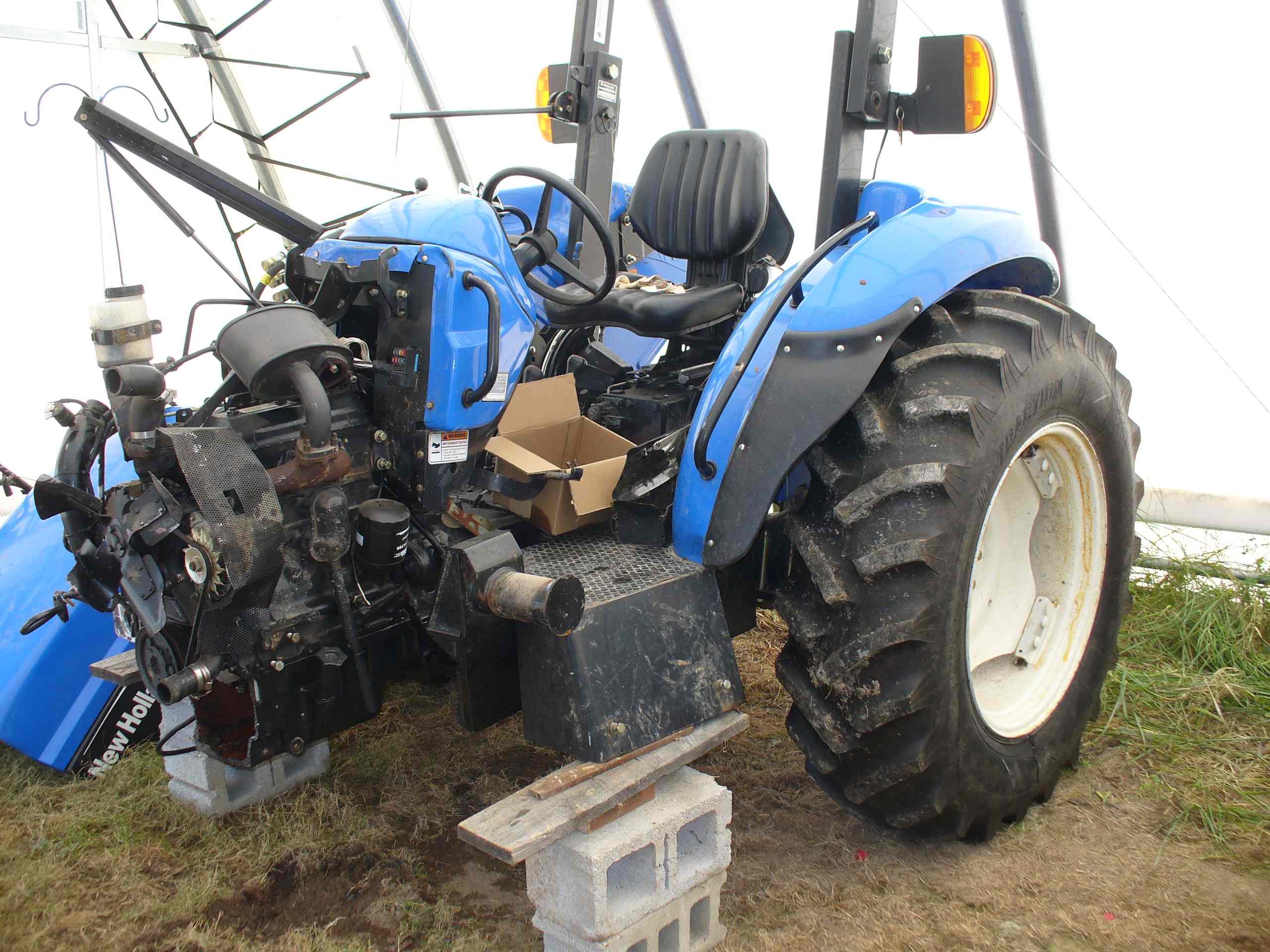

looking at the pic of the tractor on the blocks,
it looks like the front of the engine is mounted
to the front axle assembly, incorporating the oil pan
as part of the frame??? other than that obvious
broken oil pan part, do you see other damage to the
front of the engine? (not counting pulleys/fan etc)
how about from the engine back? the transmission/rear end
all look intact, and maybe they are fine.
i bet the loader carried the tractor up the tree, and when the momentum
stopped the tractor crashed back down onto the wheels and that's what
broke out the front axle. don't be too quick to condemn it, you may
find that it's more repairable than you initially thought. even a new
complete engine for a couple grand may get you the parts you need to
remount that front axle.

I think I would pull that oil pan and bring it to a good welding shop and see what they think about repairing it.
Given that the oil pan is the frame of the tractor, I wouldn't play with a weld. If it were me I would be crawling off the tractor every 5 minutes looking for a crack.
My neighbor has an old Yanmar that at one point in time the transmission broke in half. Somebody decided to weld it (not a professional). I doubt the heated the metal as needed or even picked the correct welding rod. That was over a decade ago of hard use and is still holding up fine today.
A good welder will be able to quickly tell if it can be welded. They will know all the proper steps and correct materials. Once welded correctly it'll be stronger than the rest of the casting.

I'd start looking for a burnt tractor with the same engine, I believe they put that same engine in a few tractors in na and turbo versions, likely same pan. You should be able to get one for a reasonable price.
If the pan could get the front axle cradle back in place, you may find not much else is tweaked and the break absorbed the energy. You don't need a hood to use it and a rad shop may be able to fix your rad up/recore it.

Not sure which direction I would go on taking the offer or trying to part it out but I do know I personally would not try to fix it. Looks like it took a pretty hard lick to snap the oil pan like that. My luck i would dump a bunch of money in it to fix it and then find out afterwards that some other major part is broken, like a cracked head or block?

Chances are very slim. Usually with that type of setup, it's a heavy duty aluminum oil pan. Sounds cheap, but actually very strong in normal applications(this wasn't normal though).

Ide rebuild it in a skinny minute. Take the loader off and get it out of the way and then get all the broken off bolts out of the bell housing. If any are stripped helicoil them. Make sure the input shaft isnt bent or broken the if its not bolt the tractor together and then jack up the front end. You may have to weld the tractor axle pivot back. I had a Ford similar to this a cusotmer had a similar situation happen with but his was hit by car at 65 mph/
