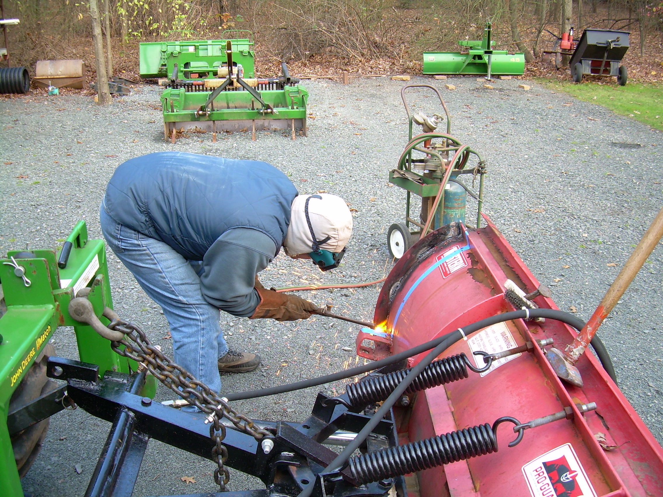

I always had the bigger bottles, I think the cu ft was the same as Steve mentioned above, that sounds familiar.
Anyway they are wicked heavy even for 2 guys if you have to lift the whole cart onto a truck, after 25 years I went with the smaller ones, where the acetylene bottle is the P-tank size and the ox is about 3 ft tall, they still fit in my big tank cart but much easier on the back.
Also with more abrasive wheel cutting tools, the torch doesn't get as much of a work out anymore. Pic of saw was just today.
Round here, whether you own or rent you still swap bottles, you don't get them filled, if you live close to the supplier go with the smaller bottles and try and get 2 of each this way you never run out in the middle of a job.
