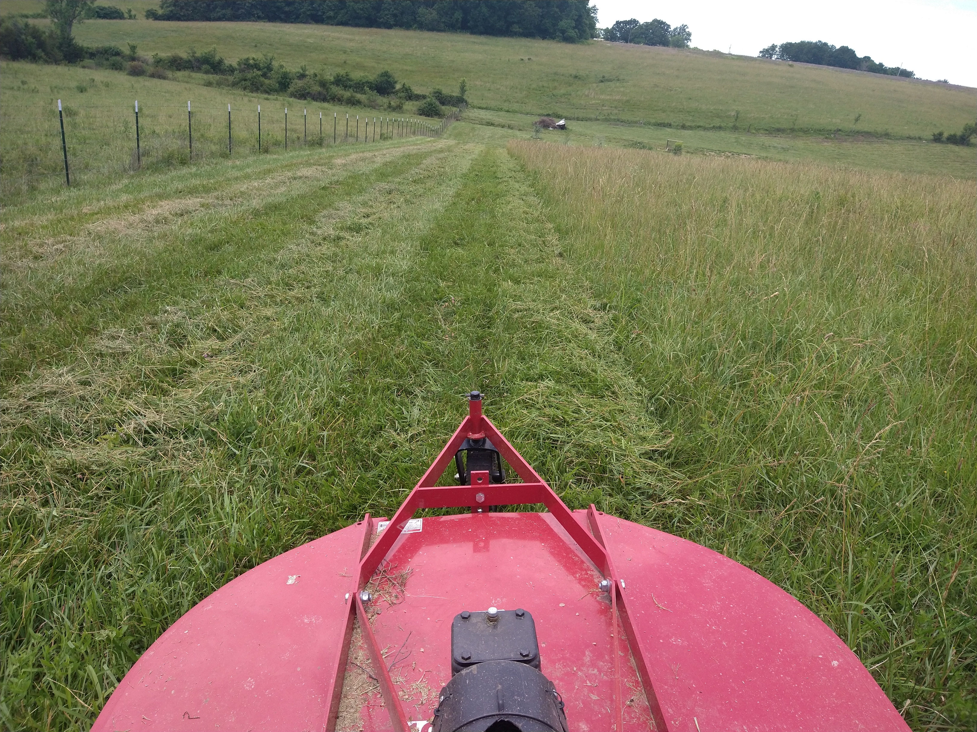

Best quality cutting I ever got with a bushog was 5' on a JD2010 tricycle. The hog didnt cover any wheel but the front. Mashed grass always stood back up before you came around again.
