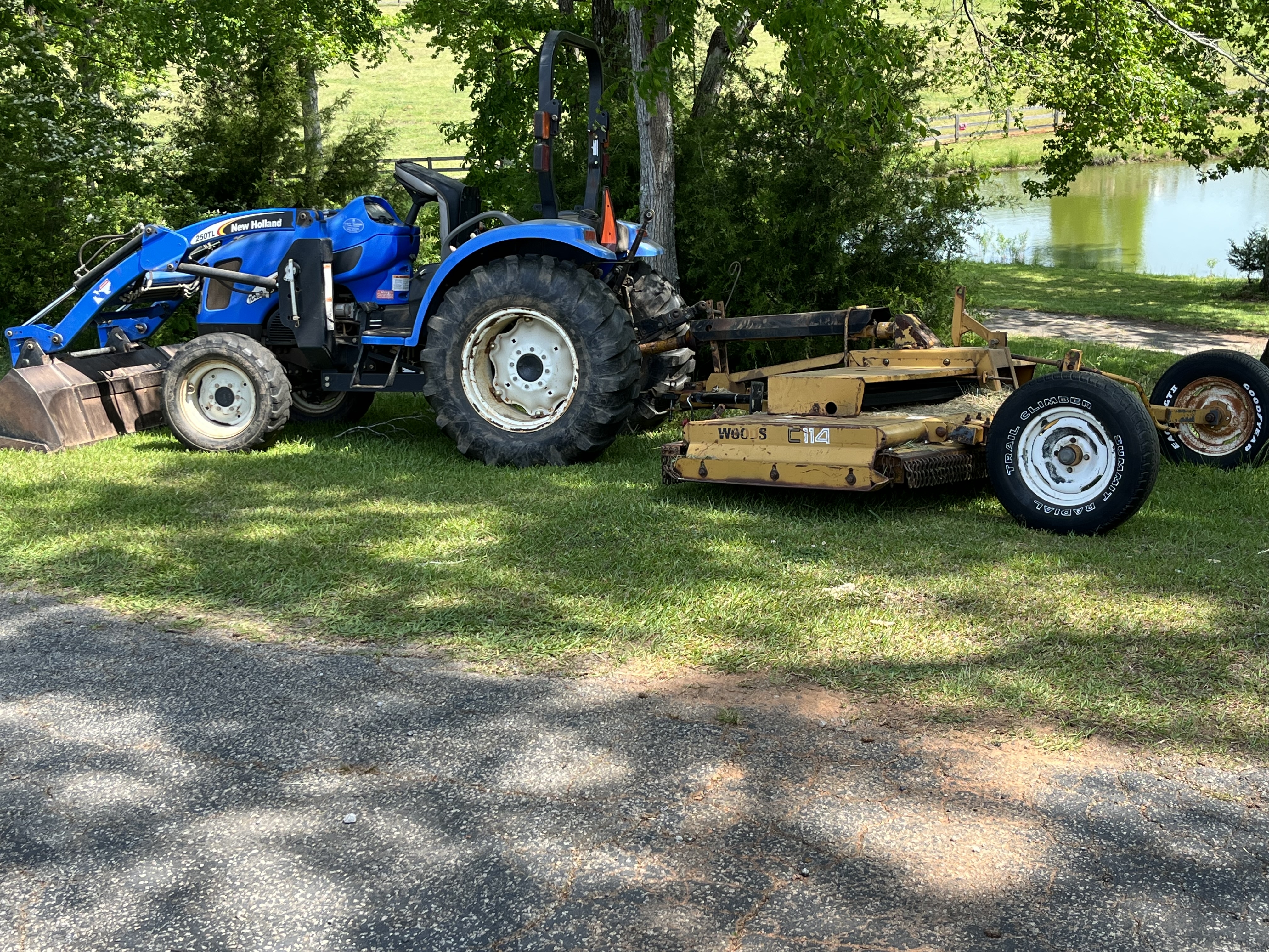

I run a Wood C114 pull type cutter that has a 9.5’ cutting width with my New Holland TC45DA that has about 39 PTO HP.
If the grass is really tall it causes me to slowdown to less than 3.5 MPH.
