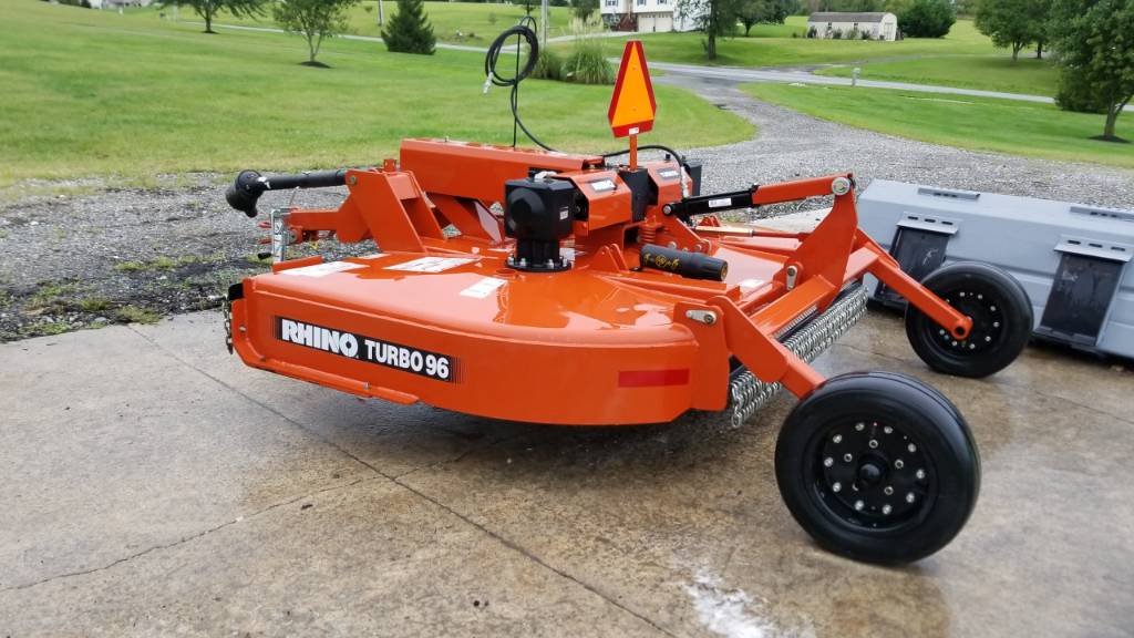

Picked up this 2014 barn find last month. It was only used twice. Covered in dust. I bought it for half price of new, pressure washed it off...and bam! Love it! 20180911_172837.jpeg
   / What size rotary cutter for M5660SUHD? #24
yeah boy, you got a dandy lifetime purchase
what is the lift capacity of your pull behind? don't know much about them
   / What size rotary cutter for M5660SUHD? #25
That's a nice one for sure..
