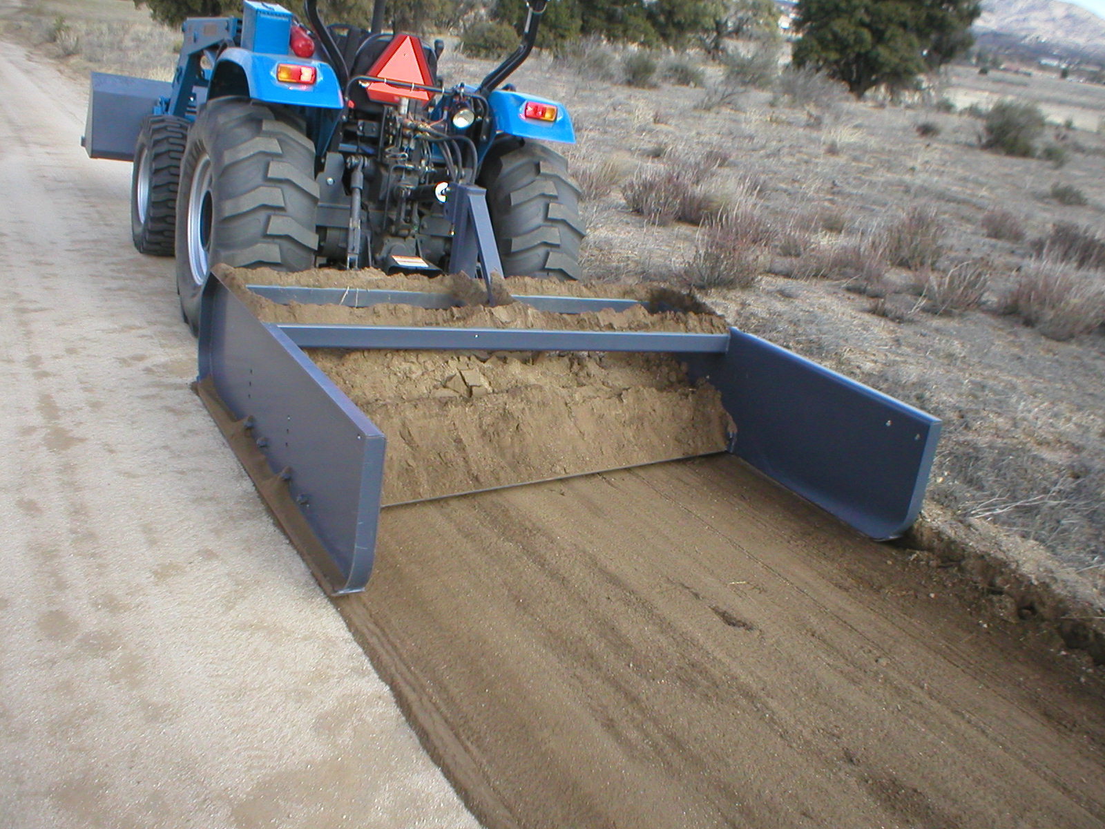

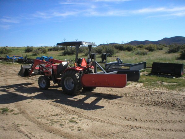

Well, with free material, that is pretty hard to beat. The longer skids will be better, in fact the longer the better. I think that the ones for sale usually have shorter sides for cost and shipping purposes. I have a 7' grader blade with 7' sides that weighs about 1600lbs, your tractor would not pull my grader blade and be of any use to you. My tractor is 75hp & weighs about 12k pounds and if I don't pay attention, it will stop my tractor, especially in soft ground.
I really feel that the best that your tractor is going to do is to pull a 6 footer and that will depend on how heavy the grader blade ends up. I also have a 32hp tractor that weighs right at 5k pounds and the 5' grader blade that I have for it is a perfect match. I hate to see you build this thing and have to use your friends M8200. If you have pretty good luck with your 6' box blade, I would stay with the 6' width for your grader blade.
Just my opinions, hope all goes well for you.

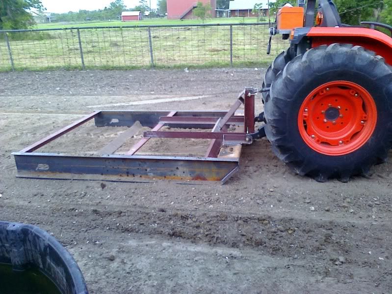

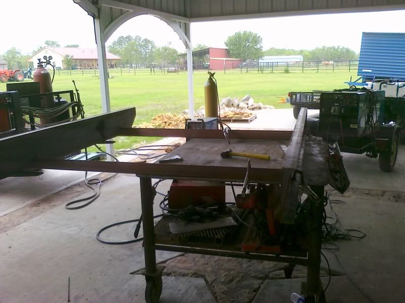

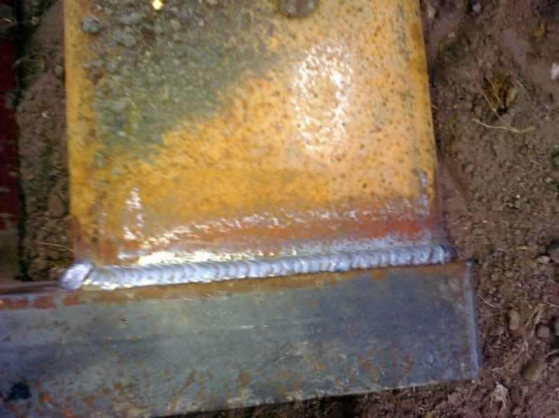

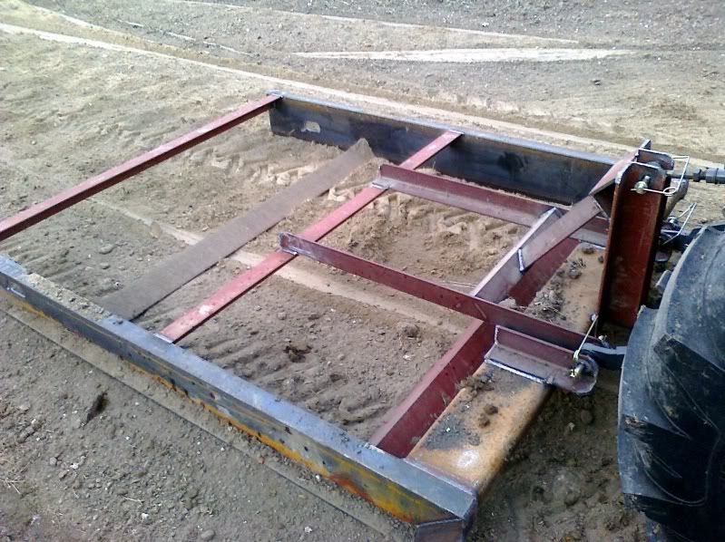

Got up early Saturday Am, turned on the torch, and got to cutting some steel. A little after lunch, I had a working Land Plane. I did not stop to take many photos, but here are the ones I did take.
This unit is 72" wide, inside the channel. The skids are 10" channel, 92' long.
Total weight is 740#, so ~123# per foot of width.

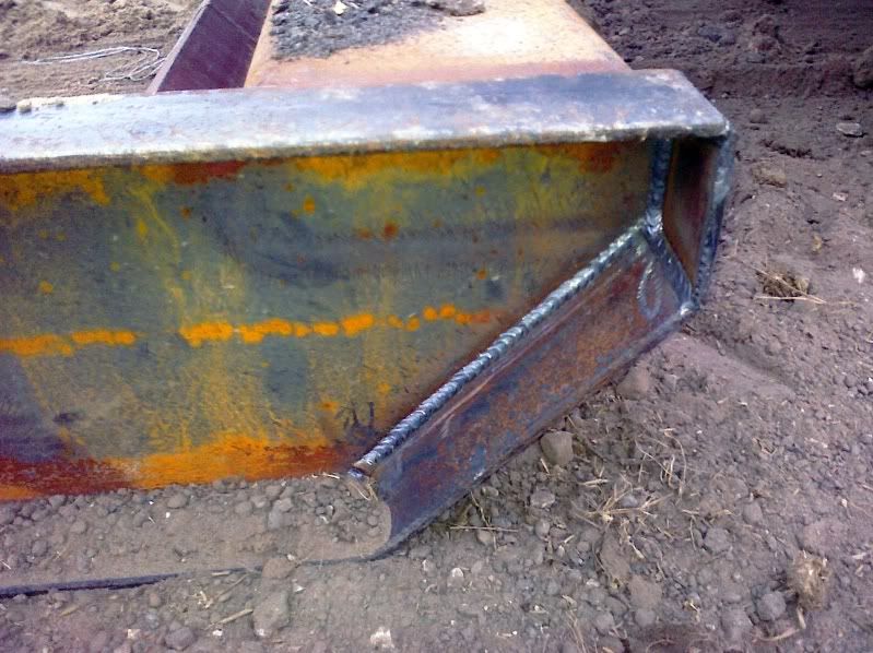

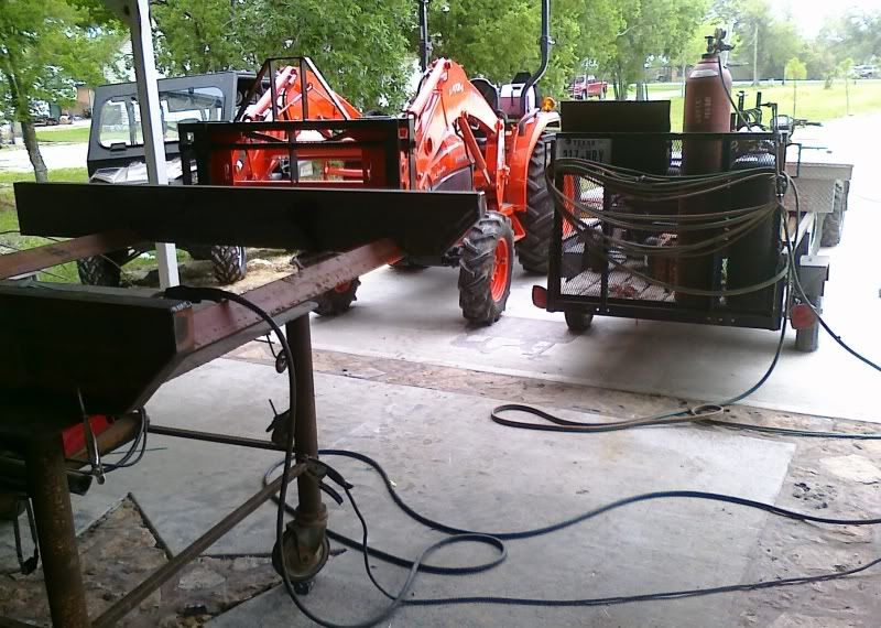

Tacking the bottom angles to the channel sides.
This was the most difficult cut/fit of the day. Due to the thickness of the steel, where the web meets the flange on the channel. I think it turned out alright thought.

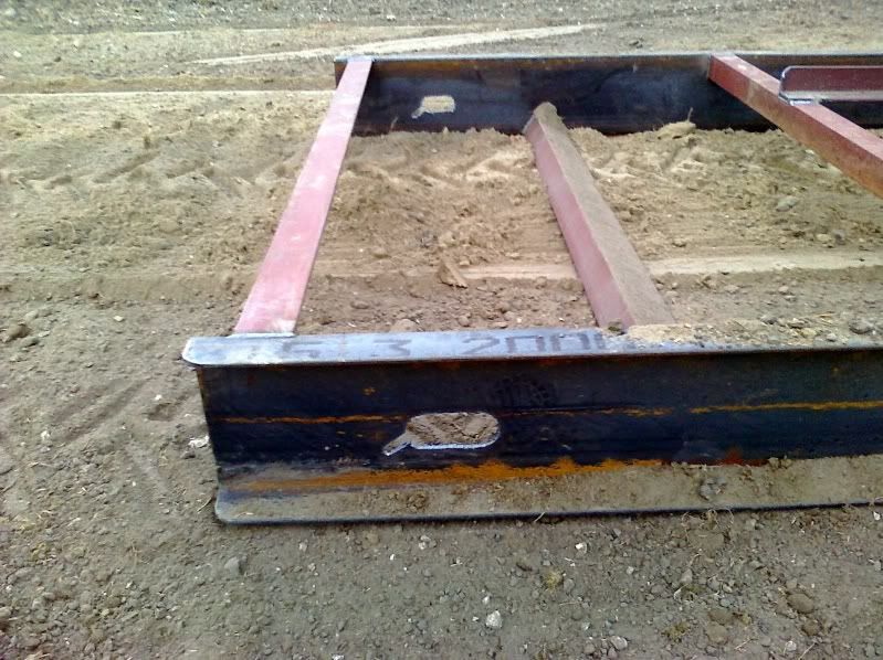

I used 3" x 6" x 3/8 wall rect tubing for the front for a couple reasons. I wanted weight, something substantial enough to handle the 3pt structure, and the ability if needed to handle scarifers down the road.
I cut these holes in the rear to hold chains, if for some reason I think I need to pull an additional drag.
Here are some pics of the almost complete Land Plane. It still needs some touch up with the grinder, and it needs to be sent off to the Galvanizing plant.

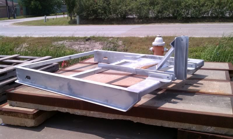

Finally sent my home built land plane to the galvanizing plant last week. I am pretty pleased with the outcome.
