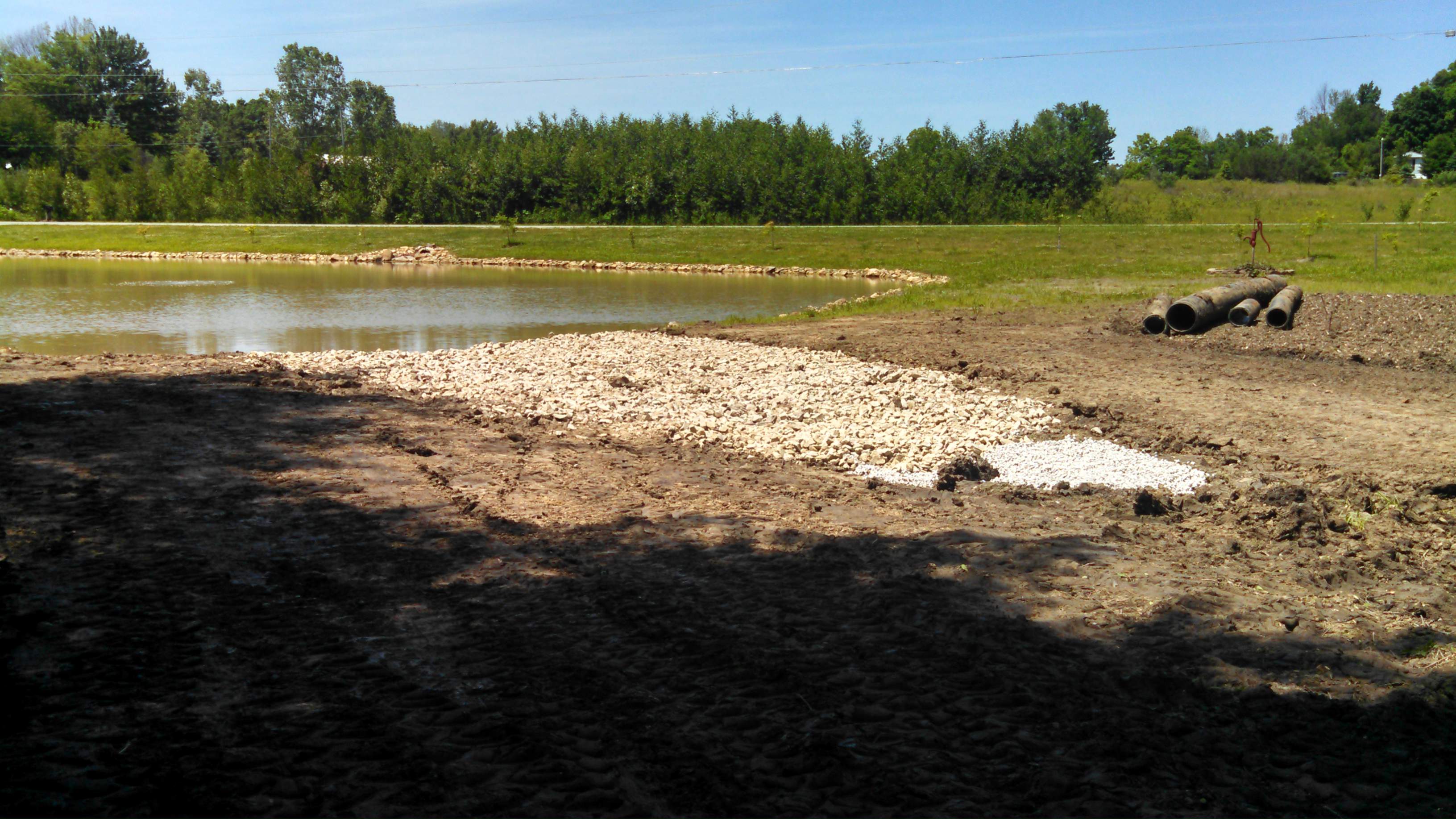

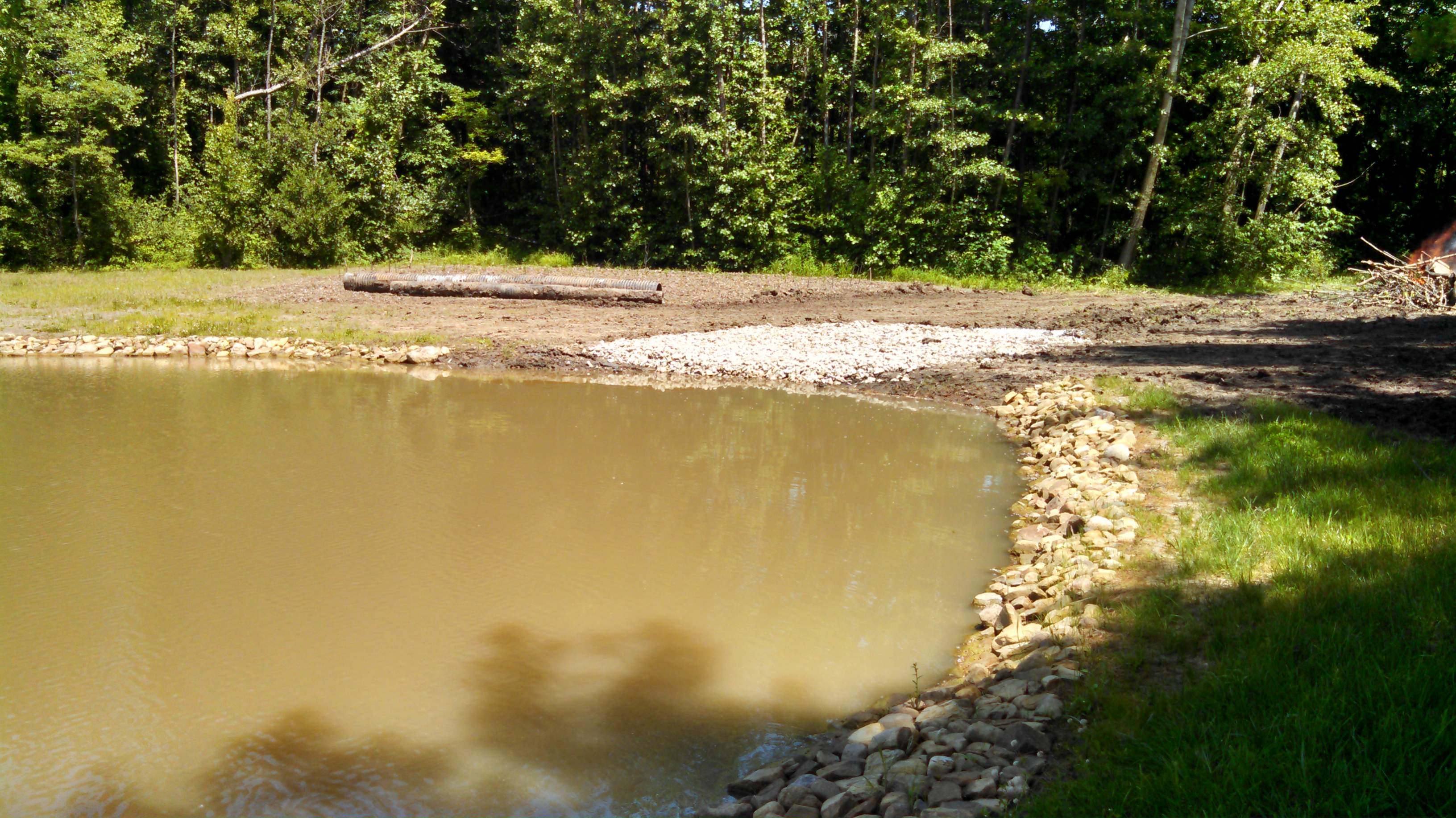

How much water and how fast is it moving through the swale? If any volume or speed at all, it will wash away 57's or crusher run. And 57's dont make a good base by itself over a soft area.
I used 1's and 2's of limestone for a pond overflow that carries alot of water. I like the end result. It is solid to run over even with water flowing over the top. It isnt bad to walk on or drive equipment on either. But if you dont have much clow that will wash away smaller stone, you could always top that with 57's.
Here is 10 tons.
