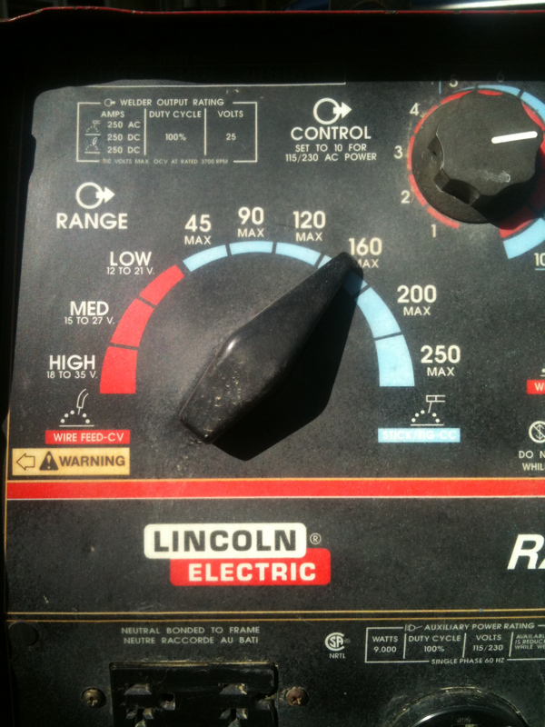

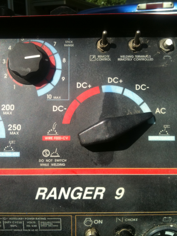

Guys
I am borrowing a Lincoln electric ranger 9 to weld some 1/2" steel brackets onto my land pride box blade. What should the settings be and what type of rod should I use?
I don't know much about welding and nothing about the settings. I have welded before but people have always setup the welder for me.
I could really use your help :)

I would set it on DC+, use 1/8-inch 7018, for flat welding I'd set the main selector at 160-max, and adjust the fine tune as needed. For vertical up I'd set the main selector at 120-max, and adjust the fine tune as needed. ;)
Thank you!
I'll give that a shot. :)

Remember all those settings have the blue background, don't switch anything to a Mig setting / CV!

i would use 1/8 6011 at about 100 amps.

Unfortunately I don't have a manual for the welder. I'll try out the settings mentioned and go from there. That's a good idea about looking on the website.
I'm excited to try it out on the box blade. I would have the other day but ran out of oxygen for the torches so I couldn't cut the steel. I just refilled so maybe I'll get to do some hurricane welding tomorrow :)

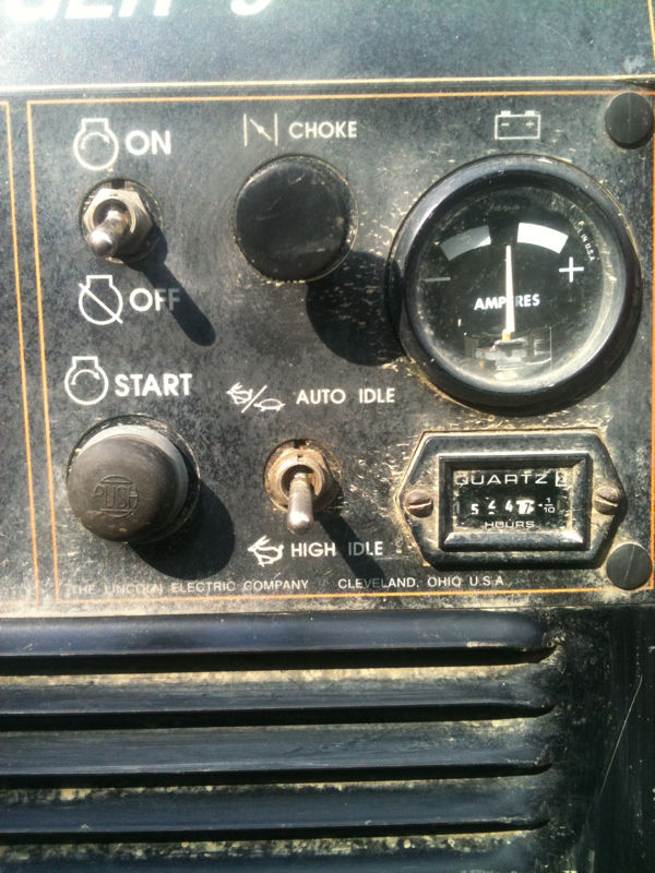

Leave it on auto idle also!
Thanks, I did end up getting the job done a little while ago, following the suggestions.
This welder would never idle, the auto idle didn't work for some reason so I had to always leave it on fast idle.

I still wonder what the idle issue was though.
