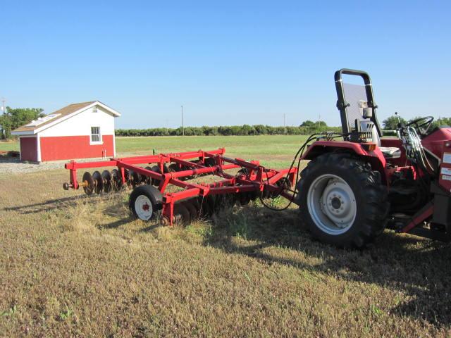

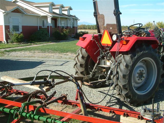

Here's a setup I used when checking out a hydraulic cylinder (aka ram) that I was installing on a grain drill I was restoring.
This one shows the hydraulic hookup to my wheel disc. There's a ram on the disc that raises and lowers the wheels so the disc can be transported from field to field over the roads.
Hope this helps.

Here are the triple rear remotes on my 2008 Mahindra 5525.
Hope this helps.
flusher,
CLEAR as a bell sir! It helped very much!
I am adding 2 remotes to my list of "Must Mods" for the dealer. Plus the welded hooks and bucket reinforcement someone mentioned.
THANK YOU!
