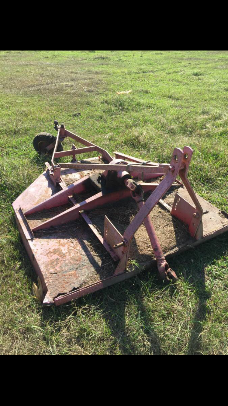

I need help from a Bush Hog pro.
I am thinking about purchasing this Bush Hog rotary cutter but I dont know what model it is.
Does anyone know?
I want to know the model so I can order replacement parts if it needs it.
Sorry this is the only photo I have. It is a 5 foot Bush Hog.
Any help would be greatly appreciated.

Looks like it might be a 305.If it is 6 feet wide, it would be a 306.
/ What model Bush Hog is this? #3
Well, for starters welcome to the forum. Can't say for sure, but looks like it might be an older rhino. Check around the gearbox area and on the mower deck. I think there should be some kind of manufacturing plate on it somewhere. That's the best I got for you and again welcome to the forum.

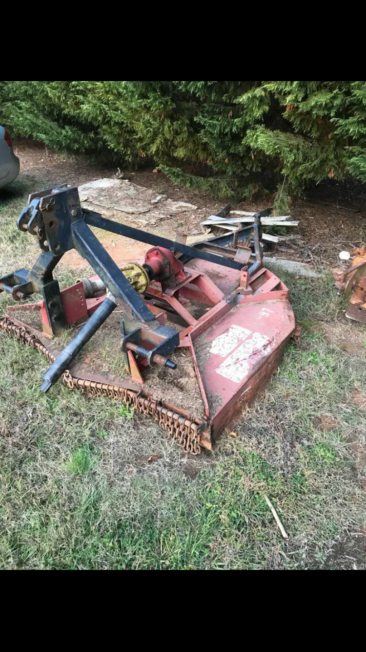

Thanks for the help MESSMAKER, I had someone else tell me It might be an older model 305. I have seen a 305 that looked like this but not one where the triangular bracing goes all the way over the deck. Maybe the one I知 looking at is an older model?

It might be a 305 as I am not sure, but it is not that old as it has a triangular back...maybe from the 1960's? The really old ones have square backs and far more simple rear wheels mounting designs (that were prone to crack). Sadly my model number has gone the way of the doo doo bird, but it is similar to that, but much older.
Are parts available for the 305?

Here is a link to the 305/306 operators manual from the Bush Hog web site: http://www.bushhog.com/uploads/documents/BHRotaryCutter305-306OM-03.pdf
It does look like the picture in the manual. As far as parts being available for it from Bush Hog might be worth a call to them.
edit: sorry, got my pictures confused, the picture in post #4, not the picture in post #1, looks like the one in this manual .

Thanks for the help Gator. I’m sure the second picture I posted is a 305. The first picture doesn’t match the 305 diagram though.
At least not exactly.

It appears to be an old 305. Parts may be an issue with the elevated pedestal. Those hogs are what made Bush Hog the name that they are. I've got several that are going to be scrapped. Actually sold one of the 306's but it was a later model without stump jumper. If it is in good working order it will serve you well.
