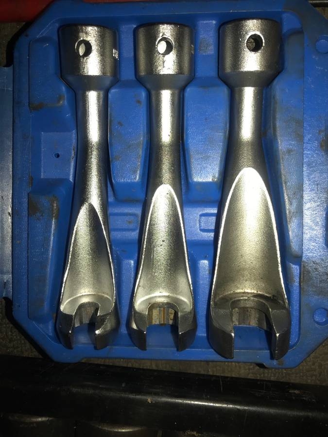

What is this tool and it's use? (I suppose the name will tell me it's use)
Local diesel mechanic has a bunch of his tools listed and this caught my eye. (what caught my interest were the metric sockets which I've been looking to obtain)
I might add, it appears to be what I'd call a crows foot, but, I HAVE a set of crows foot (feet?) so I'm not feeling that one.

They do look like a type of crow foot wrench but those usually have hex shaped openings to hopefully reduce rounding of the fitting. Perhaps these are an extended crow foot.

My initial reaction is crow foot also. Almost look like they are for an impact. I bet it’s some kind of speciality tool but i don't know what.

I think it's a vertical crows foot. For situations where you can't get a socket on it but there's not enough clearance for a regular crows foot. Probably one of those things that's rarely used but super useful when it's needed.

Looks very similar to a Sprinkler Head wrench.

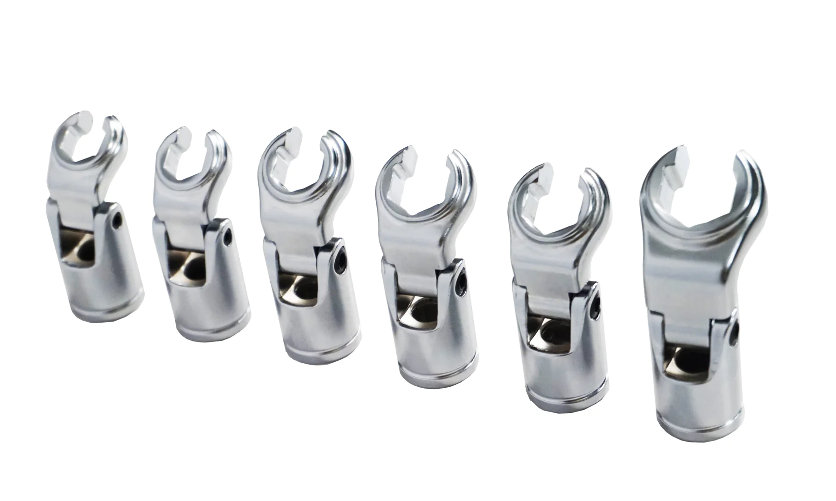

First time I seen these:
Crows Feet Adjustable Flare Nut Sockets​

I was thinking maybe it’s a tool to loosen injectors if they were recessed too deep for a regular crows foot.

They look exactly like some of the fuel injector removal wrenches I have.
