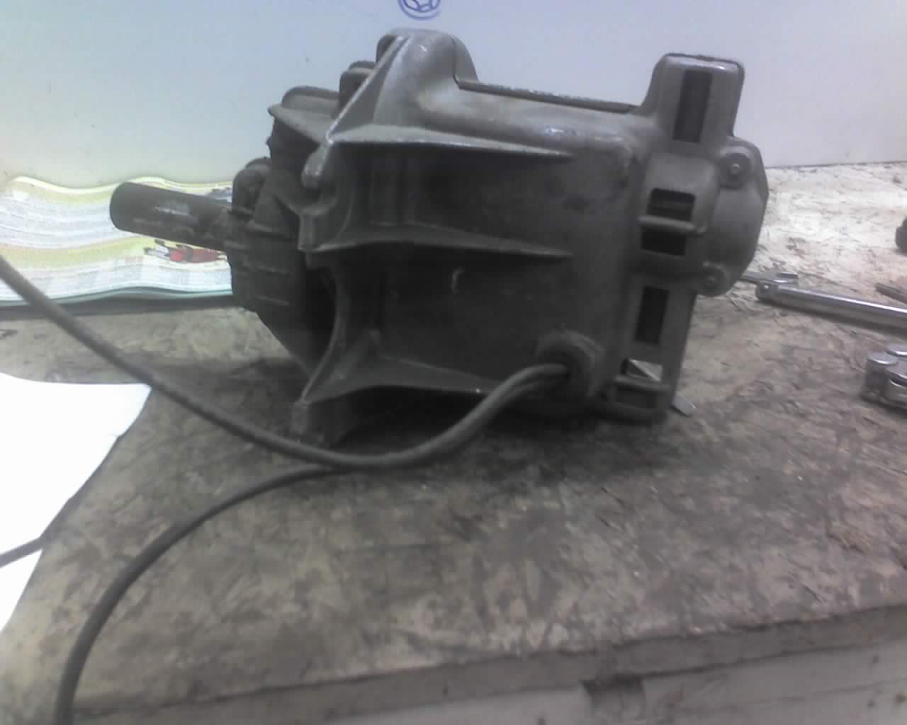

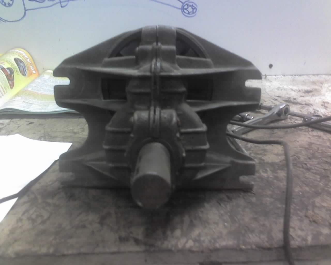

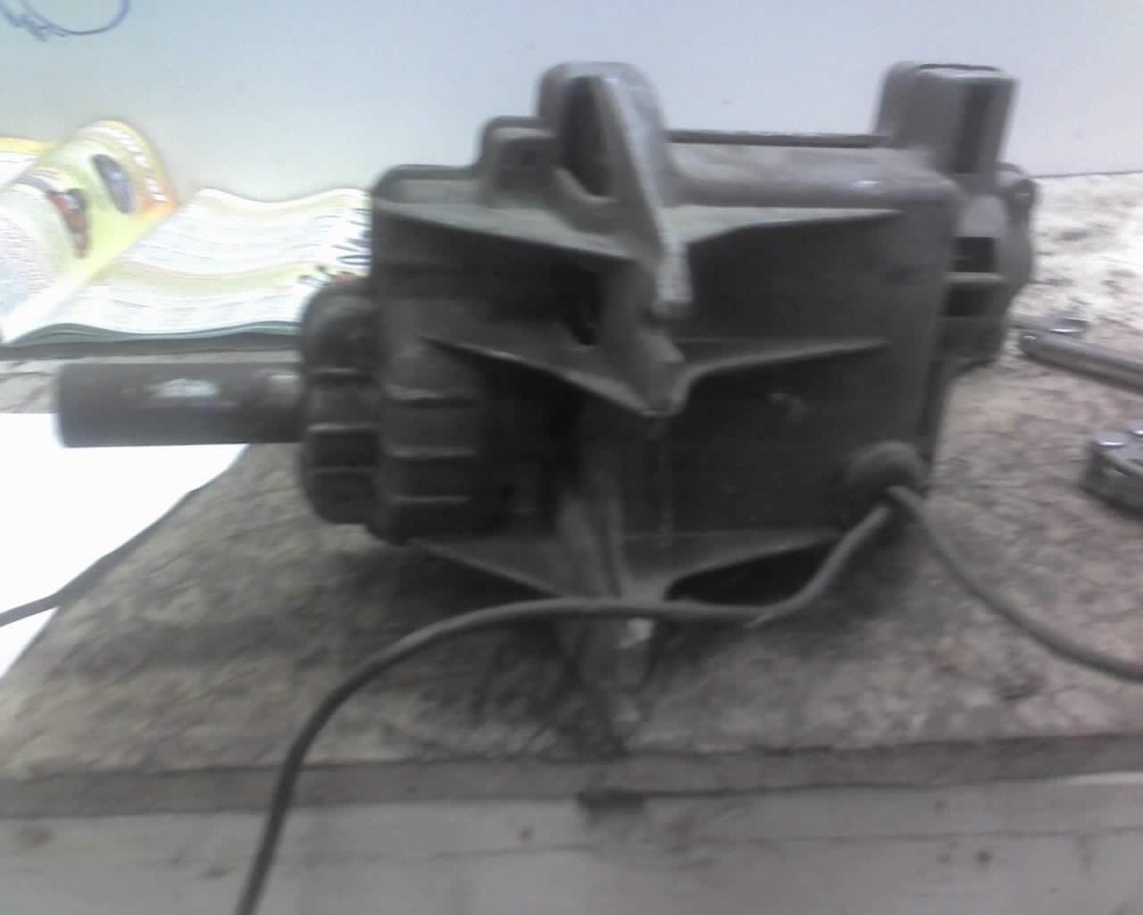

Not really sure where to post this but.........
I aquired this electric motor out of an old "farm" bar of a buddys.
I assume it must go to some peice of shop equipment like a drill press or????????
It has no nameplate on it. It is a gear reduction motor. And with two wires as far as I can tell it is 120v. At least I know it runs ut I give it 120v.
Just wondering if anyone has any idea what it might be for?? It's not very big. Shaft is about 1" diameter and is physically about the size of an aternator.

Just guessing but it appears to be lowspeed gear motor about 6:1 reduction looking at the housing. Might be a motor for an old conveyor.
   / What is this electric motor for??? #3
Looks more like it came out of a washing machine.

Windshield wiper motor? On closer inspection it is too big for a windshielf wiper not with a fan and shaft that big. I think washing machine would be about right.

It's not new. Don't know if it has ever been used, but it is definatally not new.
With no load, it pulls 7 amps @ 120v. So that's about a 1 HP motor.
It has a 4.5/1 reduction that reverses the direction of the shaft. (looking at the shaft, the motor spins CW and the shaft CCW)
The shaft is 7/8" and 2.5" long with two .150" by 5/8 woodruf keys.
It has two brushes in the back (opposite the output shaft) that are 180 degrees appart. You can see where they are in some of the pics. There is actually vent holes over the part that the brushes contact. (sorry it's been too long ang I forgot all the termonoligy. Stator, commutator, rotor?????)
As to how it's wound??? Not sure either without brushing up on electric motors again. But the ohms between the two wires is nil. Only about 1-2 ohms if that helps.
