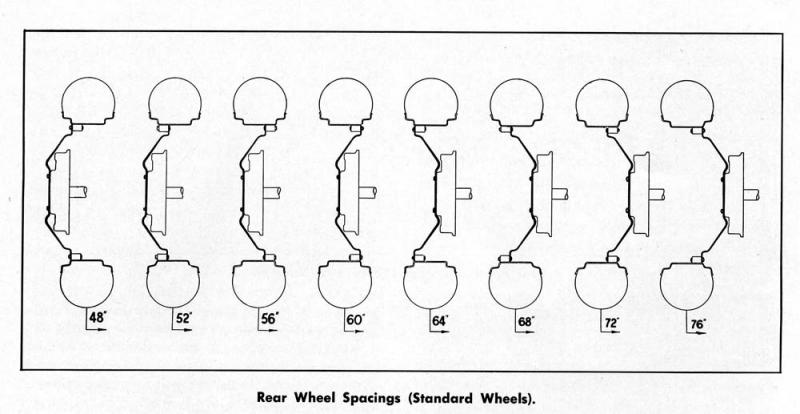

Just as mddorange has suggested, especially regarding wheel 'spacing'; the inner part of the rim can be flipped around and bolted to in a number of configurations to bring the wheel closer or farther from the tractor.
'Filling' the back wheels/tyres means weighing them down with a fluid, instead of simply air.

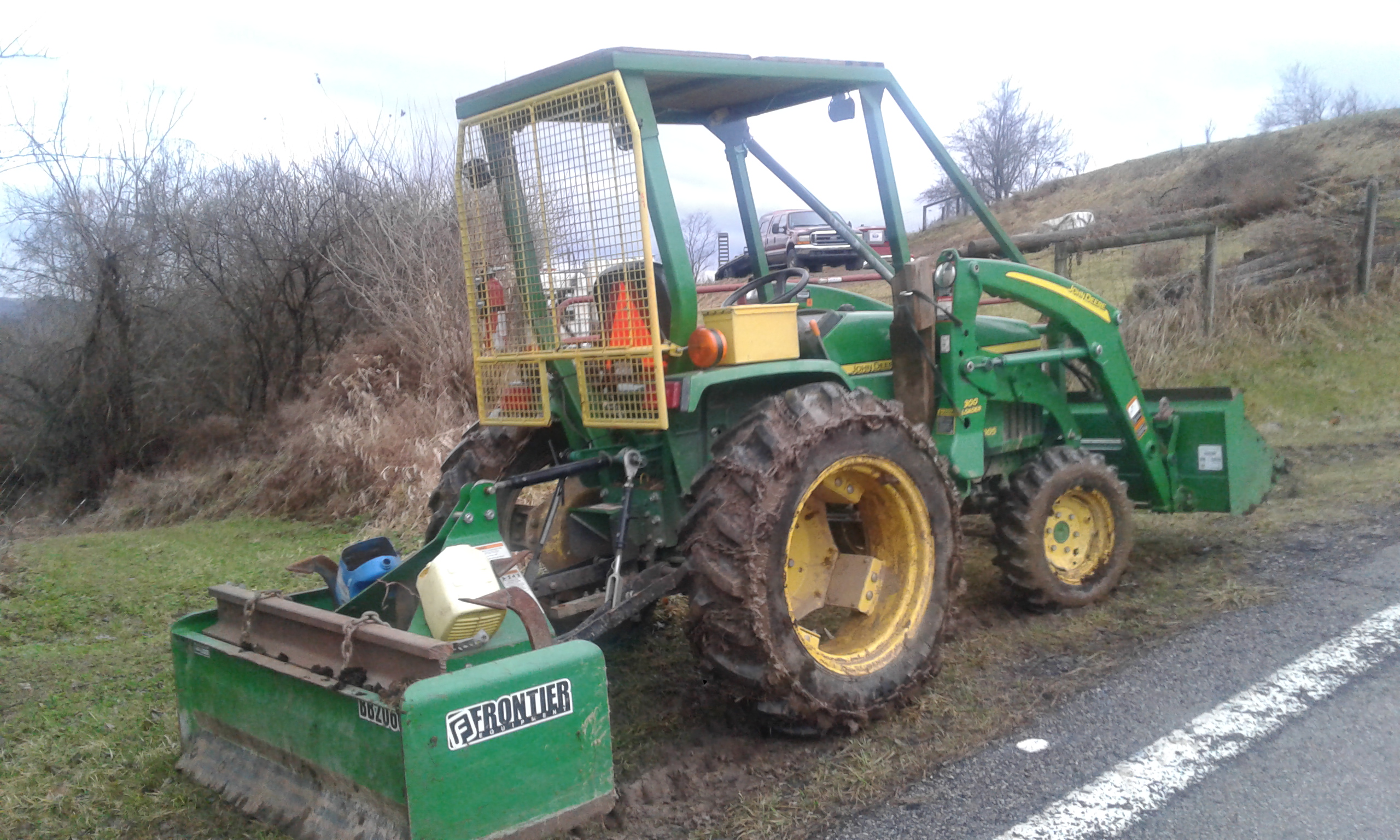

As stated, widen rear wheels, add spacers as well. I added 4.5" to each side, have all 4 tires loaded, and want wheel weights too... buy a longer wheelbase tractor if available, vs shorter, if comparing models.

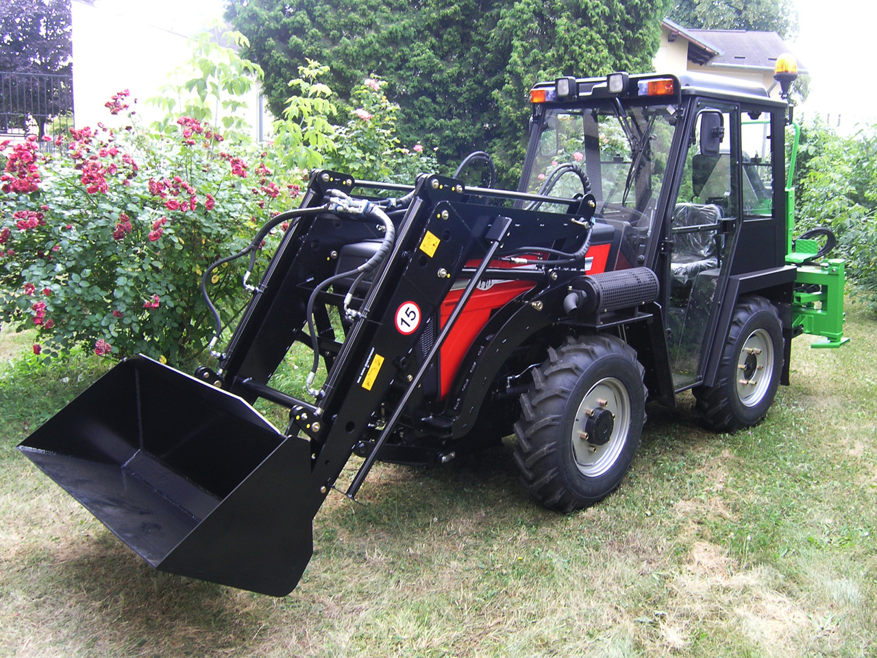

I found a photo of the Yukon working across a hillside. Looks pretty good, actually. Also, it has front and rear PTOs.
And is available with a loader.
