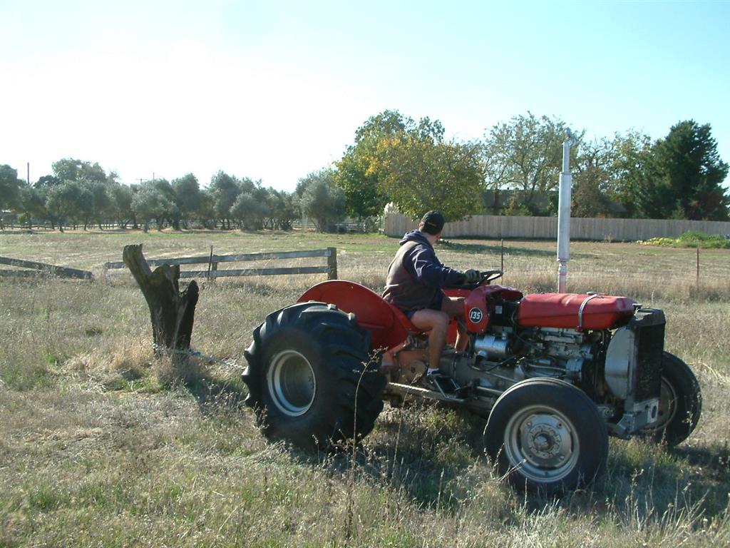

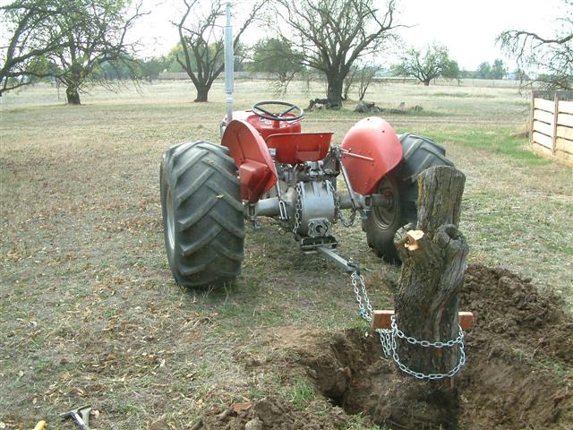

They're called "straddle" because you sit lower on the tractor with your legs straddling the transmission. My 1964 MF135 diesel is a classic straddle tractor with a low center of gravity for maximum stability.
View attachment 545994View attachment 545995
My 135 has been modified to squat very low for work in orchards. The rear rims are 16" dia instead of 28-32", the rear wheels are 18" wide (like those used on a combine or a bankout truck) and the front axle spindles have been shortened to keep the tractor level.
Good luck
