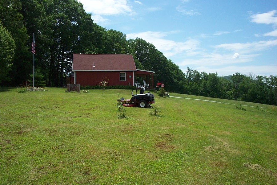

Afternoon canoetrpr,
Agreed ! I was going to get a 6 ft finish mower for the tractor, and last minute changed my mind and bought a small 42" Toro ZTR for the acre or acre and a half of lawn around the house ! I change implements often enough now ! I liked the idea of a dedicated mowin machine ! :)
