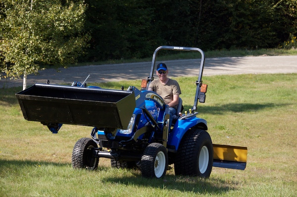

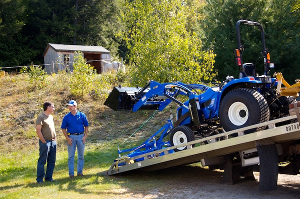

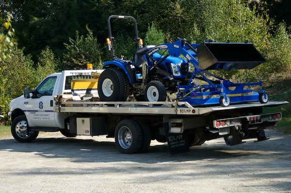

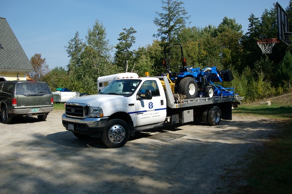

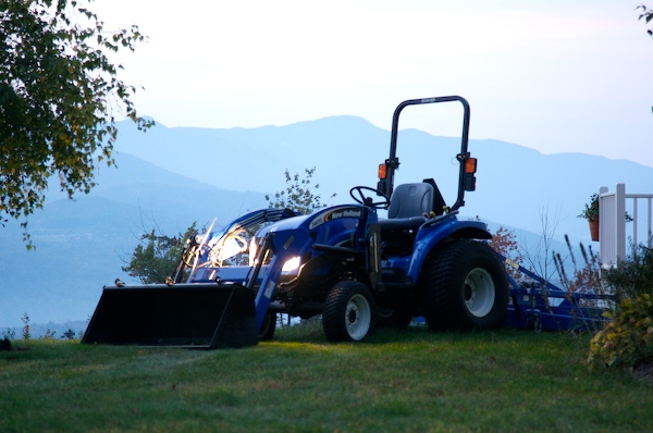

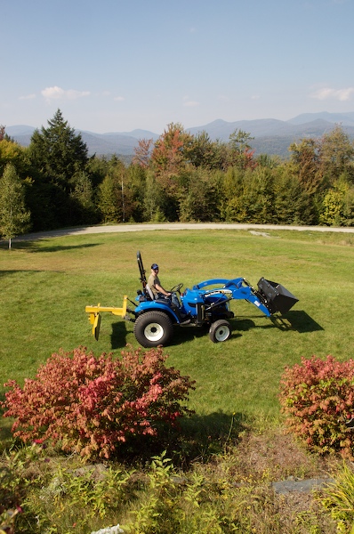

Well, delivery day came and went by WAY too fast. The tractor was delivered as promised at 11am. I was suppose to go to work at 3, but LUCKILY the client called and cancelled!!! Yea team. It came with just .75 hour on it. I now have 5 on it. Did a little digging but not much as I'm waiting on the cutting bar. Mounted the mower which was kinda a pain to get the shaft hooked up. Maybe I just need to get use to it. Did some mowing up and down vs. across like I did on my garden tractor. Ended up scalping a bit till I raised the deck 1" and figured out the floating position etc. Pulled out 2 trees that my wonderful wife has wanted gone for the past 4 years! Tried playing with the rocks a little, but did not want to really push it until I mount the new cutting edge.
All I can say about Bechard's is they are the best. If you're in NY, VT, NH or even Maine check them out. Family run shop, mom and dad still involved, but run by the 3 siblings. GREAT people, great service, great price. Can't say enough about them.
Finally some of the requested images.
1 and 2 are the tractor on the trailer. 3 is myself and Mark standing by the tractor as it is just about to be downloaded. 4 and 5 are the tractor being put thru it's paces, and #6 is a beauty shot of a nice new but now dirty tractor.
