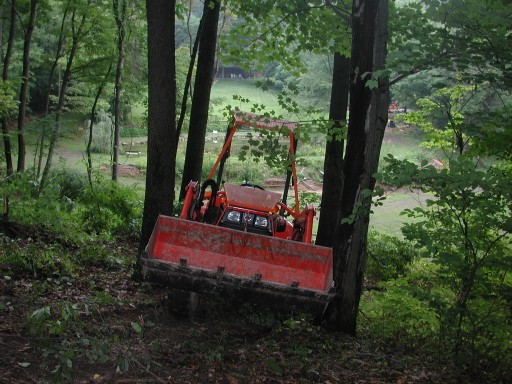

<font color="blue"> and get a tractor that could squeeze between the trees. </font>
vjcunr,
I can identify with that! This attachment shows why I like having a 54" bucket over the 60".
My B2910 was ordered with a 60" bucket, but I changed to a 54" before delivery and for my needs I am totally satisfied with that size and would not want the 60".
If I had had a 60" bucket, my tractor would have gone where it is in the attached photo... /forums/images/graemlins/smile.gif If you have a lot of trees to get between/past/around the 54" is the way to go.
Enjoy the buying process! /forums/images/graemlins/smile.gif
