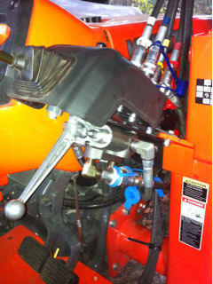

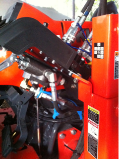

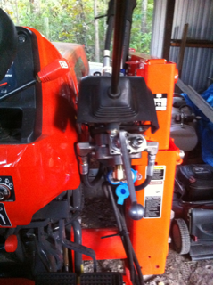

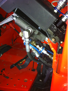

Rear remotes are about $750 from kubota. And that's not installed. I just added another single spool valve under my fel joystick. I piped the pressure line from the tractor to the inlet on my new valve. Then from the new outlet into the pressure inlet on my fel valve. Both valves are open center so you can just add a valve inline. A universal valve from prince or cross is about $120. I have a total of about $250 including my homemade bracket, fittings, quick connects and hoses all the way to the front.

/ What is needed hydraulically for a grapple? #16
Hope this helps
/ What is needed hydraulically for a grapple? #17
No doubt a rip off. Check out my setup. $250 v the $750 from kubota. Made the bracket and piped it in. Price includes everything down to the 177" hydraulic lines to the front of the loader.
/ What is needed hydraulically for a grapple? #18
No doubt a rip off. Check out my setup. $250 v the $750 from kubota. Made the bracket and piped it in. Price includes everything down to the 117" hydraulic lines to the front of the loader.
/ What is needed hydraulically for a grapple? #20
Thanks. Saved a ton. Plus it all has QuickConnects in case I decide to detach my loader. Works great and doesn't look too bad.
