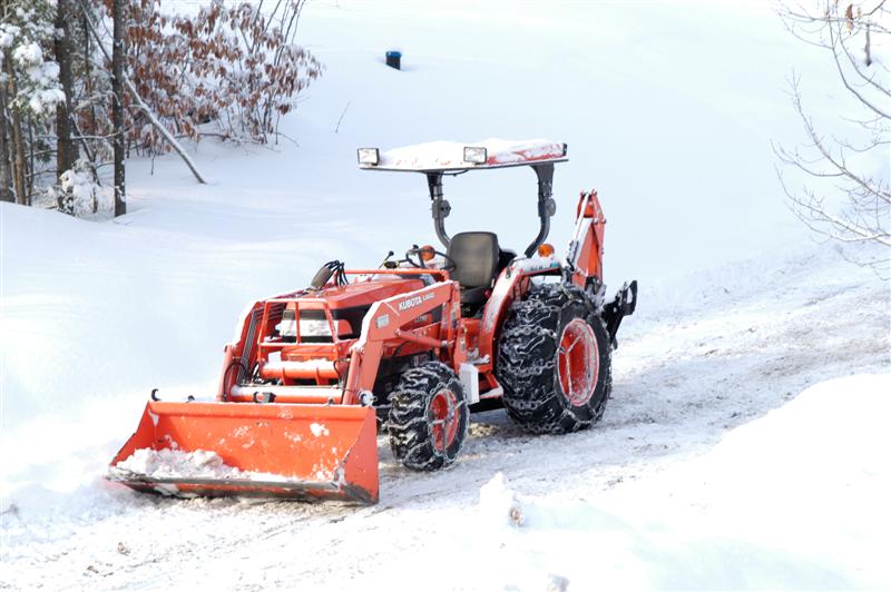

bota7800 said:
AW Direct Towing Recovery Service Vehicle and Wrecker Accessories - 1-800-243-3194 has weld on versions of both and and anchor hooks. It has been a very useful bucket modification.
This is what I have on my bucket and it has worked out very well for me.
I have three slip hooks, 2 on the ends and one in the center.
Two grab hooks between them.
It may be overkill but I've found that there isn't much I cannot do with this setup. I also have two grab hooks on the back of my BH bucket for craning.
/ What is and why use...chain hooks? #11
Casco1, Your first picture looks like your bucket is rigged for war. :eek:
The second looks like you won!! :D MikeD74T
