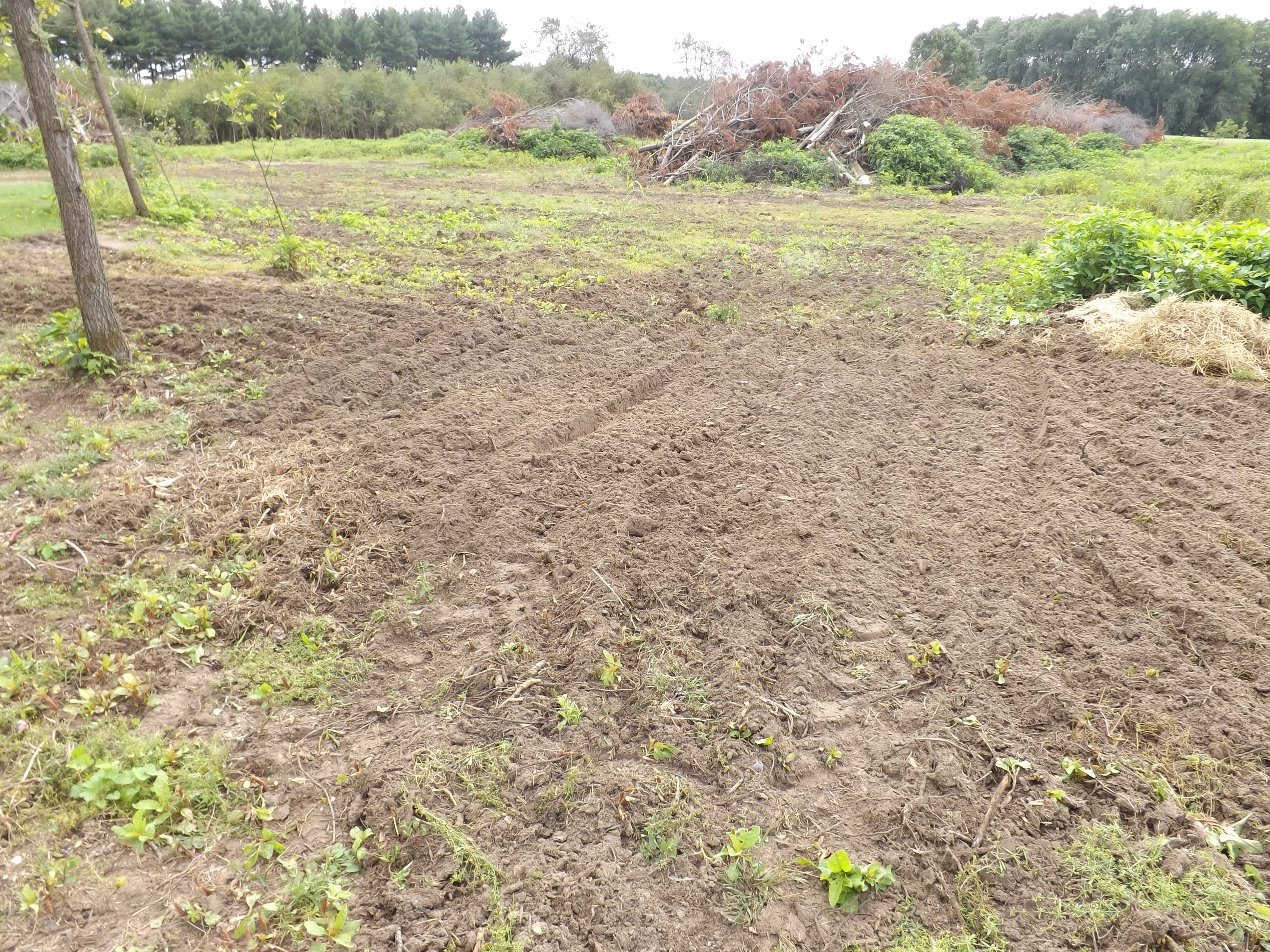

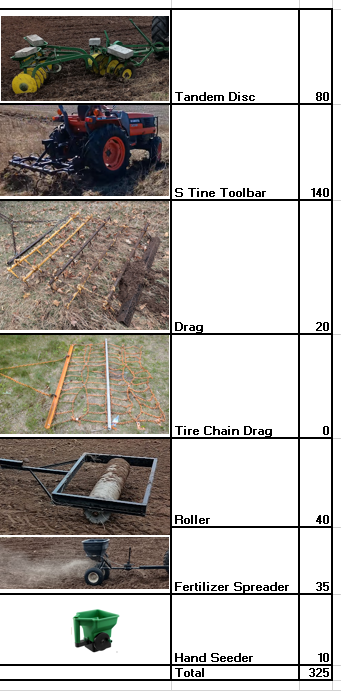

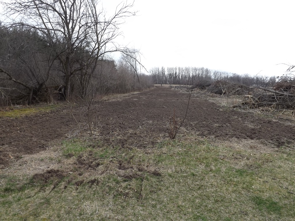

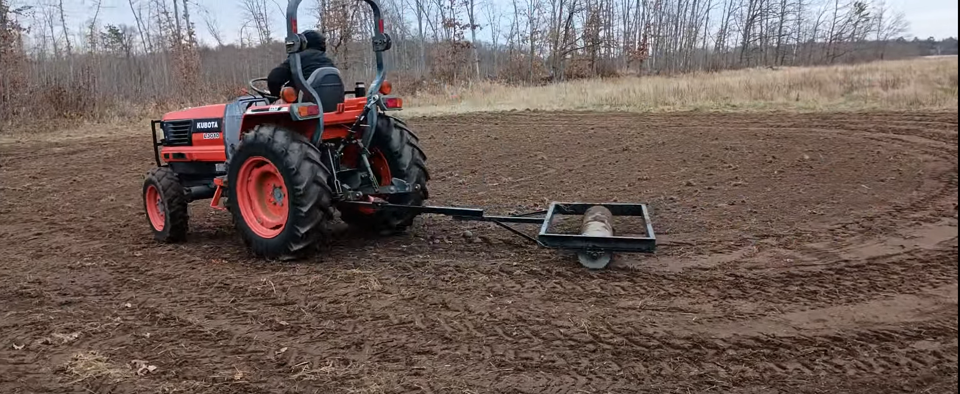

We just worked on one of our food plots today, so I thought I'd start a thread. I've been able to pick up implements for pretty good prices, but it takes patience and lots of looking. Here's what I have, and pics to follow. I am working on fixing up an old corn planter, and I'd like to have a grain drill, but $$$. Broadcast seeding working well enough for now.
   / What implements do y'all have for food plots, and what do you wish you had?
#2

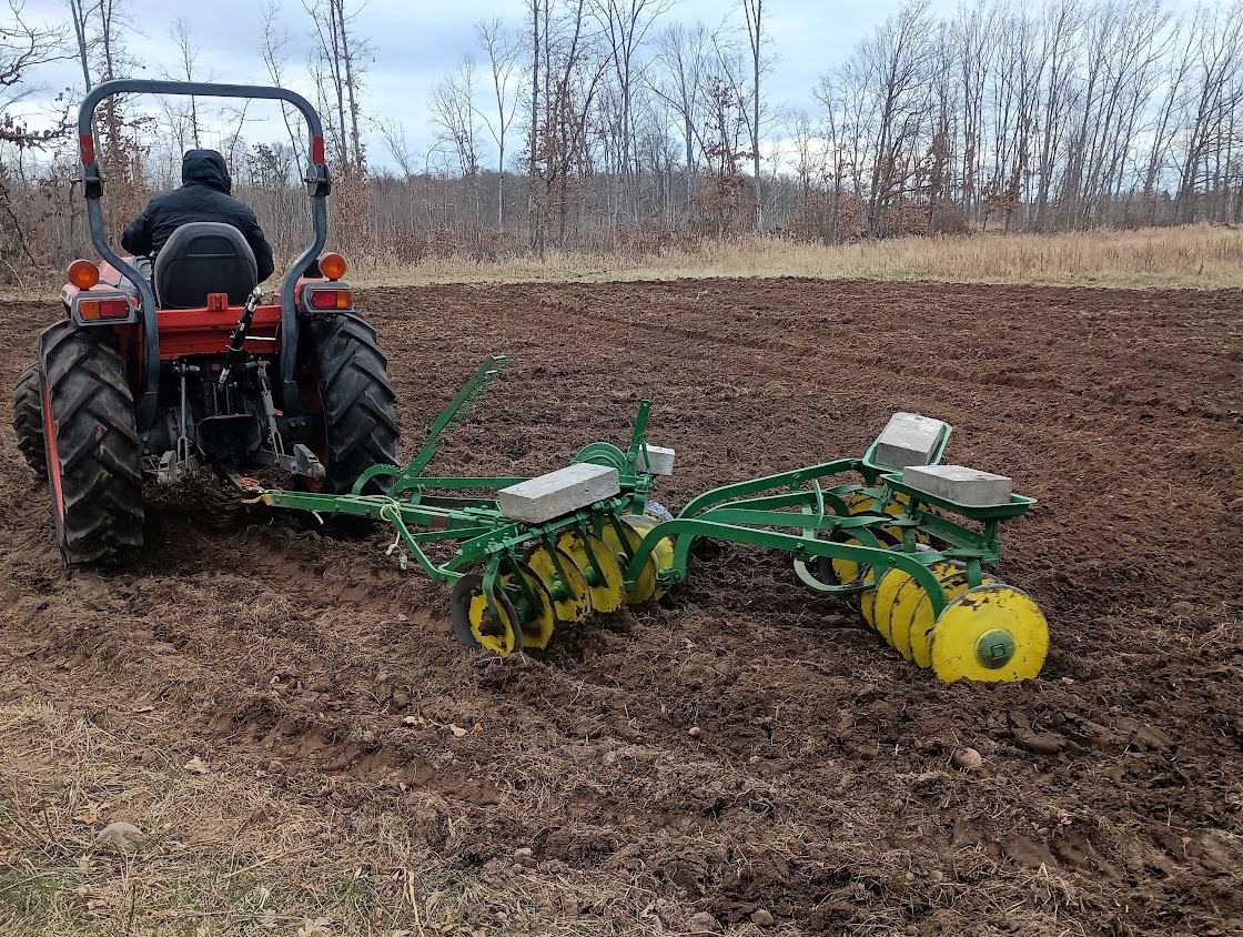

The disc was yard art, and the axles were frozen but easy to free up. All zerks took grease.

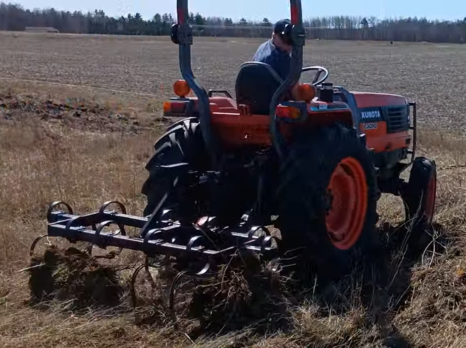

Caught people napping at an online auction for the S Tine toolbar

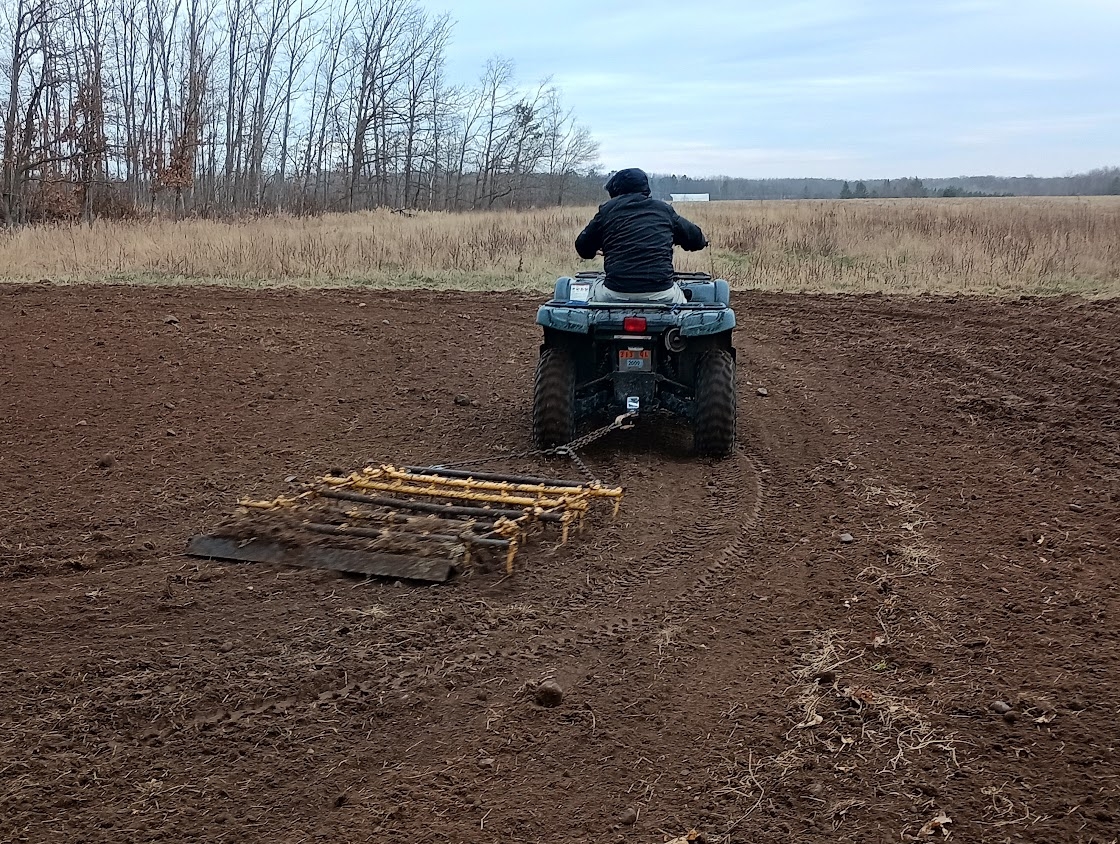

Got the drag at a yard sale

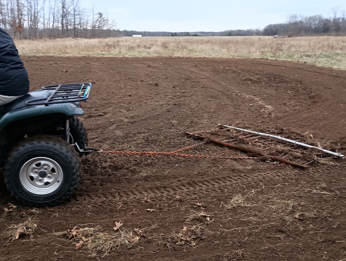

Made the chain drag
Roller was on online auction, but detached from frame. Just needed new pillow block bearings - heavier than it looks

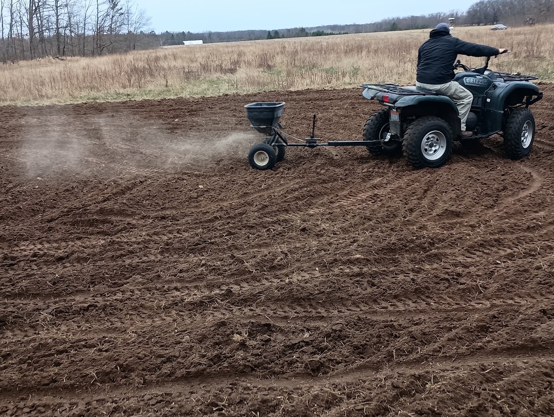

Fertilizer spreader was on Craigslist
Hand seeder bought at Farm and Fleet

6’ tiller, brush hog to mow down the previous year’s stubble, 6’ cultipacker, for a drag I have 3 truck tires bolted together (buries bigger seeds better than the cultipacker).
For breaking new ground, I have a sub spoiler and potato plow.
Tiller is the most useful, but it doesn’t like my rocky areas, so I’m contemplating getting a 3 pt disk. And I’d love something that picks rocks better than me bending over.
