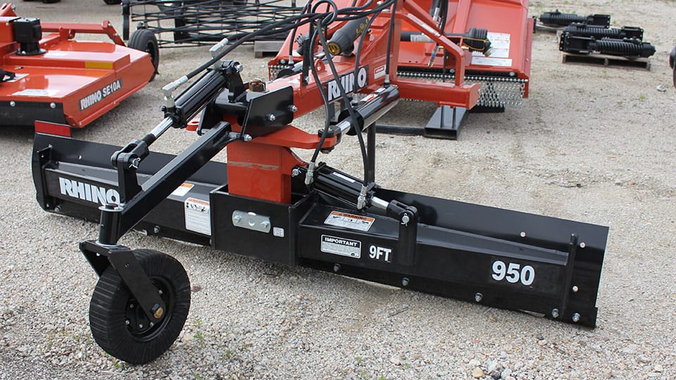

People also recommend tow behind graders with wheels, or rear blades with a trailing wheel, but they are hard to find and $$$.

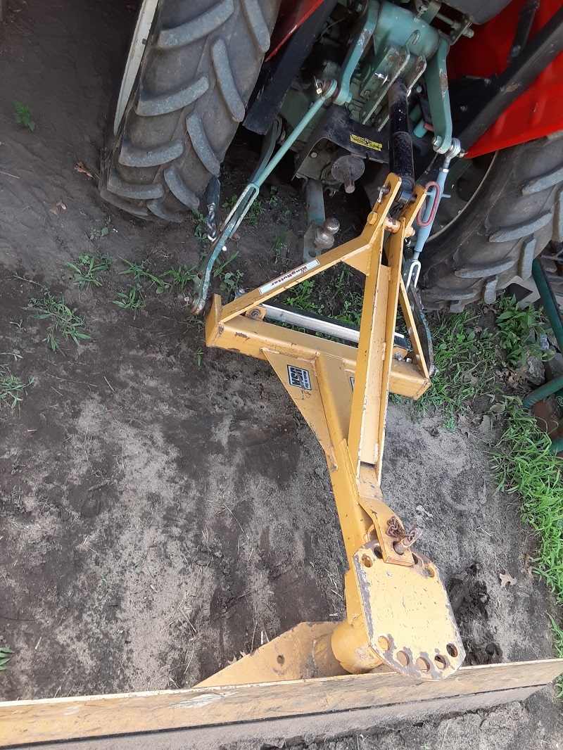

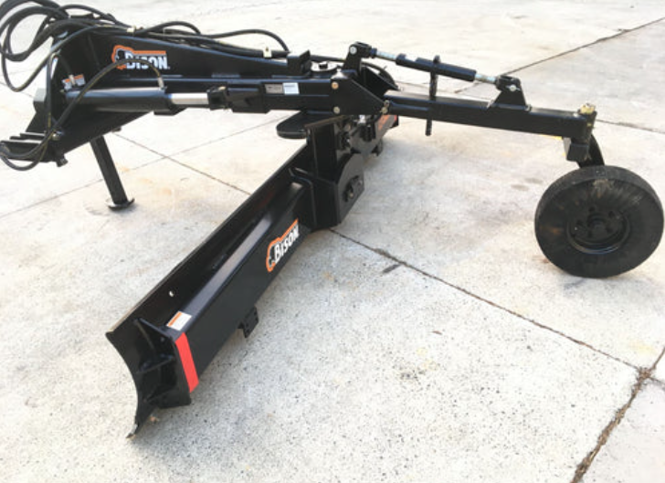

Not knowing the grade steepness of the road, i would be hard to pick between the two postings. Not only the steep grade, what about curves and banking. These all play an important part on one of the two you have listed.
I maintain about 5550FT on my road with a straight blade and where the top link would sit is a 1-ton RAM truck shock-absorber. The impacts of the washboard, holes and loose gravel jounce the tractor around a good deal. With the truck shock, much of it is now gone. I can focus more on grading and driving without needing my neck twisted to babysit the blade.
The blade is set in this postilion for the finish grading. This way, the gravel fills the oles smoothly and not ripping the holes to become bigger.

Rake with drop down grader blade comes in handy.

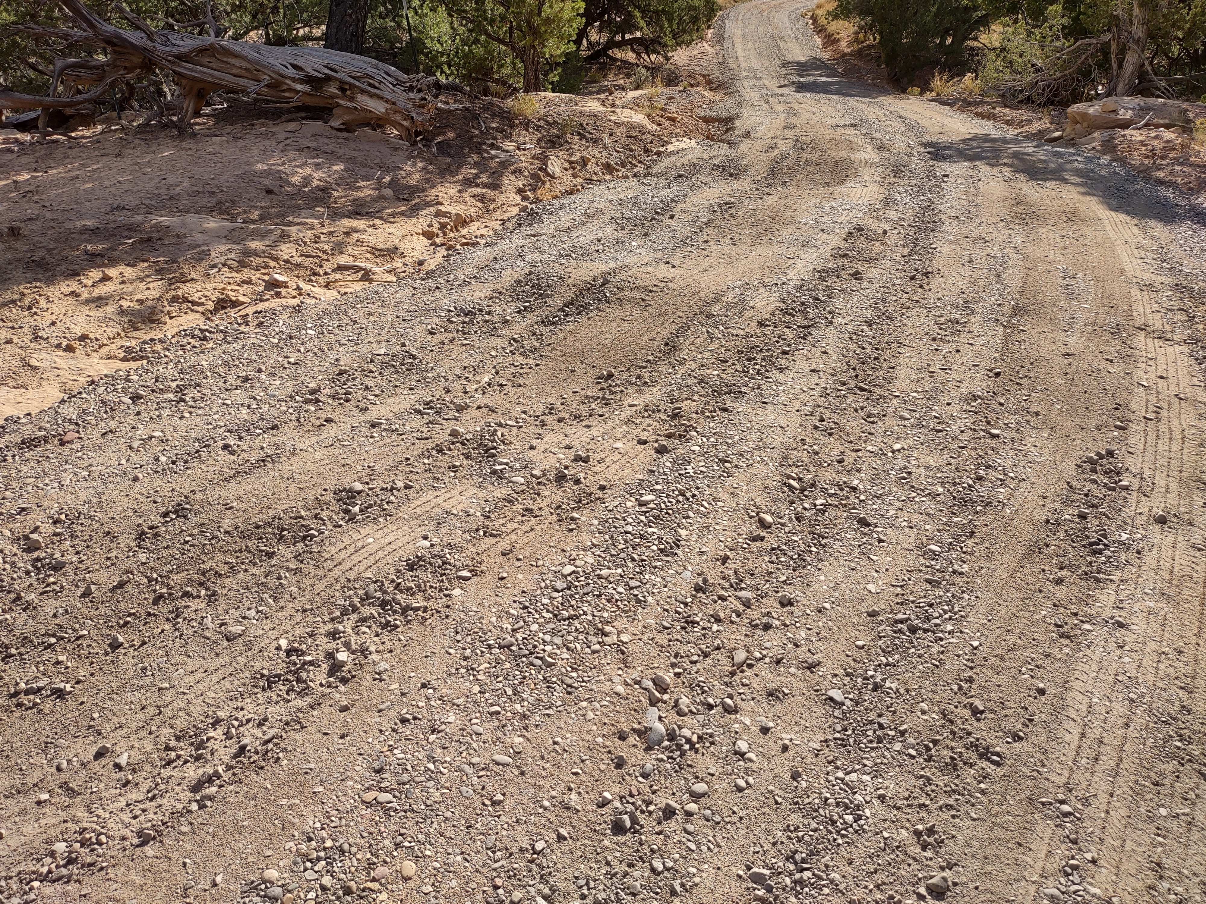

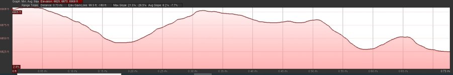

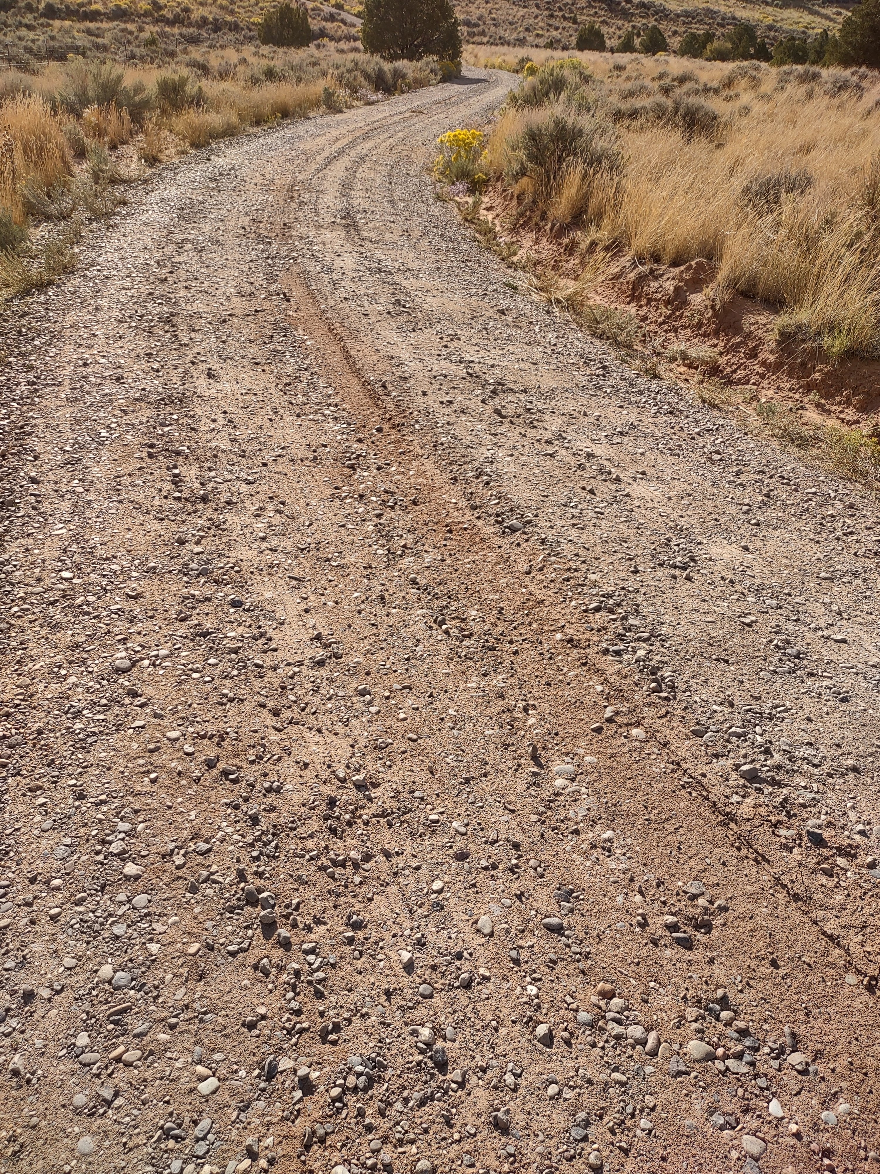

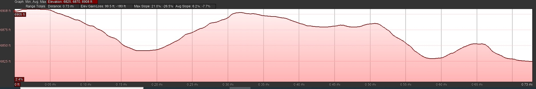

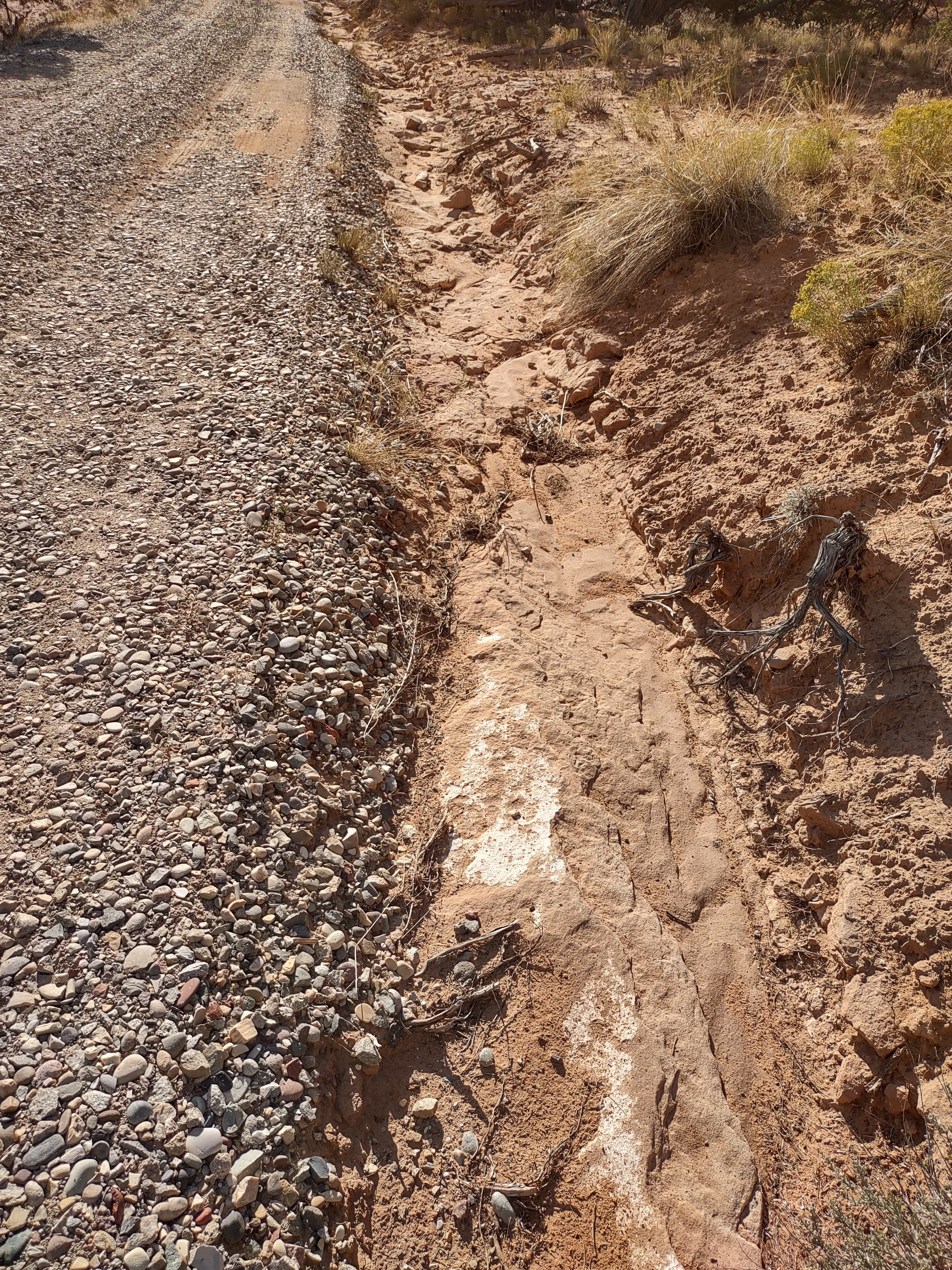

Here are some pics that show the road/materials and current condition. I also have a profile pic of some of the road that shows the gradient (it's not to scale though).
There are a few curves but nothing too sharp. A medium duty semi and trailer can get in without having to go too far off the road to make the sharper corners.
The road appears to be constructed from gravel (the wrong kind) over silt/clay soil and under the road in some places there is a soft sandstone bed rock. Other places the soil is deeper before you get to the bed rock.

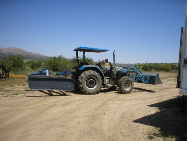

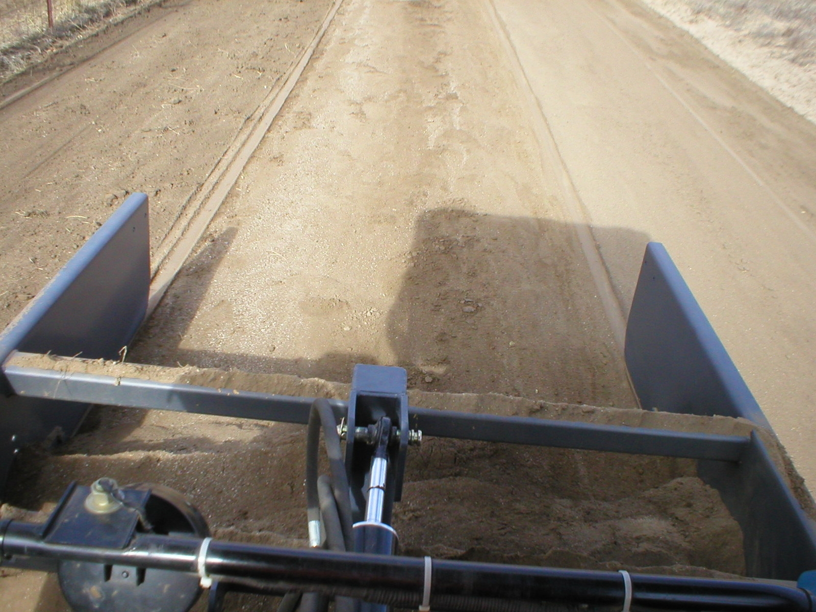

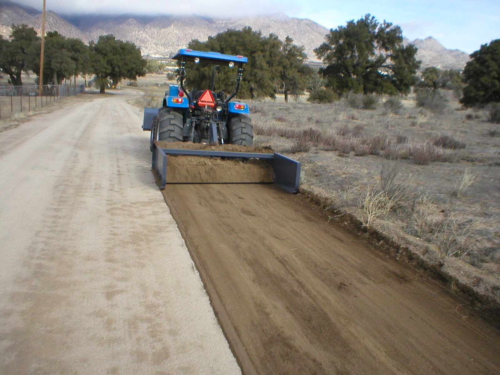

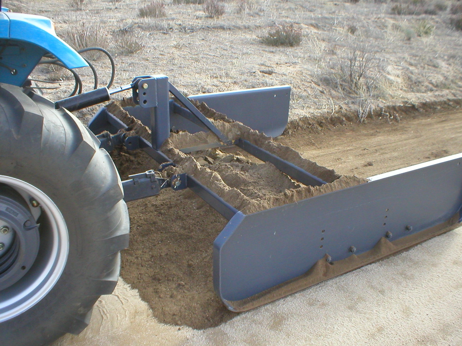

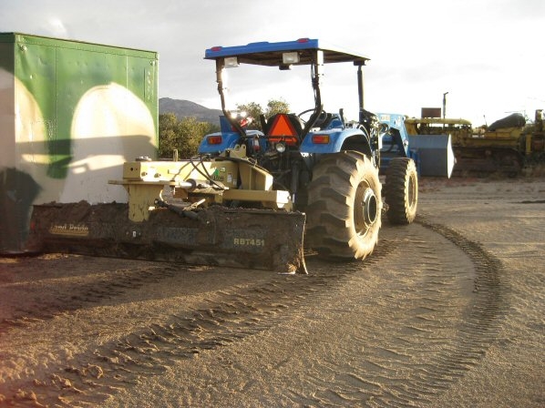

The Road Boss that you have linked to would be the unit that I would be getting if I needed another one. You don't need scarifiers for your type of road and the weight of that LPGS. (landplane grading scraper) Mine is a 7-feet wide and 8 feet long and has worked well for me.
When you are looking for a rear blade, I highly advise that you get a 9-footer. Be sure to look at the specs, while all the manufacturers of these (true heavy-duty rear blades) at 1000lb plus are similar and all of them should work well, they DO NOT all articulate the same amount. Some tilt more than others, some offset more than others, and some don't even angle 45*. :oops:
All things that should be considered when shopping.
My Land Pride RBT45108 angles 45*, tilts 15* and offsets 35".I have never used the blade tilt, ever. I use the 3pt hitch side tilt and have never needed anything more.
You might want to consider getting a top & tilt set for the 3pt hitch. :cool:
I have skid shoes on mine and am very happy that I got them. (y)(y)
You definitely need to have all the ballast that you can reasonably get on the tractor. My tractor is about 12,000lbs and if I take too big of a bite, I can end up with the tail wagging the dog syndrome.
Learn how to make use of the draft feature and all of your grading will be much much easier.
Good luck with your decisions. :)

Those pics help a lot. A LPGS would make quick work of that road. Your topsoil is loose enough to respond well. You could also use a rear blade. Perhaps a rear blade would be best. Especially if you live where you will need to clear snow.
