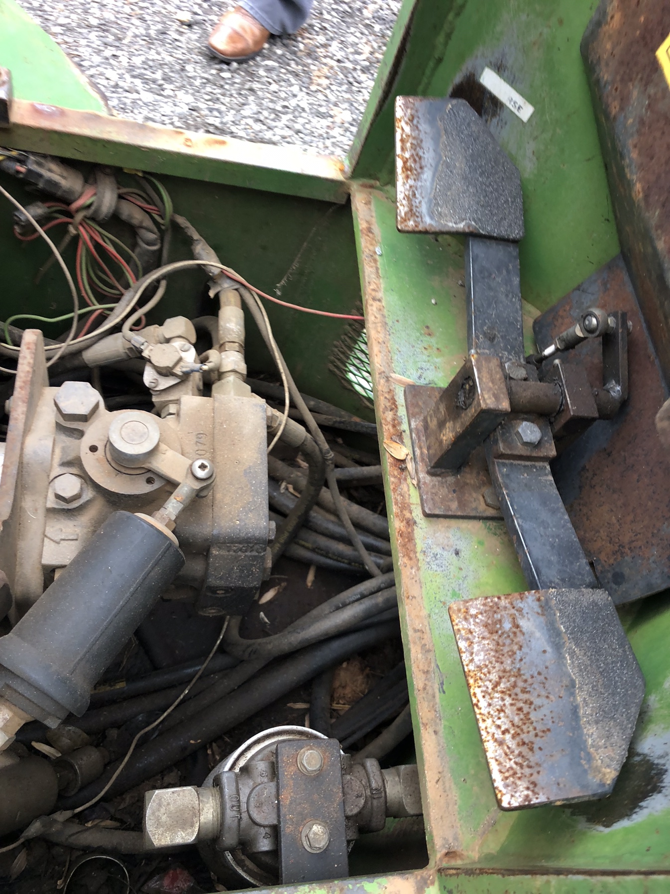

Anyhow, start with a call to Terry to see exactly what your machine is currently configured with, and, if you can, post some clear pictures of your engine compartment and hydraulic components, etc... and that may help us understand what you have in there. :)

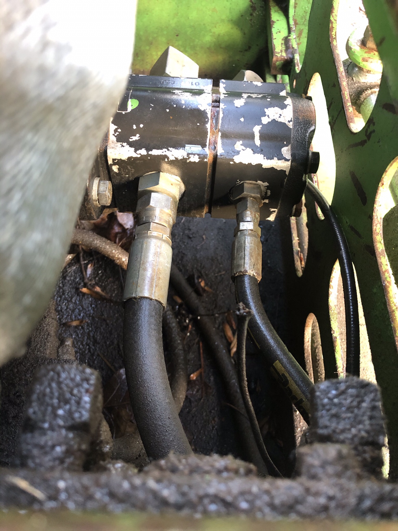

Pics of my pumps
/ What if ....... #5
That looks very similar to mine. The tram pump is on one side of the engine and the MAIN PTO and AUX PTO pumps are on the other. I see you have the hydroback cable that operates the treadle like mine as well. The MAIN PTO pump section is the one with the larger hoses and the AUX PTO pump is the one towards the rear with the smaller hoses.
All 3 pumps are always on with these machines. There's no way to disengage them.
The tram pump has a swash plate that is in a neutral position when the treadle is centered. Therefore, it isn't pumping fluid to the wheel motors. But it is circulating makeup oil all the time as I understand it, to and from the hydraulic reservoir.
The two sections of the PTO pumps are always circulating as well. The AUX always provides flow to the steering valve, then through that valve, out to the FEL valve bank, then back to the hydraulic reservoir. The MAIN always pumps from the reservoir through the pump and back to the reservoir until you hit the electric diverter switch, which then directs the flow out the FEL arms through the LARGE connectors, through an implement, back through the other LARGE connector, then back to the reservoir. If you have no implement on the LARGE connectors and flip that electric PTO switch, it will immediately open the bypass on the electric diverter valve and may kill the engine. You don't want to do that very often, as it's not good for the system. Also, if the MAIN pto electric switch is left in the ON position, the tractor should not be able to start. It'll act like it has a dead battery and nothing will happen.
Ask me how I know this??? :laughing: I've done it a couple times myself and immediately get upset because the machine won't start. After I think about it a couple times, I flip the PTO switch to OFF and the machine starts right up.
So do yourself a favor, and make checking the PTO switch is in the OFF position part of each startup sequence before you turn the key. Good habits reduce mental stress. ;)

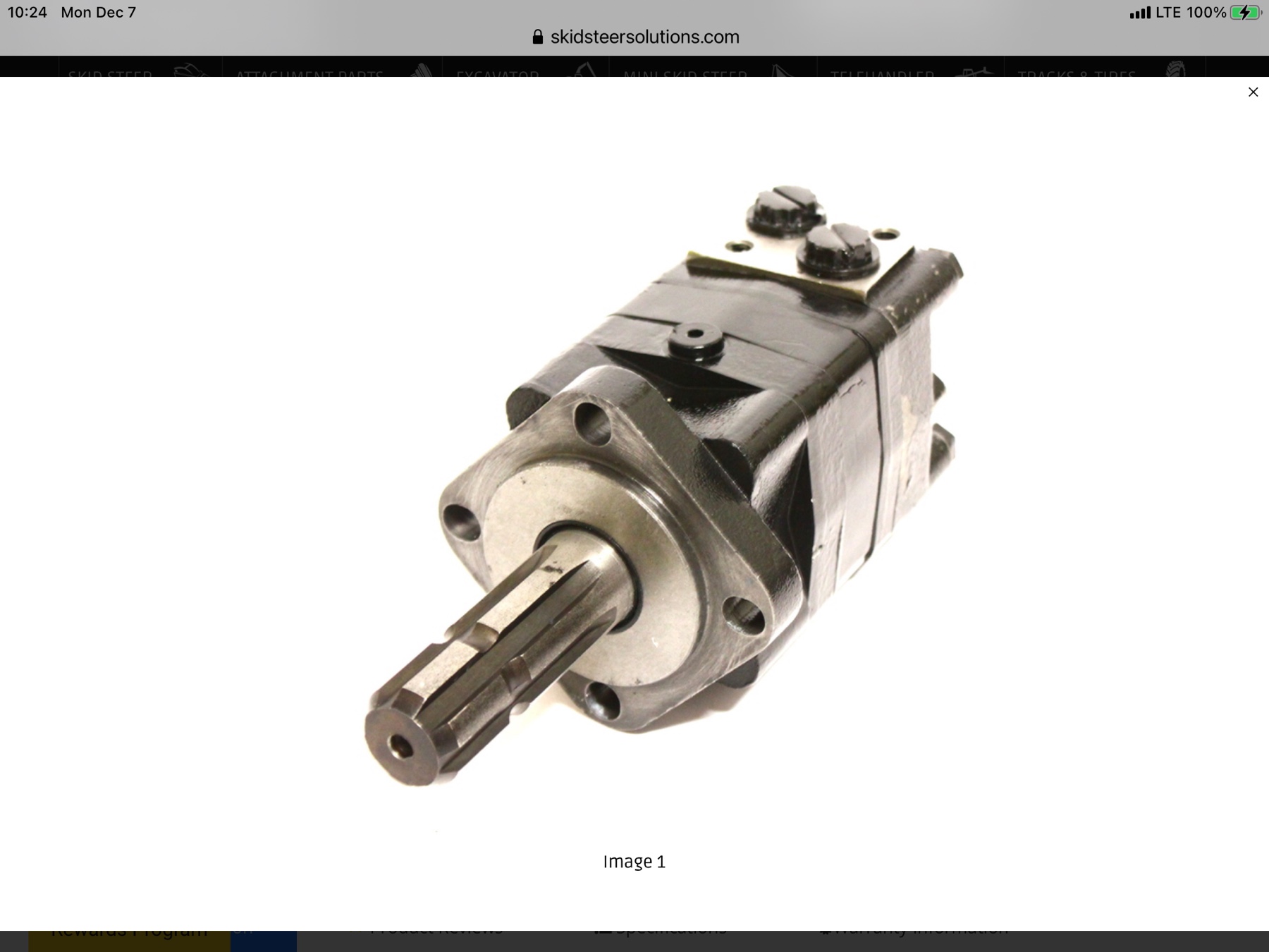

I am wanting to use a pump like this to run three point attachments on a fabricated three point quick attach rig for my PT.
The reason for this is I have several small tractor implements and wish to continue using them instead of parting with them I like the idea of adapting rather than selling all I have only to buy more.... .IMG_0872.JPGIMG_5703.JPGIMG_5624.JPG
/ What if ....... #7
Use a pump like this to run three point attachments on a fabricated three point quick attach rig for my PT.View attachment 678996
That's not a pump. That's a motor.
Some people have talked about using a splined shaft like that to operate standard 3PT implements on their PT's. I think one or two might have. I cannot recall which member(s) did that.
The concerns are getting a motor with the proper displacement to run the implement at 540 RPMs (the standard RPMS of tractor PTOs), with the Gallons Per Minute that your machine puts out. Then there's the problem of matching up a driveshaft and linkages and fabrication of brackets to hold that motor to the implement, etc....
Most folks have concluded it's easier to skip the splined motor, drive shaft, brackets, linkages, etc... and adapt a properly sized hydraulic motor directly to an old 3pt implement with a lovejoy connector and power it with hoses from the MAIN PTO.
This is exactly what PowerTrac does with it's implements. Each implement has it's own hydraulic motor and a quick attach plate. It makes things so much easier.
If I were going to adapt a 3pt implement to use on my PT425, say, a snow blower, for example, I'd just figure out the RPMs I want the blower to spin at, and find a hydraulic motor with the proper displacement to achieve that RPM at my given 8 Gallons Per Minute that my 425 can produce. Easy peasy. ;)

Well, I don't know if it helps, but I did fab up a PTO splined motor to fit a wood chipper designed to run on a 3-point PTO drive. It is pretty straightforward to do, just use a hydraulic motor calculator to work out what would be 540rpm near your max gpm, and make sure that the motor can take the pressure of your PT hydraulics. Do double check that the net horsepower is what you need.
You could certainly make a QA plate with a hydraulic PTO motor on it with a 3-point mount to be able to run many different powered 3-point hitch implements. One thing to consider is how much weight you are adding, second, how far out the implement is going to end up (I am thinking about center of gravity, turning, and maneuvering) by the time you have your FEL, the QA plate, and the three point system.
For me, a one off, with no 3-point hitch and a PTO motor permanently just to the wood chipper made good sense for me, as I knew that I wasn't going to need to power a bunch of three point attachments, and I could put the QA plate near the center of gravity for the chipper, and bring the chipper center of mass close to the PT. A real 3-point hitch would have put the weight of the chipper about four feet out from the QA plate, which wasn't going to work for me.
