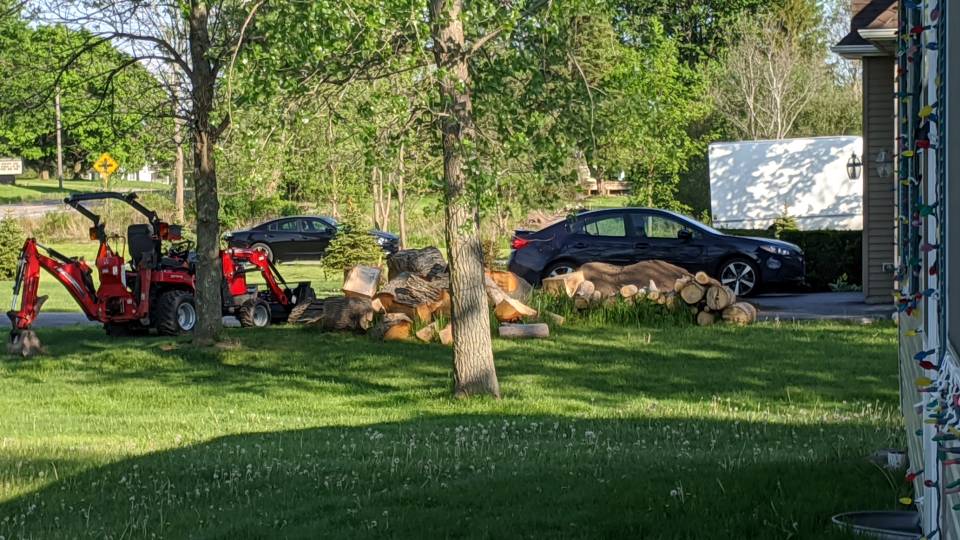

in the first pic what is that bar going across your lift arms?
Looks like he's just using the backhoe sub frame and some bungies to hold back his lift arms VS pinning them back with a black bungie cord like it comes from the factory
looked to me like a bar going across both and bungee attached to each to holds them up but....I am often wrong so... LOL
I think the bungies are to prevent rattling and to hold them tight to that pipe. The pipe has 2 pins in it to the inside of the sub frame that keep it from sliding out of the eyelets

Yep, sounds like an "all of the above" deal... As I rarely use the 3-pt hitch but use the MMM all summer long, I slid a piece of EMT in the BH mounts so the 3PH arms could be held out of the way, but far enough back that the hydraulic lift arms would also have clearance to go up & down as the MMM is raised & lowered. (3PH top link is removed.) Note that each time the MMM is moved, those hydraulic lift arms on the 3PH also move.
With those arms in the "normal" bungeed-up holes in the fenders, I found that the 3PH hydraulic arms could sometimes either hit the arms or possibly pinch a BH hydraulic hose. Bungeed to that EMT, they're safe (& quiet) but still out of the way.

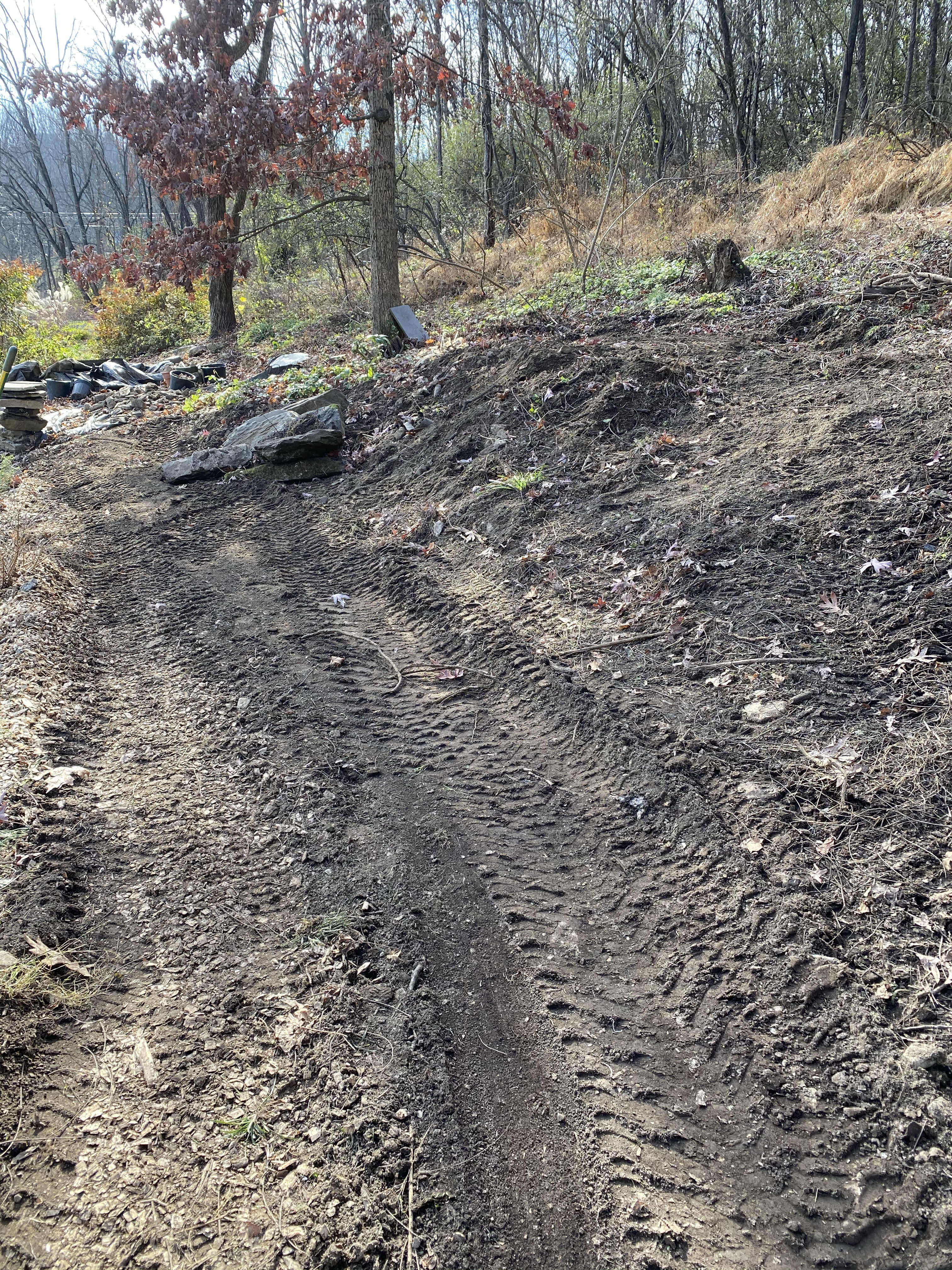

Got my arse kicked to day by an extremely challenging (hilly) property for a customer.
Managed to create the path she wanted, moved about 3 tons of wall stone and 1 ton of modified. Did a bunch of small area grading and dug a few holes.
The area above the path (upper right) was supposed to be a small, flat flagstone patio and without being able to cut in a “road” to get to it that slope kicked my arse in circles.

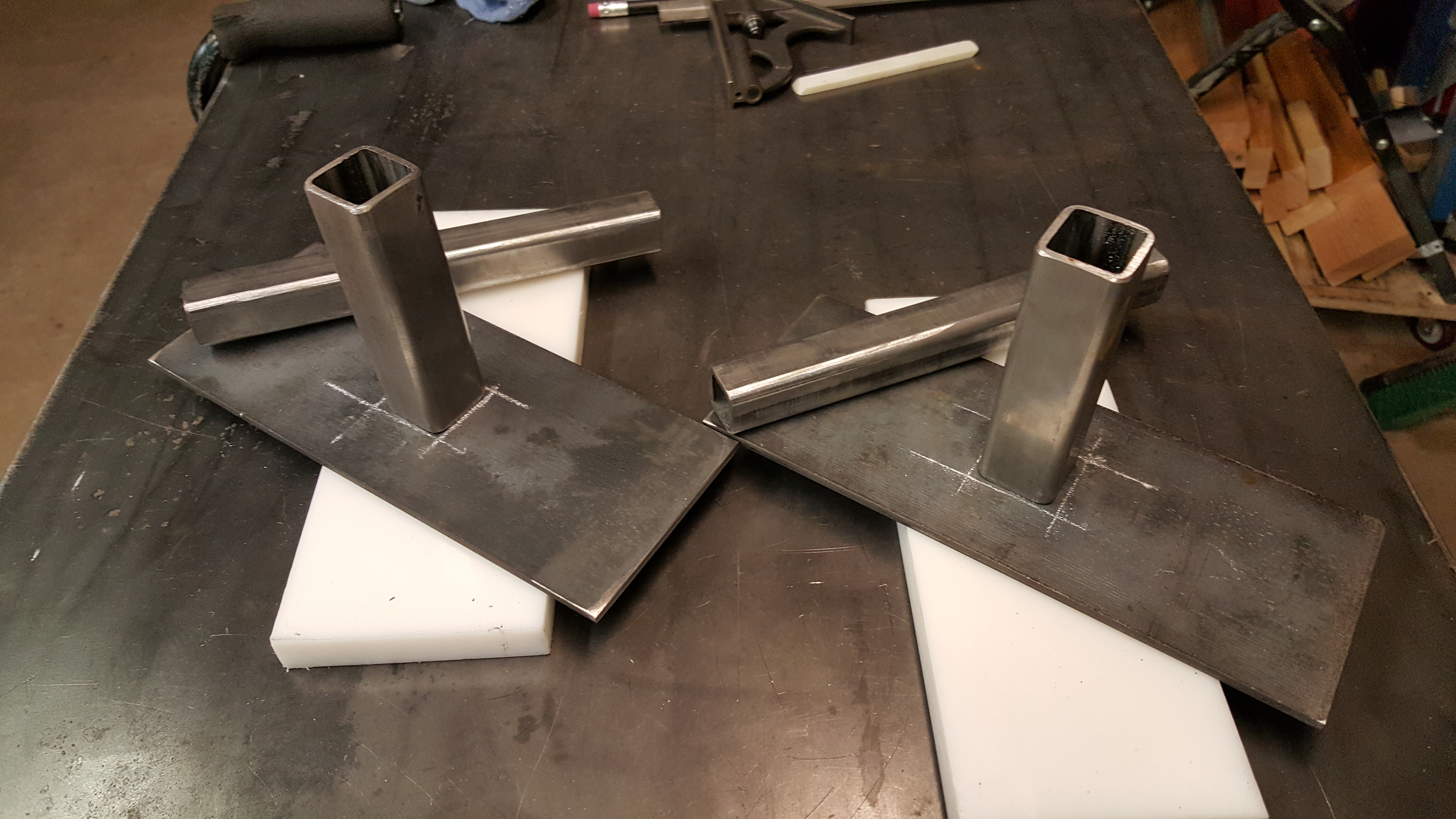

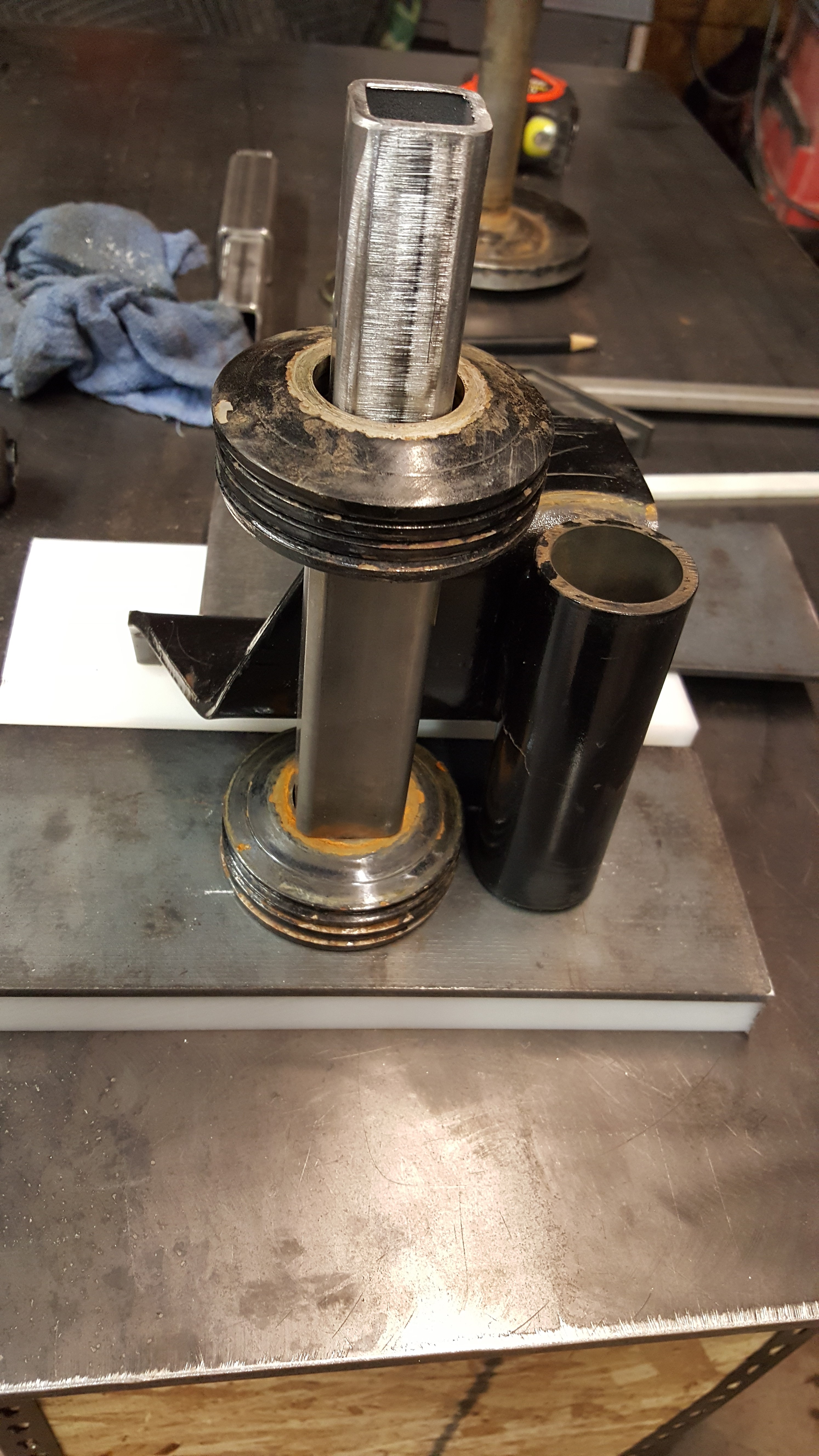

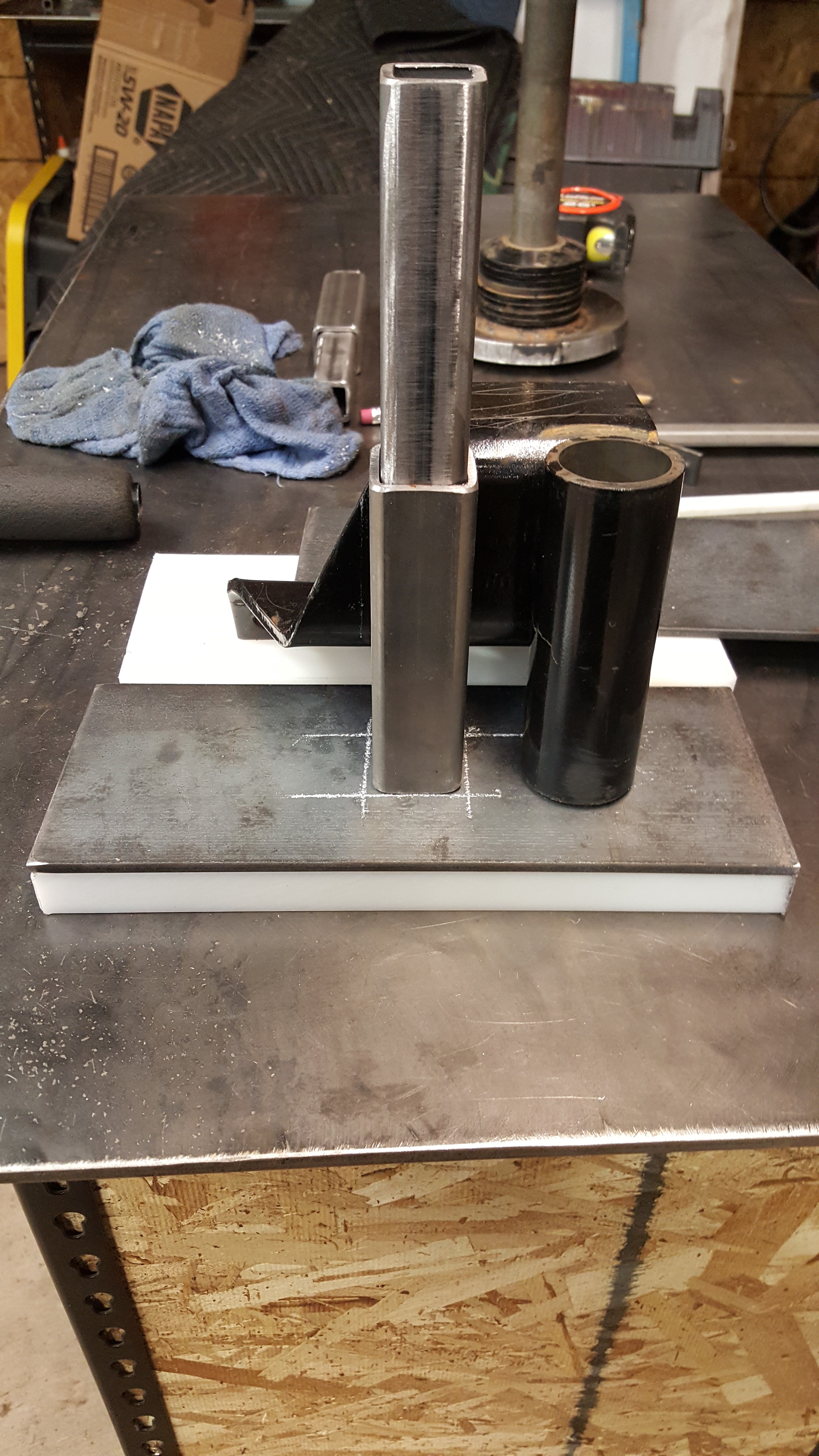

Update on my Dozer Blade UHMW skid shoes:
Well it warmed up to 20F today so working in the garage I believed I have figured out how I'm going to fabricate my new skid shoes using materials I have in my small metal rack.
By removing the 2 outer nuts for the scraper blade, the existing shoe brackets can be removed completely from the back of the Dozer Blade.
I'm going to cut a piece of square tubing 1..25" x 1.25" x 1/8" wall about 4.5" long, clean up the inside so the new square tubing 1" x 1" x 1//8" skid shoe will slip up/down when inserted.
I will weld this new 4.5" long tubing to the existing skid shoe bracket next to the existing round tube on the bracket.
Then I will cut a new piece of square tubing 1" x 1" x 1/8" wall about 9" long and weld one end to a new piece of 1/4" x 4" flat bar that's 10" long.
This new piece of flat bar will have the UHMW cut piece, 4" x 10" which will be counter sunk and fastened to the bottom of the flat bar.
This existing skid shoe spacers/washers will slip over this new square tubing and will function with the same vertical adjustments as the existing skid shoe.
By using square tubing instead of round tubing the new skid shoe will be fixed in place with no rotation of the shoe.
And by being able to use the existing spacers/washers makes all of the vertical adjustments just as easy as before.
The existing 6" diameter skid shoe has a 28 square inch surface area, and the new skid shoe has a 40 square inch surface area, which I think will make a difference.
So far this is "Plan B" and during my fabrication I just might be going to "Plan C", might increase the surface area to 6" x 12" (72 square inch surface area), or somewhere in between.
Here's a little sketch that may help others visualize my new skid shoe better:

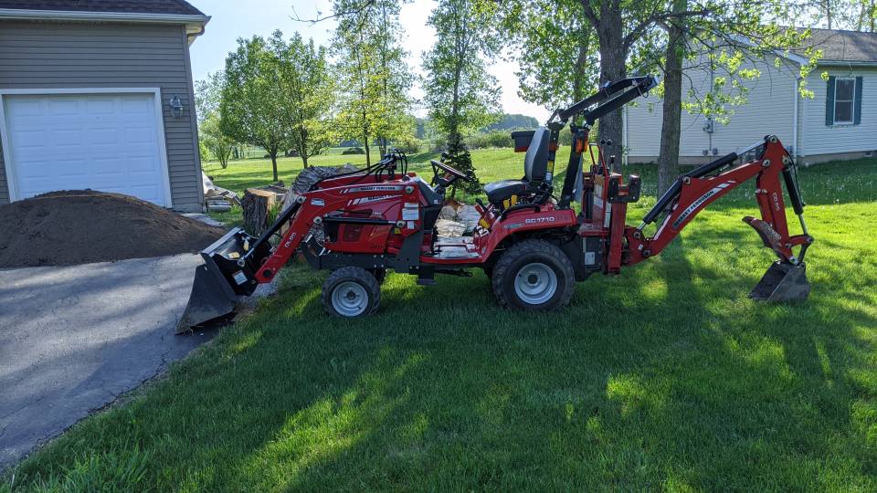

Picked my tractor up yesterday. Got the tail lights flipped around to the inside of the rops this morning after a trip to the hardware store.

Gene, here's a look at my progress with the UHMW skid shoes for the MF 2340 Dozer Blade (previous post #671 & #672).
I cut all of my pieces yesterday and plan on welding/assembly the parts today.
Pictures of the parts:

I’m just gonna drive from PA to MT and collect blowers and plows from members along the way for you to modify! Drop them all of in the spring and pick them up on the fall.
(Nice work)

Thanks, but you'd be wise to wait and see if it's going to make a difference and an improvement for my gravel driveway every year just before the winter freeze.
Been thinking about this modification for quite a while and I never know when the light bulb "idea" helps me out, good and bad I'm afraid...
For a update, the parts sit like in the pictures and maybe tomorrow I'll get to this project again.

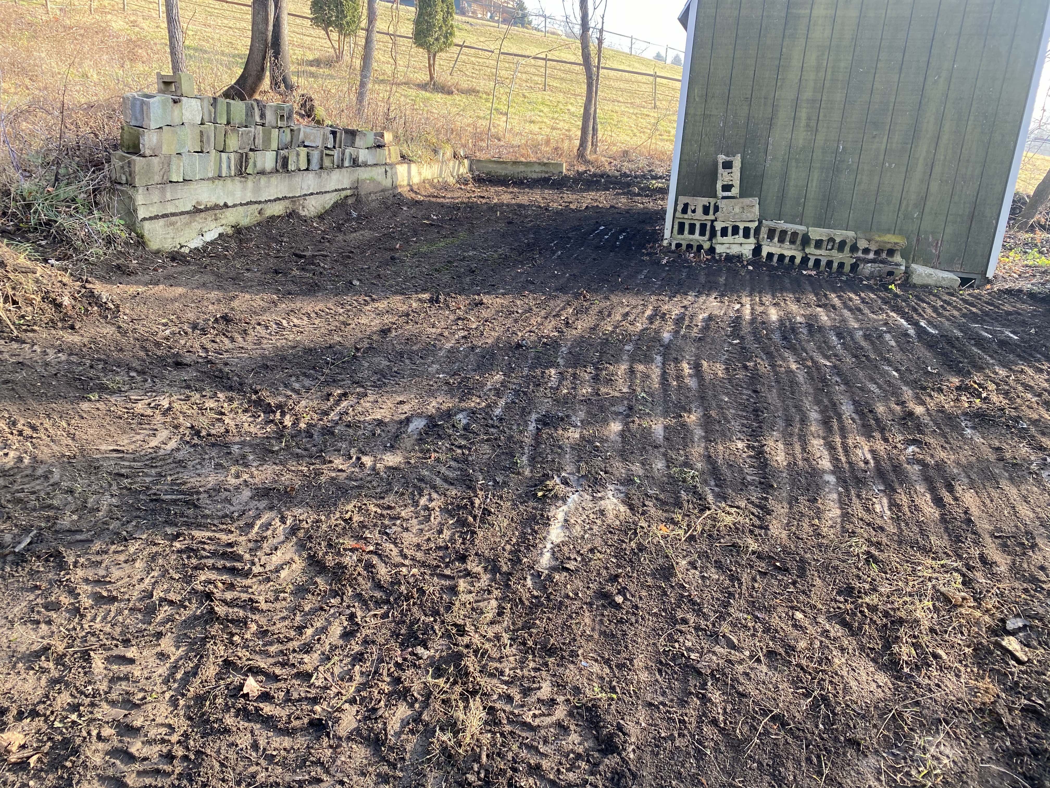

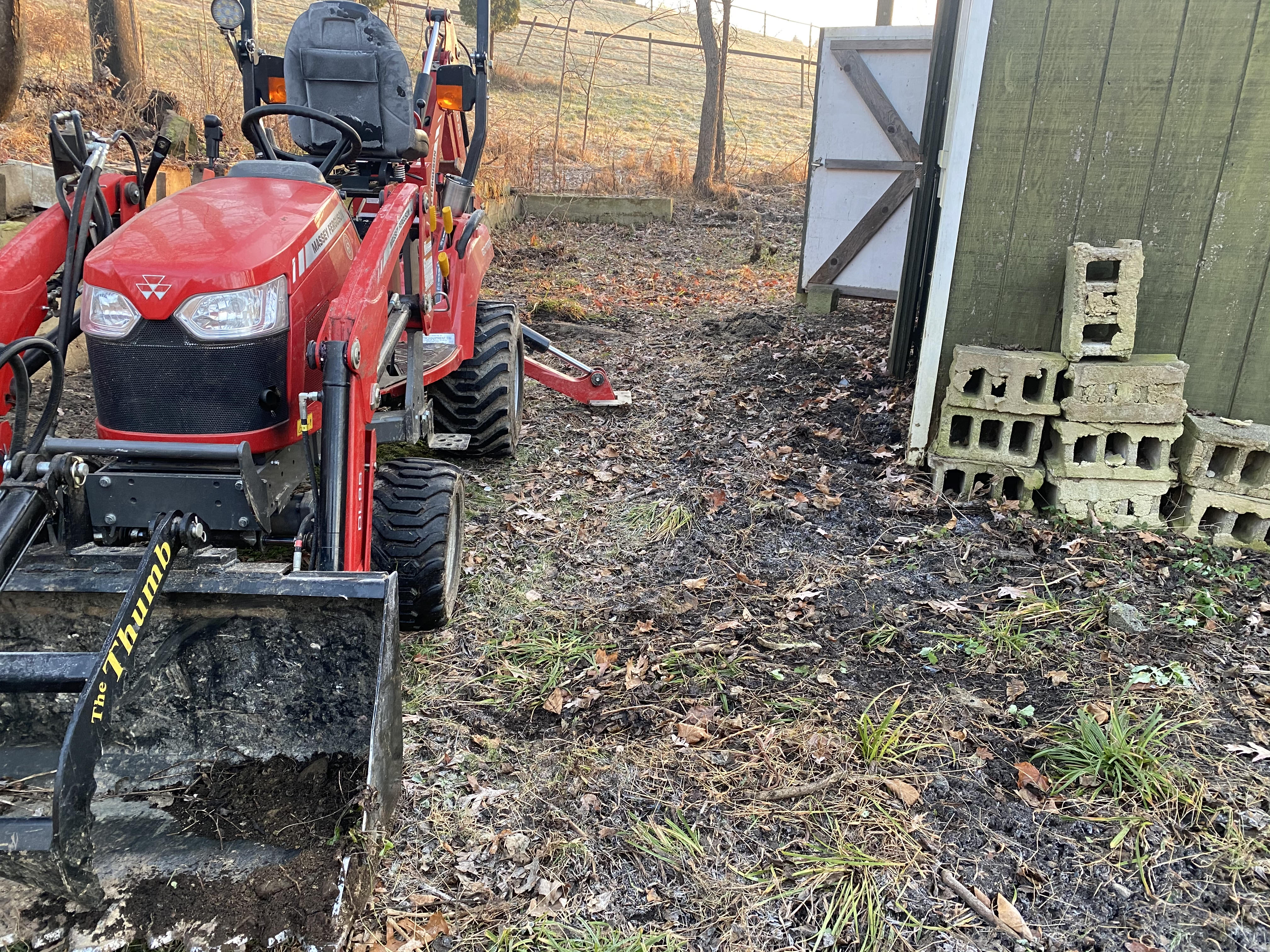

Busy two days, last jobs of the year.
Bunch of small area grading and moved a bunch of rubble for one customer.
Driveway surface for another.
