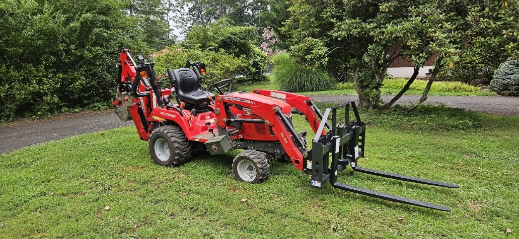

Bought the Massey a present:

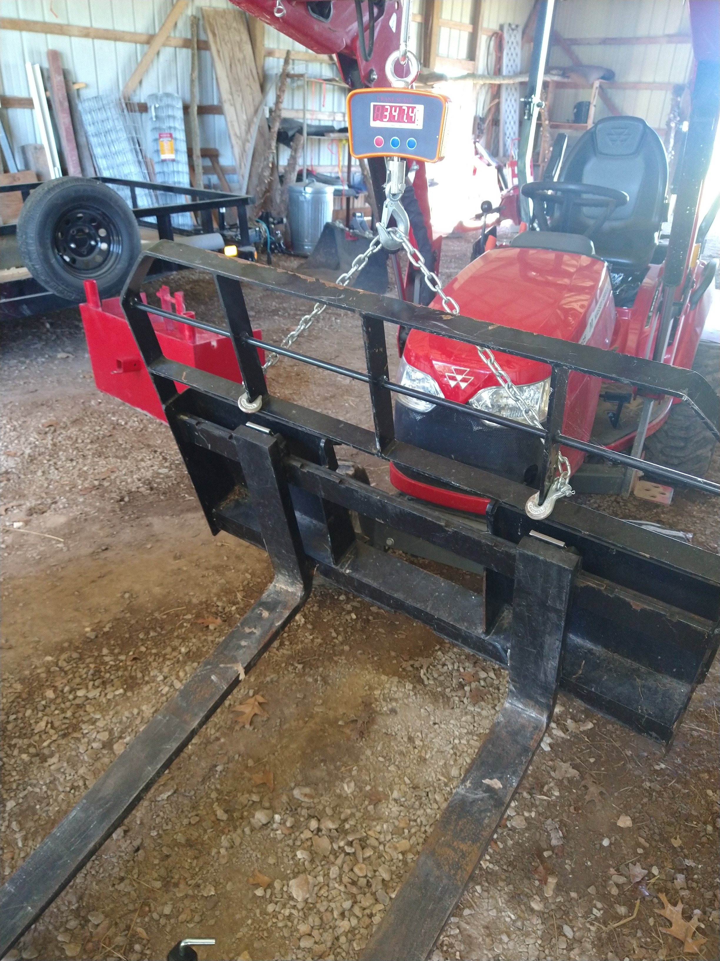

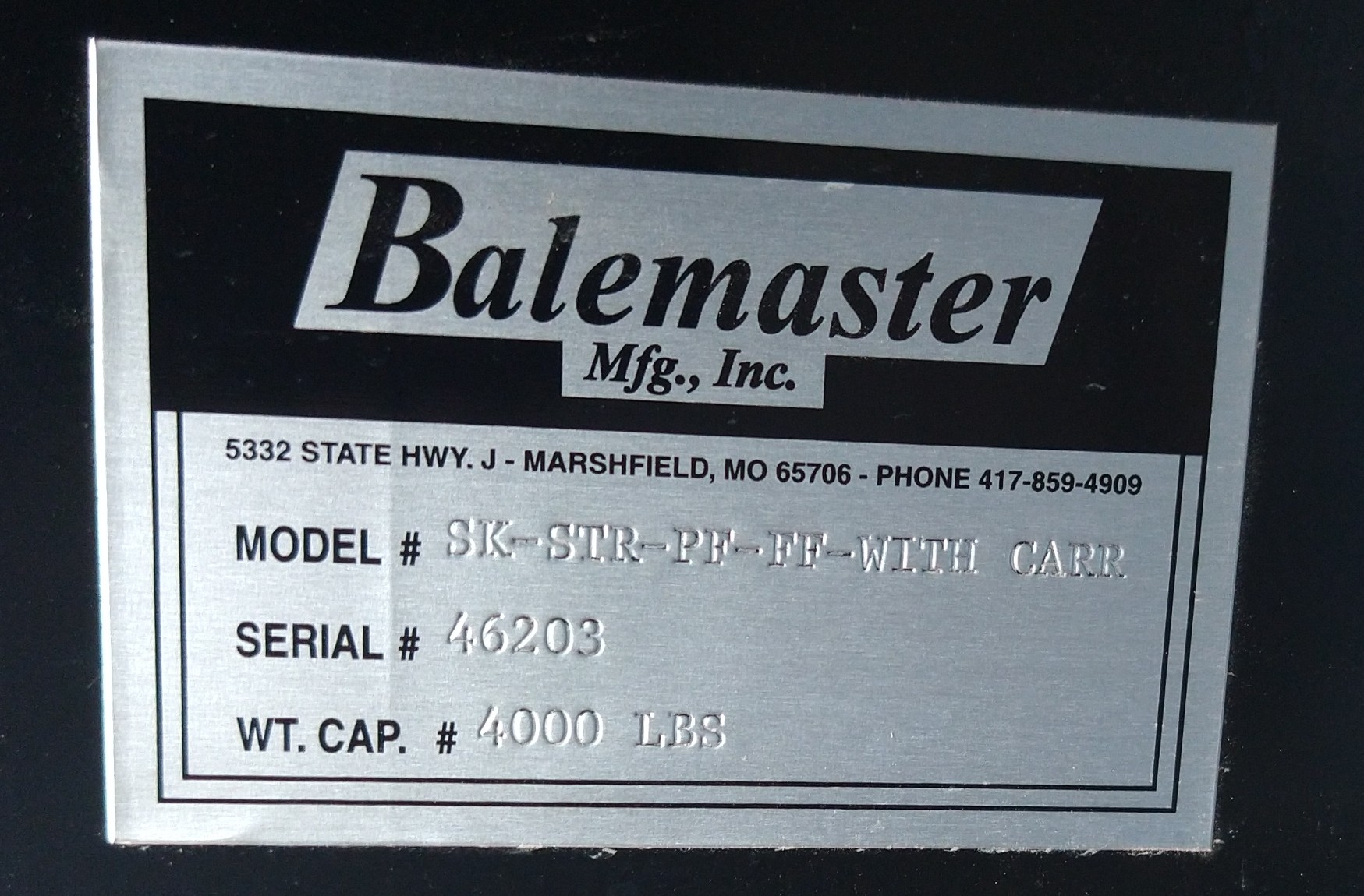

By the spec sheet the Massey will out lift a BX ... My 42" forks are rated for 4,000 pounds (all I could source at the time!)
But they're heavy!
That looks heavy, does it still have the power to lift some decent weight?
Forks+frame 325 pounds, supposed to be able to lift 4000.
I only will be doing large branches to keep within the actual MF lifting limit though.
   / What have you done with/to your GC Series 2300, 2400, 1700 Tractor TODAY #2,869
The loader capacity is what I was referring to.
At 325# looks like you can lift about 500-600 lbs., with those forks, give or take.
Less, if the load is on the tips of the forks. Because it could tip.
I'm wondering how useful that ends up being, in actual conditions?

My GC is a 2610 TLB I made my own brackets that use forks as well as other things. My semi quick attach with forks weighs about 50 lbs. and still wish I could lift more. No, my forks aren't adjustable but they fit all pallets I've tried them with and had no problems with other things due to the spacing. I tested each fork to 1000 lbs. before construction. Those forks need a bigger machine but if they do the needed work they are OK.
