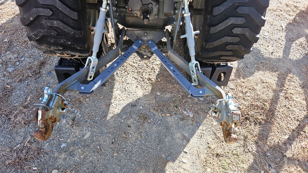

added a stabilizer kit to rear to replace turnbuckles, same as @hube2 uses.
I tried those too Dave, and they work great with a fairly level implement. But I had a problem with them while using my back blade and top-n-tilt at a large angle. The reason is that the stabilizers try to follow the angled lower 3-point arms and then the other end at the "plate" gets twisted.
Good luck, Dick

generally don't deal with large angles but the adjustable lift links both sides (also kubota) combined with multiple pin holes where they hook to lift arm should give me all the play I need.I also use pats quickhitch and have enough play there to give room, not bound by the ball in lift arms. but its 10 minutes to swap back to stock if needed :)

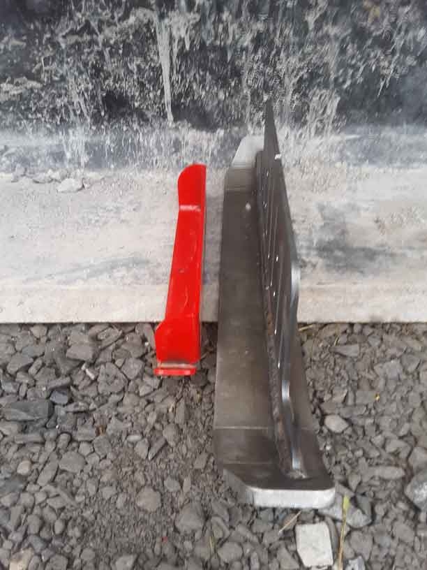

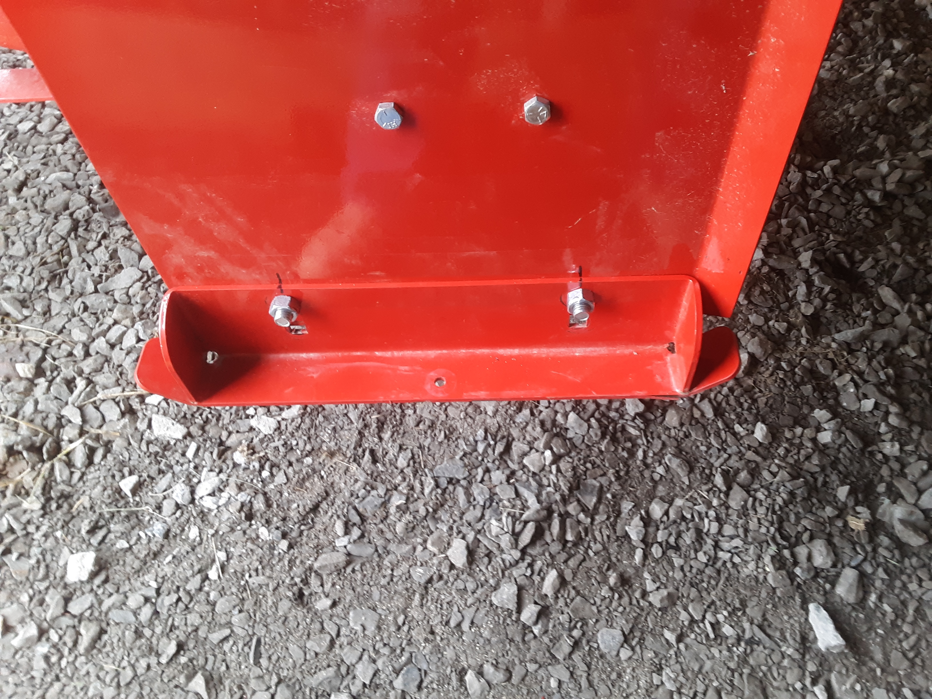

With the ground frozen and having a solid base I have put the original skid shoes on my blower so I can move more snow. Some pictures of the original and custom shoes I had made below.
It's supposed to warm up a bit on Saturday, they are saying high of 35. Hoping it's not for too long and things down thaw and melt too much or I'll have to put the big shoes back on.
Once we get a good base of snow I prefer it if it just stays cold, makes the driveway so much easier to clear without blowing stone and mud.
