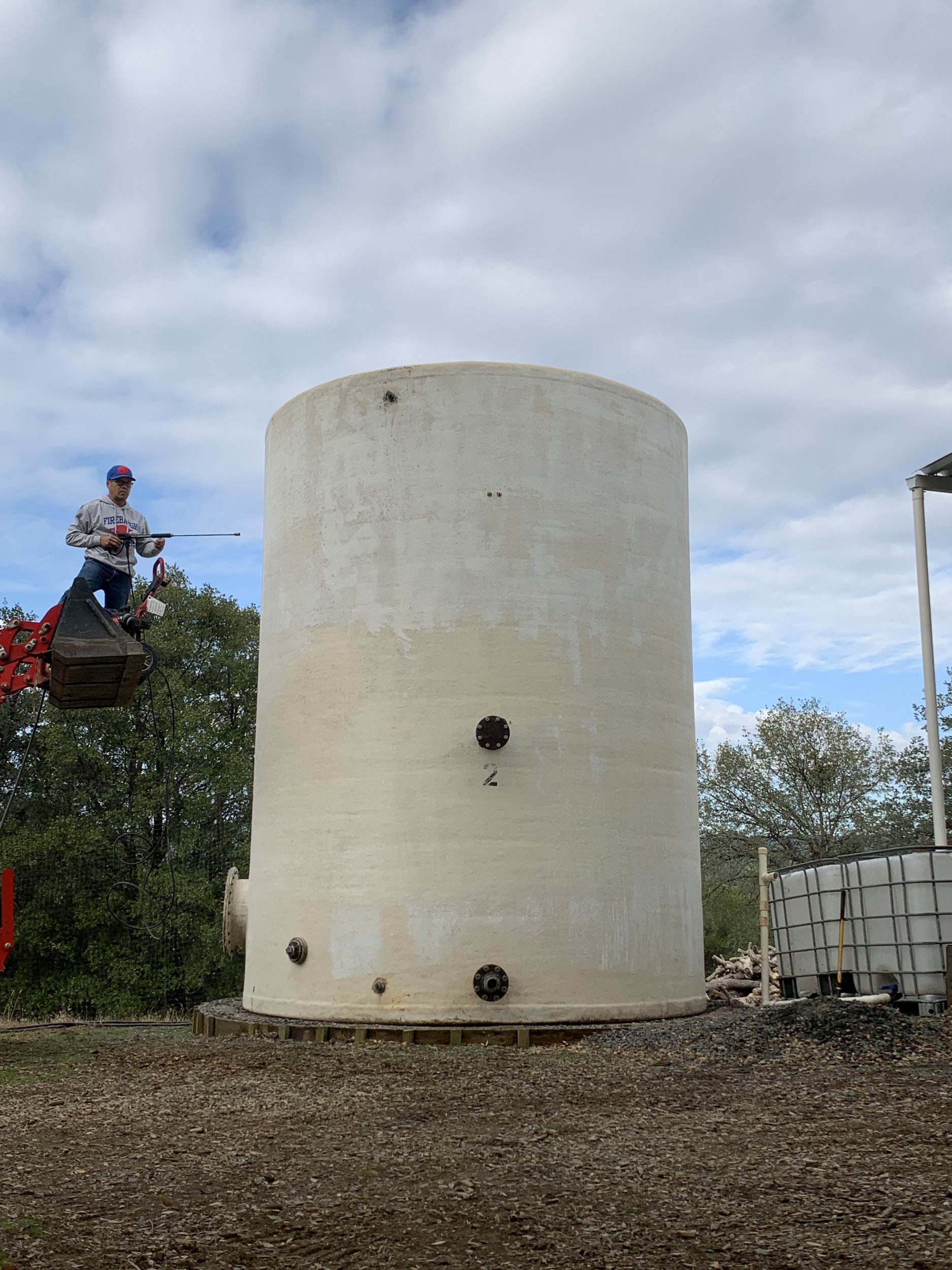

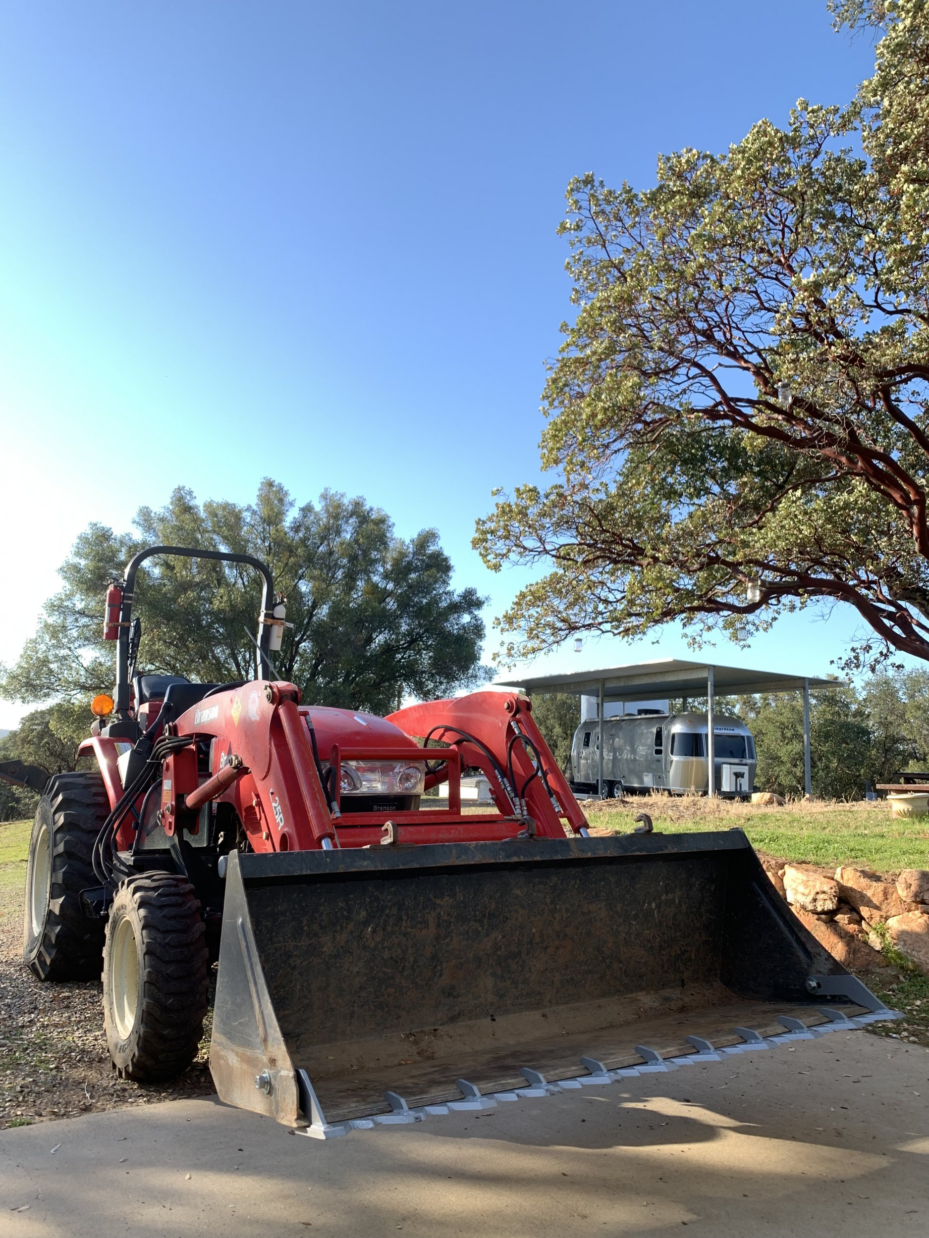

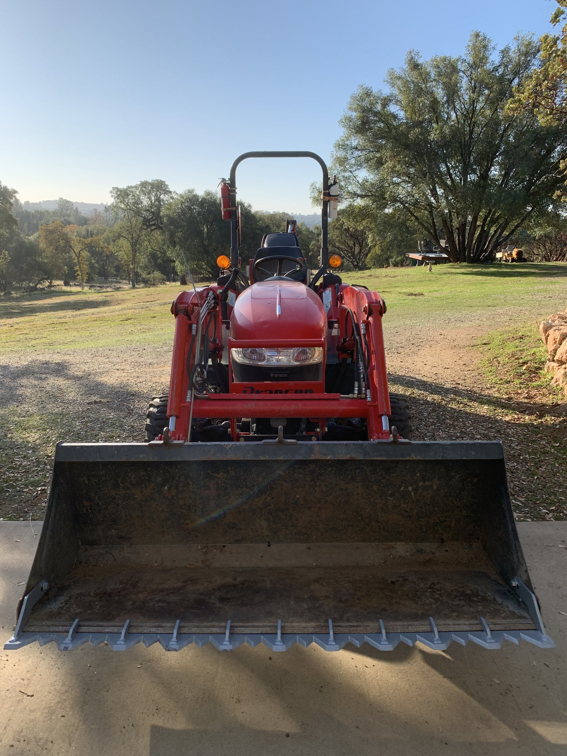

I used the FEL bucket as a work platform for pressure washing. I probably could have worn fall protection.
