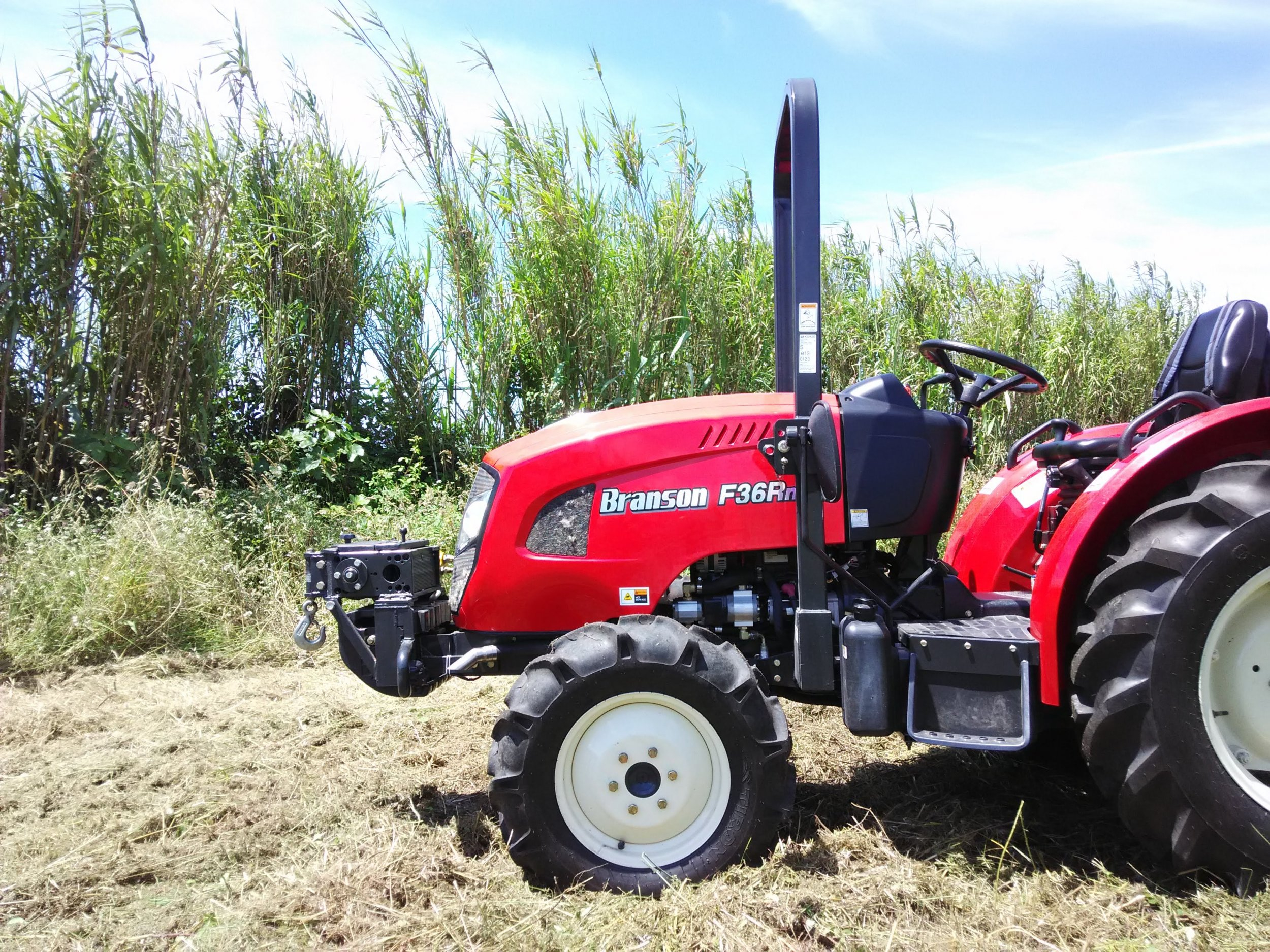

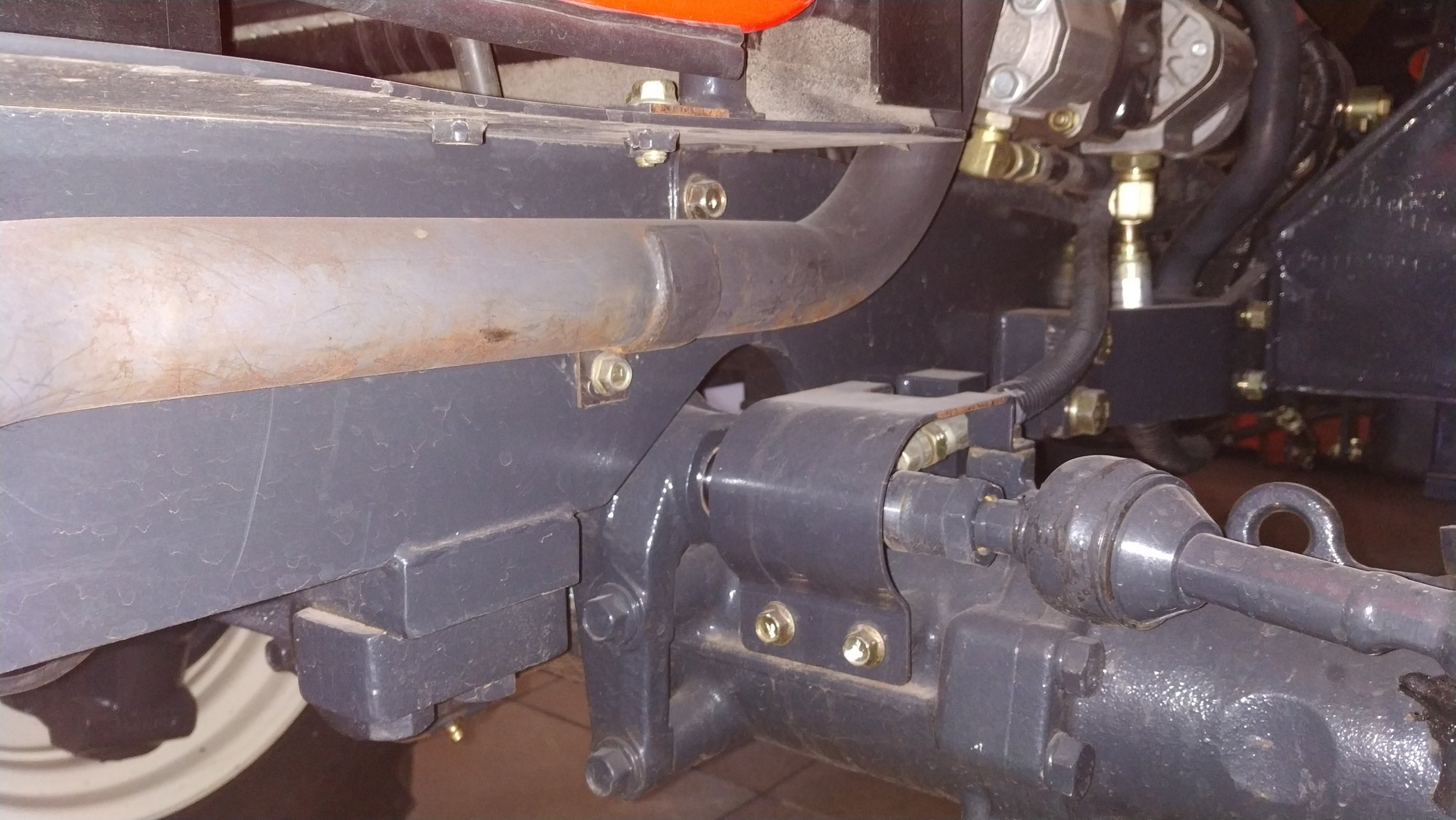

This tractor needs a rt fender grab handle for me to hang onto. There a couple of plugged holes there to use. I find myself grabbing the FEL frame if I mount from the rt side, left is OK as is but could use a grab handle on the left FEL frame too. My largeish butt gets in the way to mount on the rt.
I hate to see Branson getting rid of those small details that put them a step above everyone else. Details like grab handles, steering cylinder covers (saw a post on the FB group about this, I think it was you) and some more stuff I'm forgetting.
My 2017 F36Rn came with a grab handle mounted on each fender and steering cylinder covers. It doesn't came with a right side step but no big deal as I don't mount the tractor from that side anyway and used the holes there to mount my toolbox which filled somewhat fast with only the tool kit that came with the tractor.
Note the grab handles on the fender on the left picture and the steering cylinder cover on the right picture.
