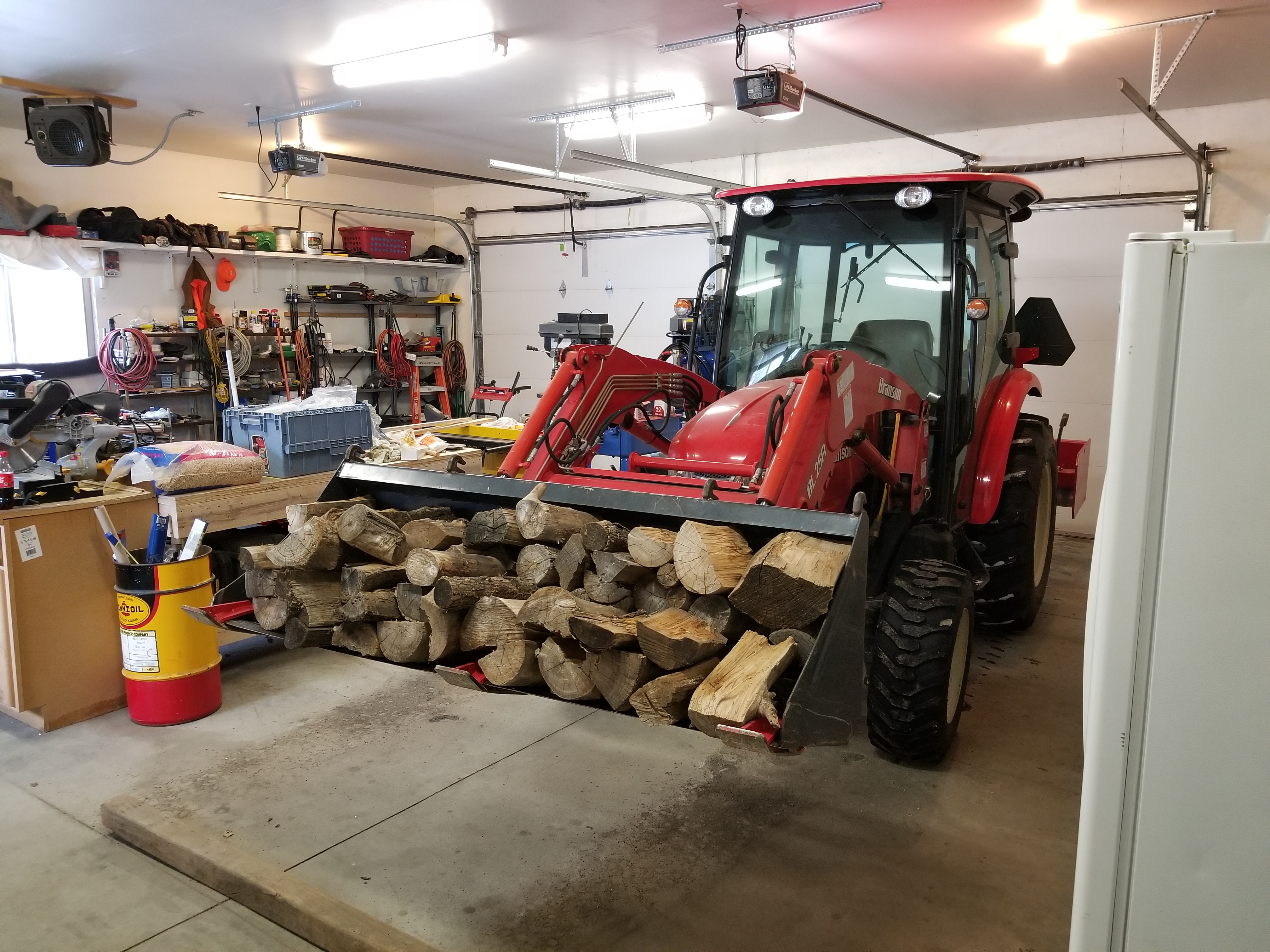

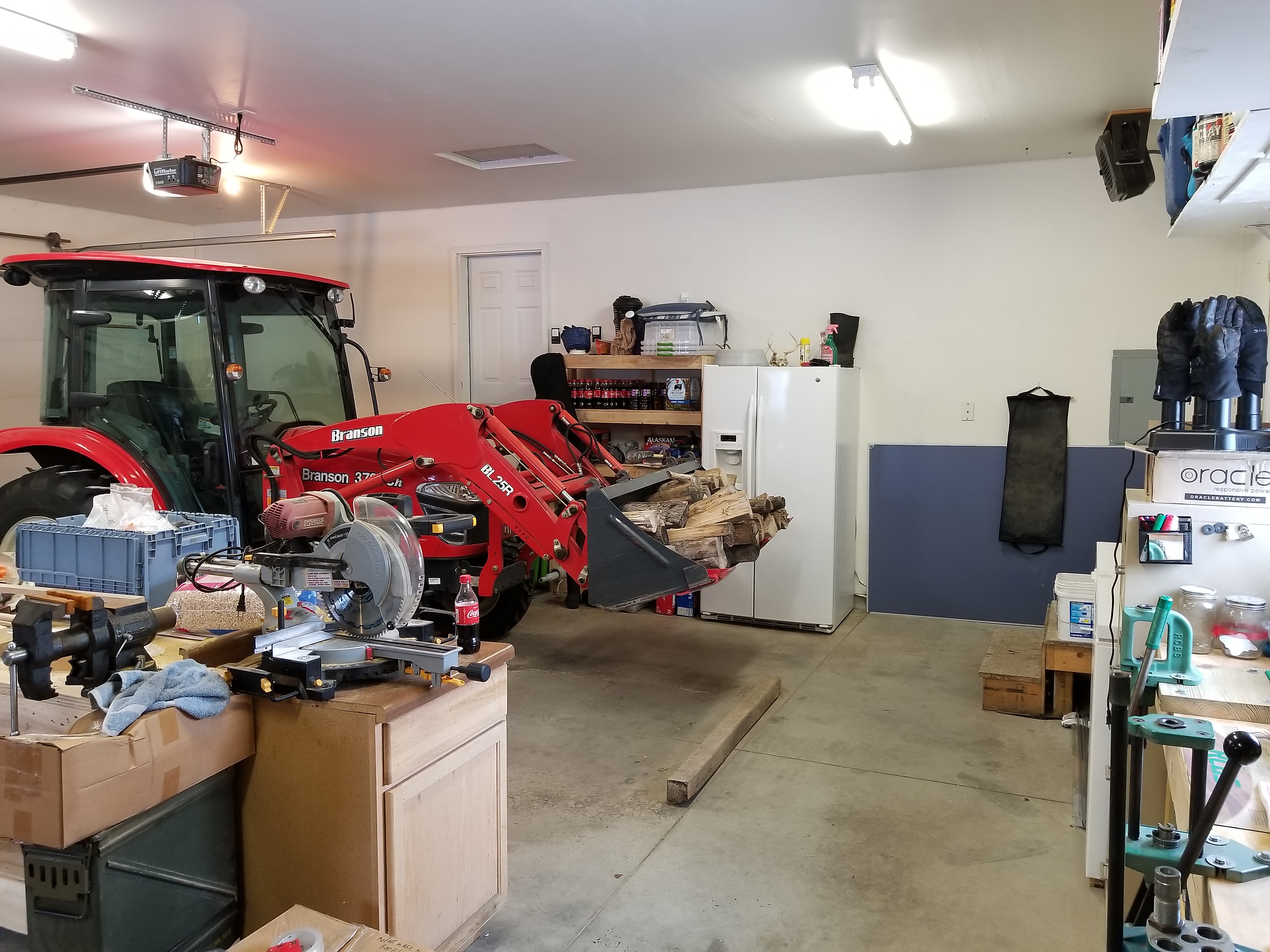

Hardly been using mine at all so far this winter. We've had almost no snow at all. I did start it up and use it to bring some firewood into the garage for Mrs. Slim's wood burning stove.
Nice to have a garage door tall enough I can drive the cabbed tractor all the way inside and close the door to stack off the wood.
So it's basically just a glorified wheel barrow, but it beats bringing in armloads at a time by hand. My tractor sure has had a lazy 6 months so far, that and a new indoor parking space.
I worry it's going to end up getting spoiled and lazy (like me).

It looks like it clears the garage door by an inch (LOL). Having any luck finding reloading components? B.

I haven't measured it, but it's pretty close.
