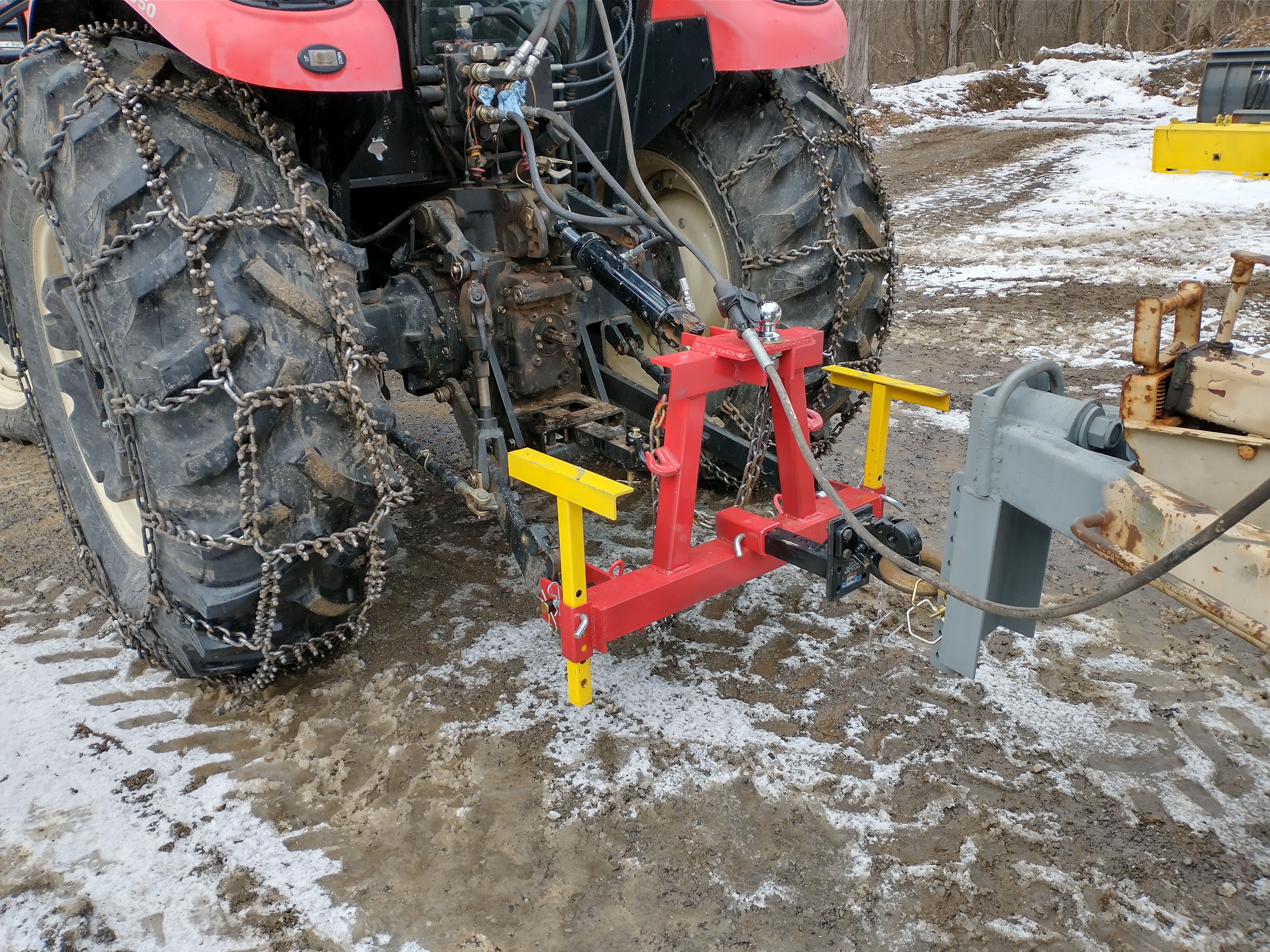

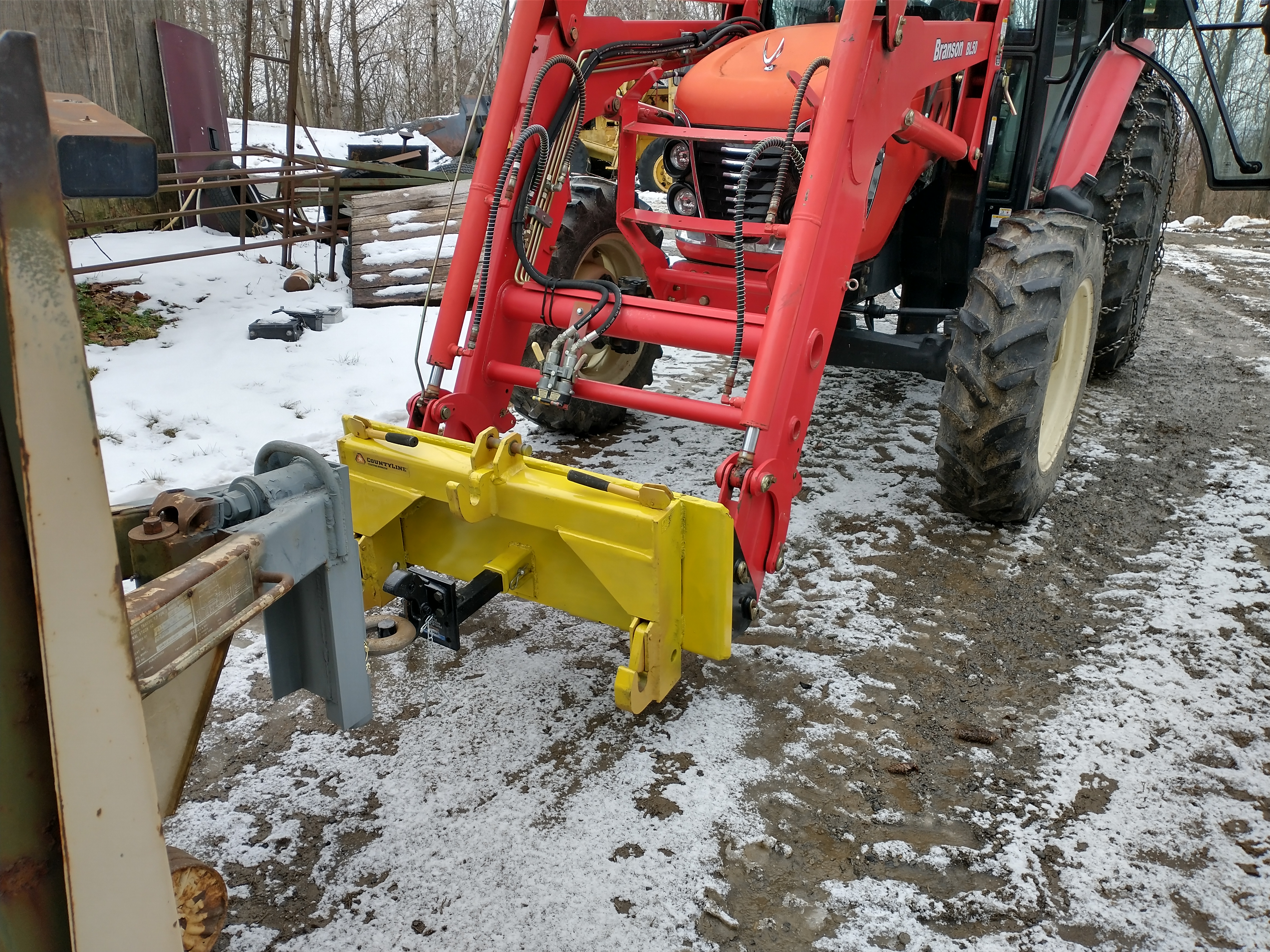

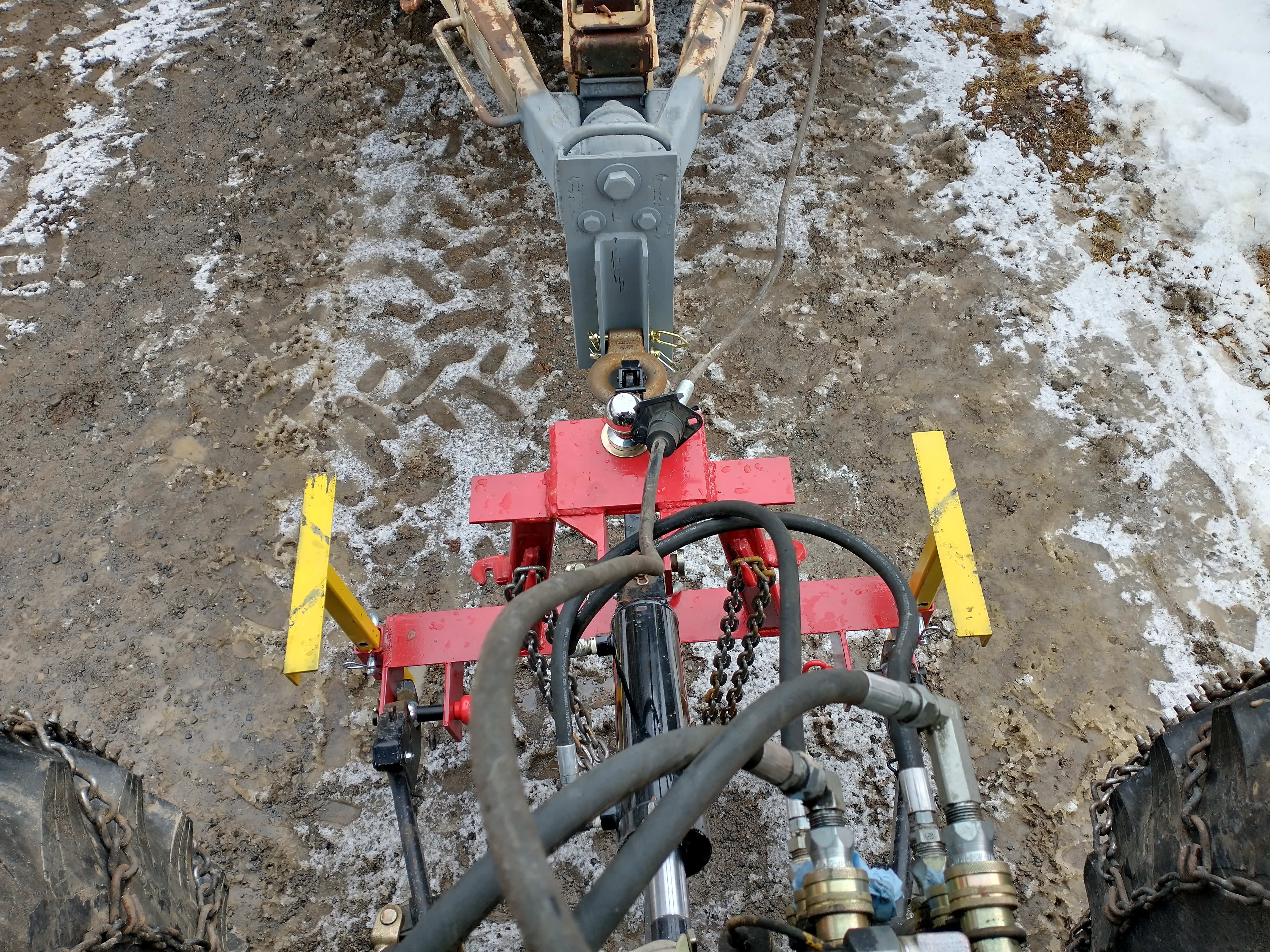

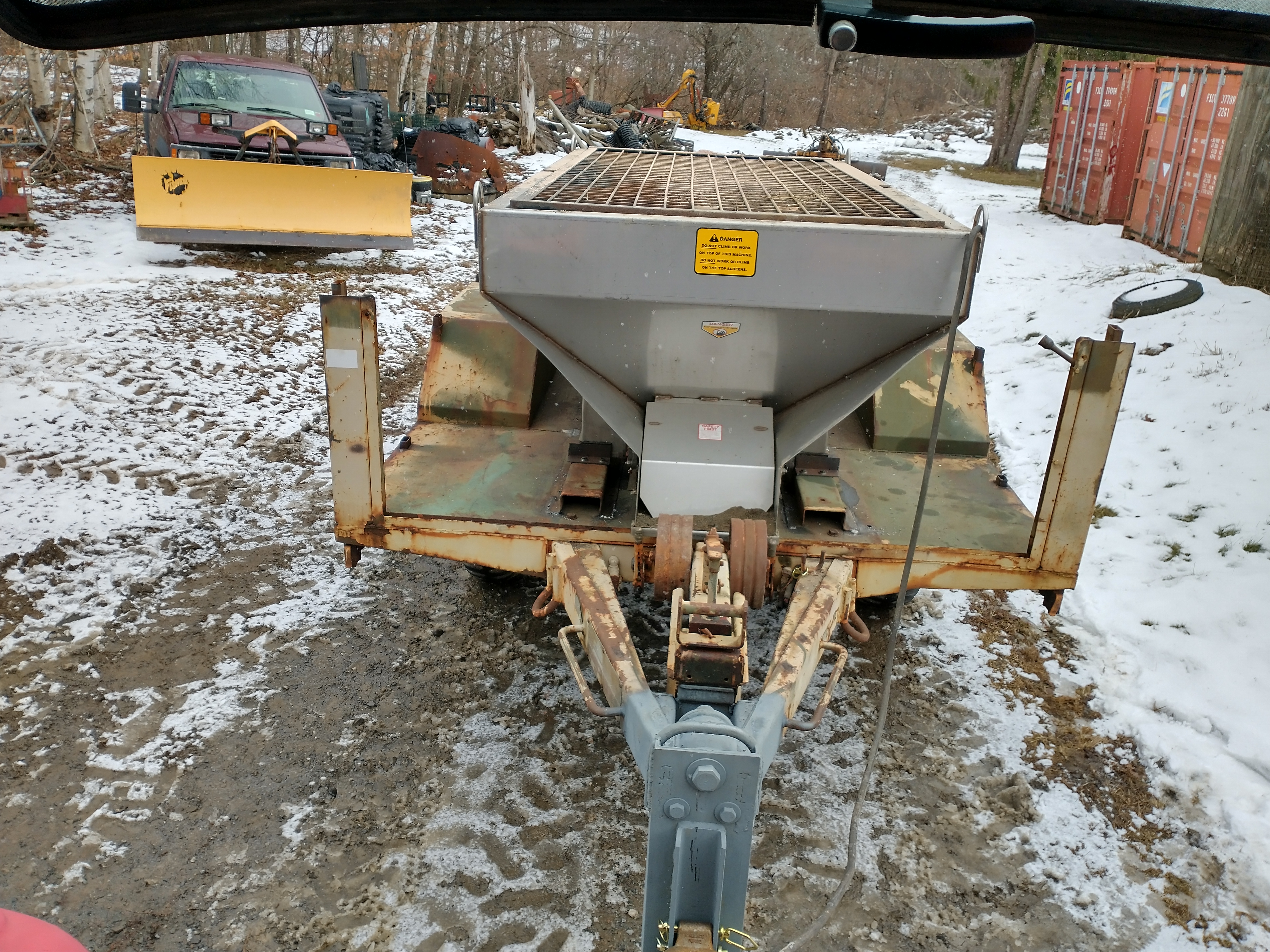

Used the Branson to check out my driveway sanding trailer;
brought it out of my low roofed shed using the front hitch
then hooked up to it with my rear 3 point trailer hitch;
and the view from the cab;
had dumped in 2 trash cans of ash from my insert and spread them on the driveway as a test run

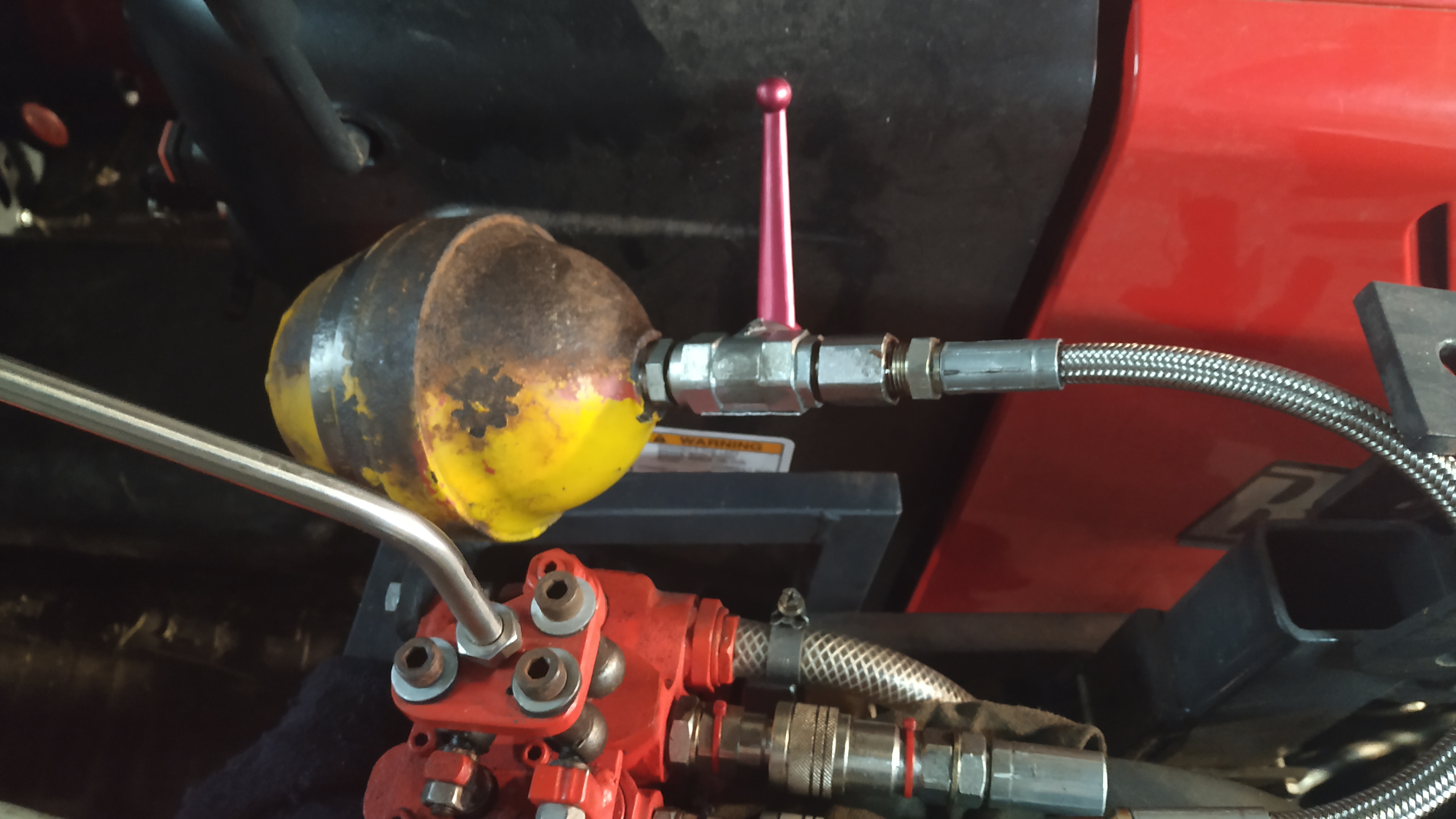

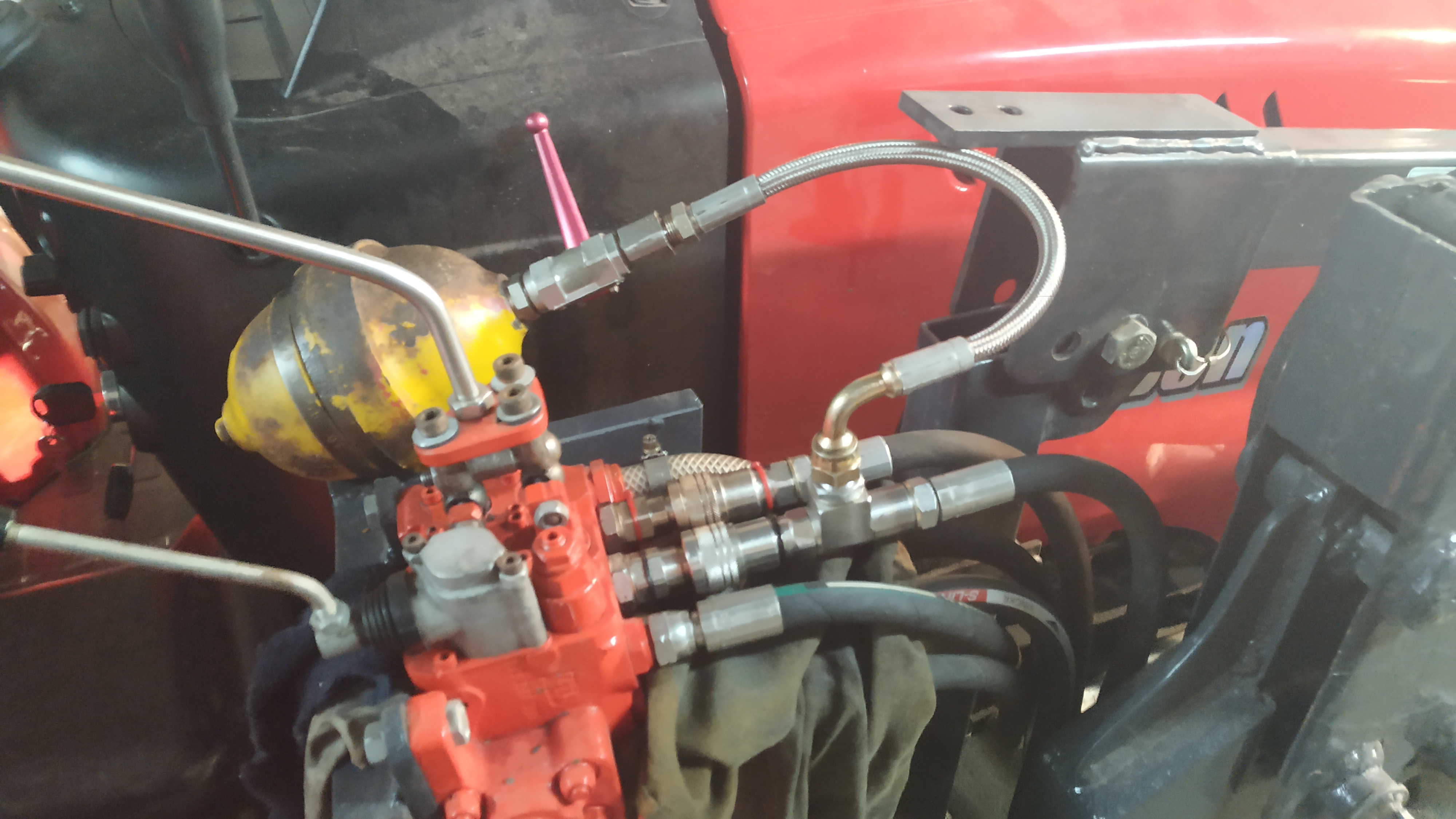

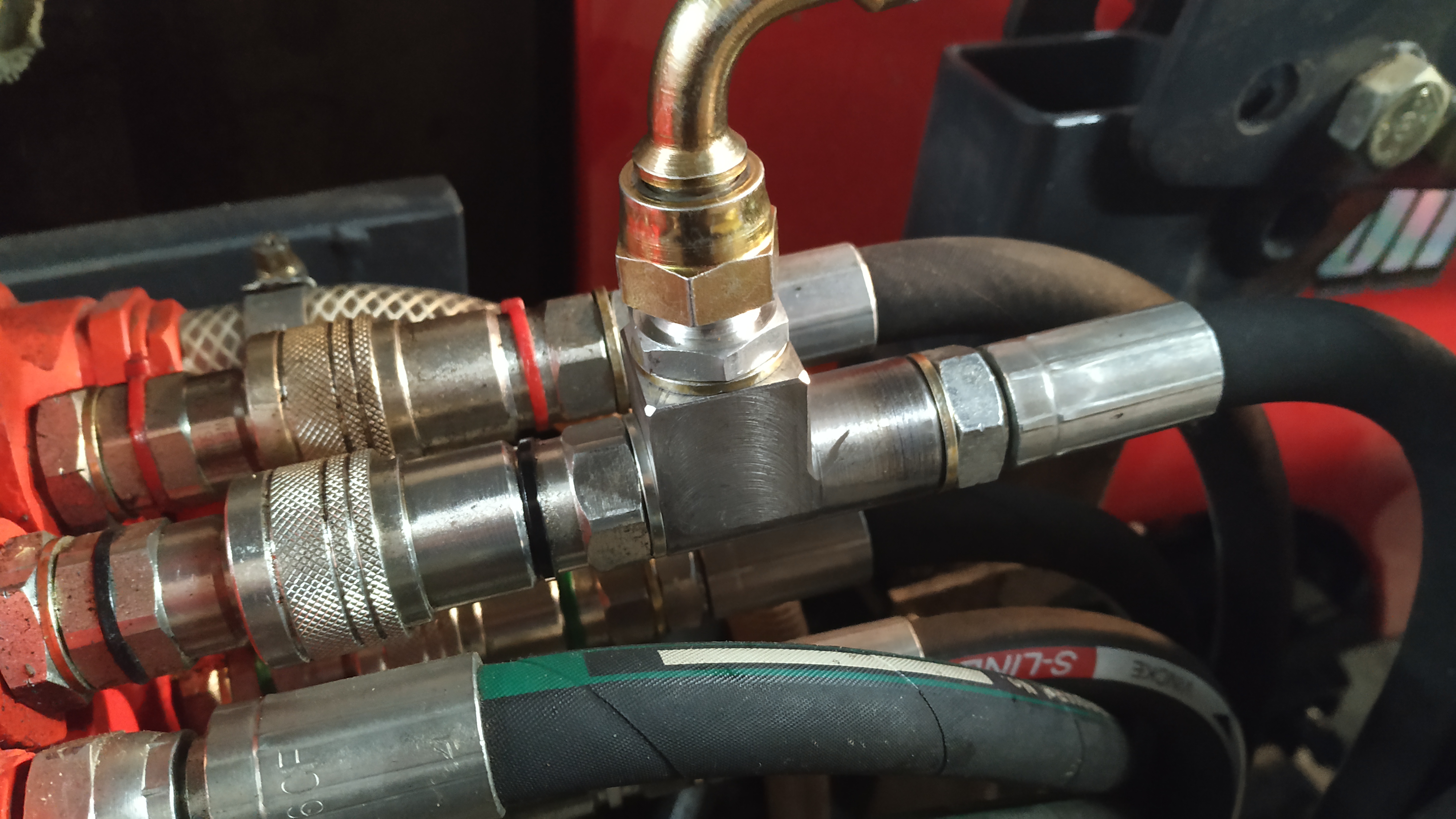

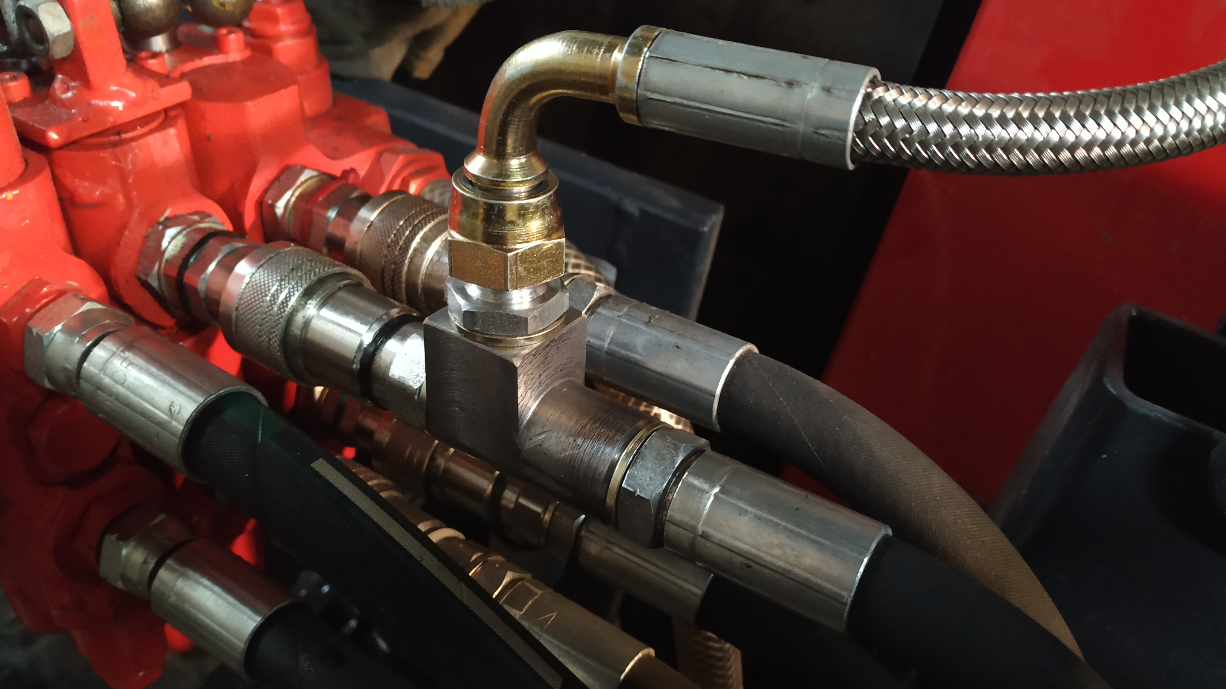

Beeing that we're under lockdown for a month, I took some time to go over some older stuff and found an old but still in good shape hydraulic accumulator. This came from the old days when we were building the backhoe and we could buy a bunch of hydraulic parts on the scrapyard for next to nothing. This was circa 2005.
Anyway, the accumulator is just the right size for a Soft ride system for my loader. So I connected the accumulator to my homemade hydraulic press to see if it was still charged and with how much pressure.
Turns out it was indeed in good shape internally and had about 55 bar or 800 PSI. If anyone is interested on how to check the pre-charge pressure of an accumulator, here is a simple and great video explaining it: Checking Hydraulic Accumulator Pre-Charge Pressure Wihtout Charging Gear - YouTube
Next I had to make a T fitting as I didn't have any. No big deal, throw a piece of round stock on the lathe, offset it about 10 mm or 3/8" so it gives me material for the middle port, machined both ends, then just took it to the mill to machine the rest. Came out very nice.
I rigged some fittings and a short piece of hose and mounted everything on the tractor.
IMG_20210119_180527.jpg IMG_20210119_180523.jpg IMG_20210119_174802.jpg IMG_20210119_174758.jpg
I did some quick testing, mostly by jumping on the forks and going over a bump on the road.
First thing I noticed is that 800 PSI is a bit too much. I knew this first hand, that's why I just rigged it together for testing purposes. With the loader 2 feet or so above the ground, it works but doesn't take all of the small bounces off because of too much pre-charge pressure I mentioned before. It takes a decent hit on a bump to notice the effect of the soft ride. On the other hand, this means that will be more effective with a load on it, like moving soil with the bucket or moving stuff around with the forks.
With the loader up high, it works much better and takes a lot of the small bounces too, but I don't usually drive with the loader up high. The ideal pre-charge pressure would be around 600 PSI. Most Soft ride kits come with pre-charged around the 600 PSI for a reason, I guess. :)
For now, I'll use it some more and get a real feel for it as the time goes by. If I like it, I'll just mount it permanently on the cross member. If not, I just take it off, no big deal, or maybe go to a hydraulic shop and have them reduce the pre-charge pressure.

Pedro, is the accumulator the yellow bulb? Is there a diaghragm in it or what is the operating principle?

Well, it was sort of a custom fitting and since we're on lockdown, I didn't feel going to the hydraulic shop and buy one just for one time use. I also like challenging myself in machining and learn about new ways to fixture the parts, machine, etc. It's a good learning exercise. :)
I should have another accumulator just like this, but for the life of me, I don't know where it is. I do have a vague idea that it was too far gone in rust to be useable.
If you're looking for this setup, the volume of it is around 0.5 liter to 0.75 liter with a pre-charge of 40 bar or 600 PSI.
Yes Bob, the accumulator is the yellow and rusty bulb. It's a diaphragm style. On one side, you have a pre-charge with nitrogen. The other side is where the hydraulic fluid pushes against the diaphragm. The nitrogen compresses and absorbs the shock of the loader.
The working principle is just like an airbag on the suspension of a truck. Instead of having the axle pushing the airbag, you have hydraulic fluid.

I thought so. A slightly different application of that principle is the use of a diaphragm tank (analogous to the accumulator) in conjunction with a water pump to pressurize well water systems. By pressurizing a volume of water beyond what's in the pipes you reduce the number of times the pump has to cycle on to keep the system pressurized. The side of the diaphragm opposing the water is pressurized or "charged" with air. If I remember correctly the pressure switch on my water pump is set to 55 psi and the diaphragm tank is charged to 60 psi.
