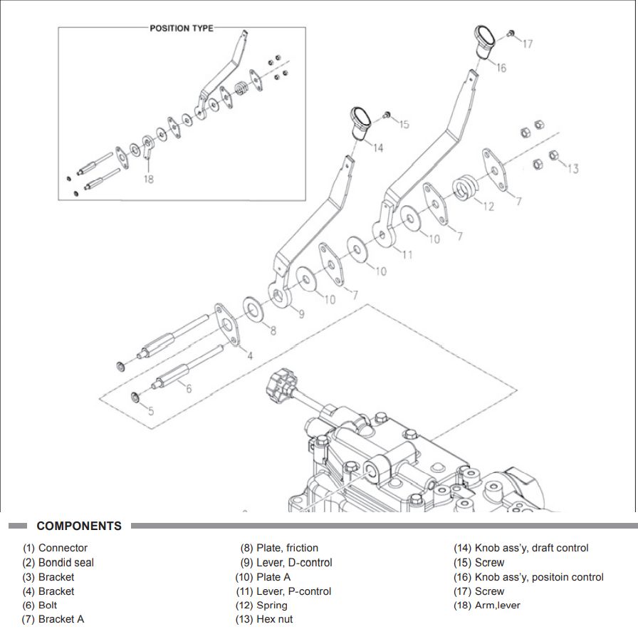

For others that may be interested in adjusting the friction on their 3 point position lever; I just looked through the service manual and put together this picture that shows what to look for. I assume you back of the double nuts (#13) and loosen the bolts (#6). Now, if I can just get to them:)

Yes, those are the nuts. It's either 12 or 13 mm wrench. Can't quite remember now but I check that out tomorrow.
I can see it being quite a chore on a cabbed tractor. :laughing:

I adjusted mine, no problem to do it on a cab.
   / What have you done to your Branson today? #699
Just backing out the double nuts does it.
   / What have you done to your Branson today? #700
I found it. The 4720C cab must be considerably different than the 4815C. It is underneath and shouldn't be too hard to access but I will have to pull the rear wheel.
