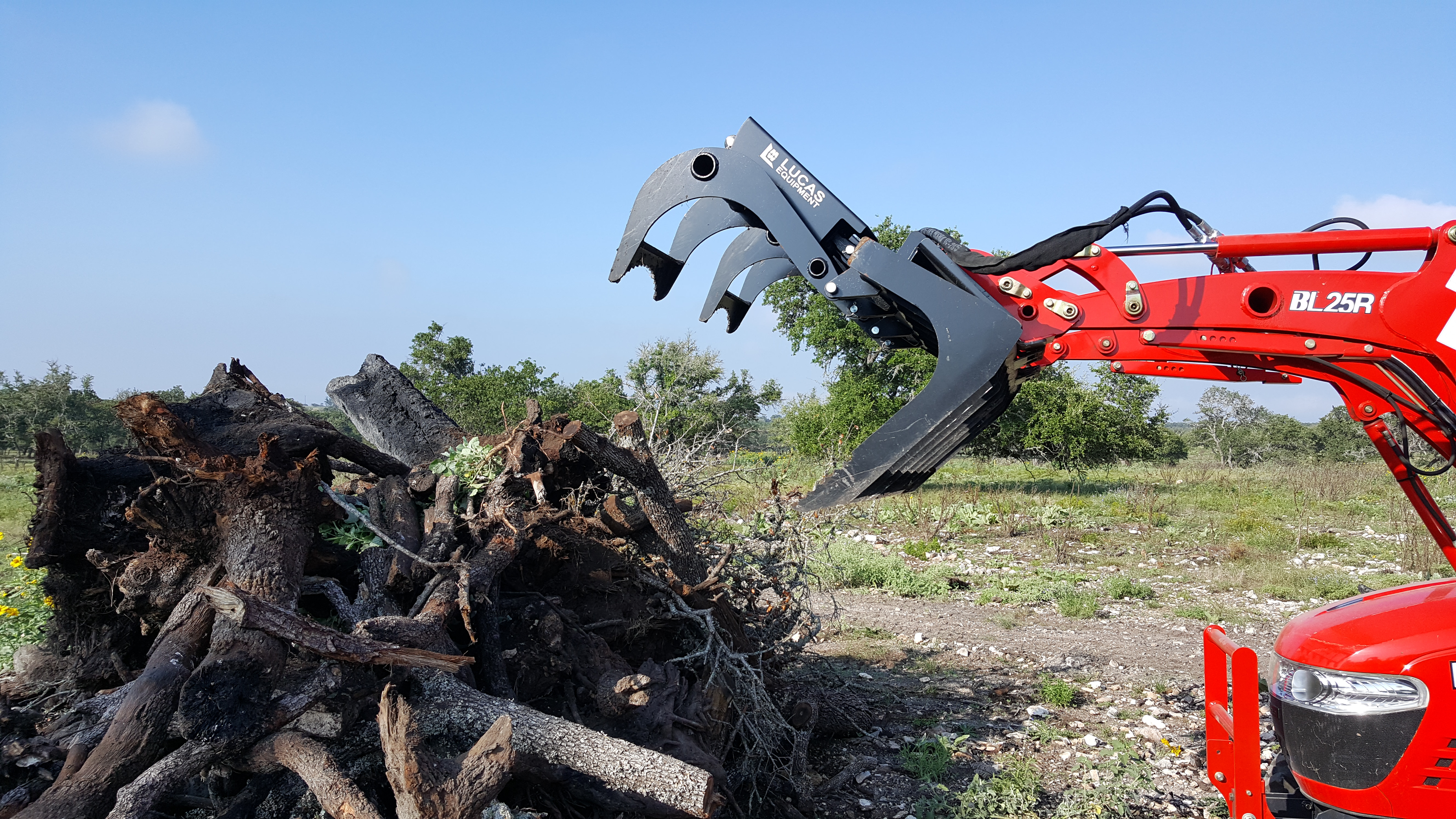

Ran the hydraulic lines for the grapple to the rear remote... I debated on getting the 3rd function for the joystick but after using it this way I'm actually good with how it's working....View attachment 486220
Does that mean you operate the grapple function with the 3point lever?

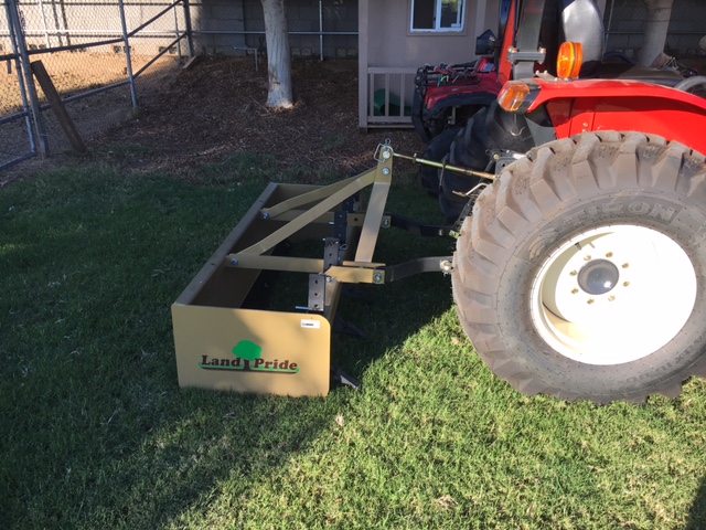

not the 3-point... there are 2 levers just to the right of the seat on top of the fender, one lever is a return to center and the other stays where you put it... the return to center is what I operate the grapple with, the other will be used for a log splitter that I will be getting shortly... there are 2 sets of hydraulic connectors above the pto, the lines for the grapple run from there...
