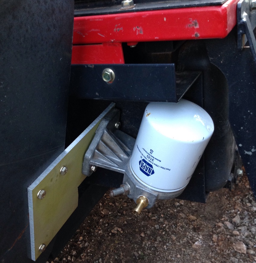

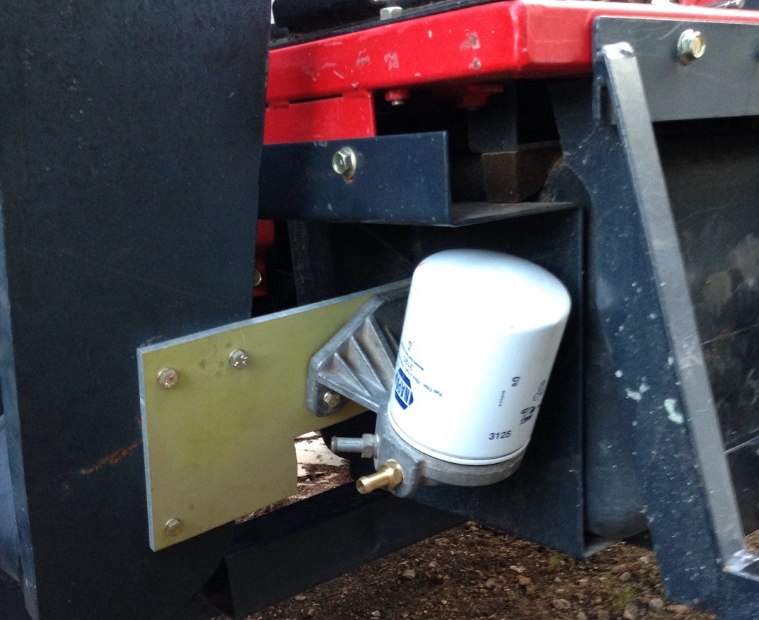

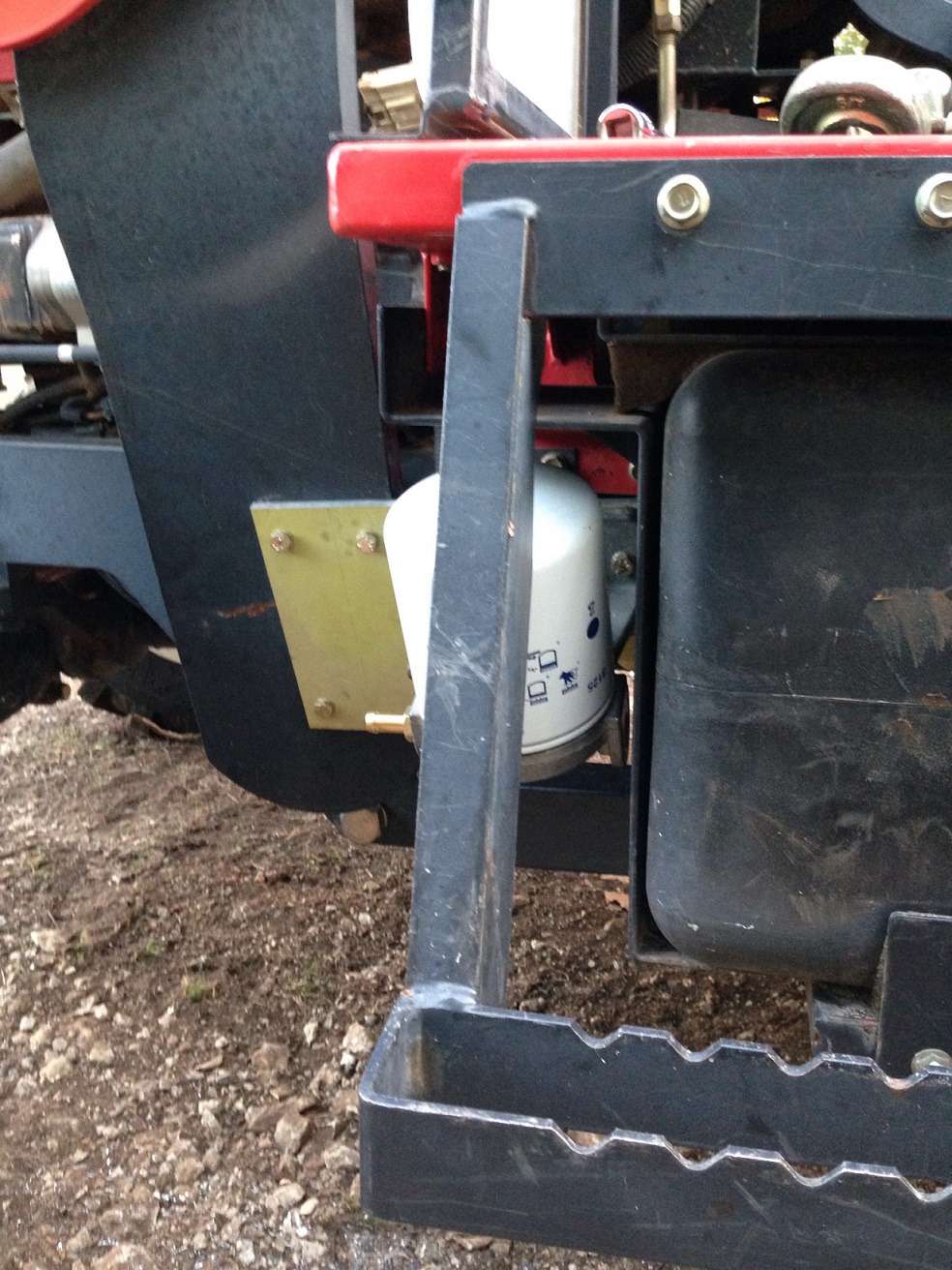

I added a "first line of defense" fuel filter down near where both tanks are "Tee'd" together, but it's not plumbed in just yet.
It fits very nicely in this location.
I didn't necessarily spend any money - - this was all stuff "I just had laying around". Filter mount is from a Marine Detroit diesel.

I have read if your filter is before the pump you'd be better off with your fittings on top, which helps remove air. The fuel run isn't long so it might not matter. According to the article, when the filter is before the pump (on the suction side) the pressure difference tends to remove entrained air from the fuel in both gassers and diesels, which contributes to all kinds of problems. If I remember correctly, the fittings, placed on top, help remove the accumulated air in these cases.
   / What have you done to your Branson today? #45
It's OK, this is a just a "mock-up". The actual filter will be a 3123, which has an air bleed (or drain) on top.
The way the base is designed, I doubt air would ever be a problem anyway.
I'm still going to move the lift pump down low someplace.
I think you've got a greater chance of air in the system with where it's located on the upper firewall.

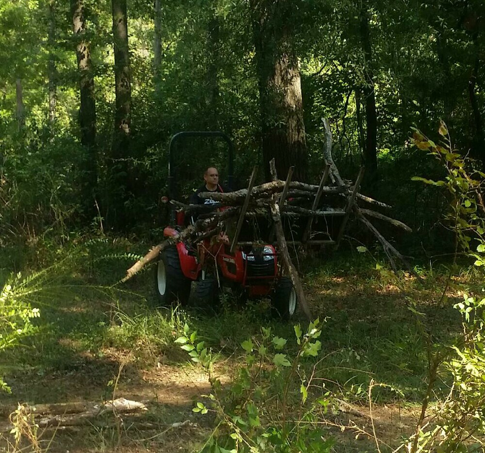

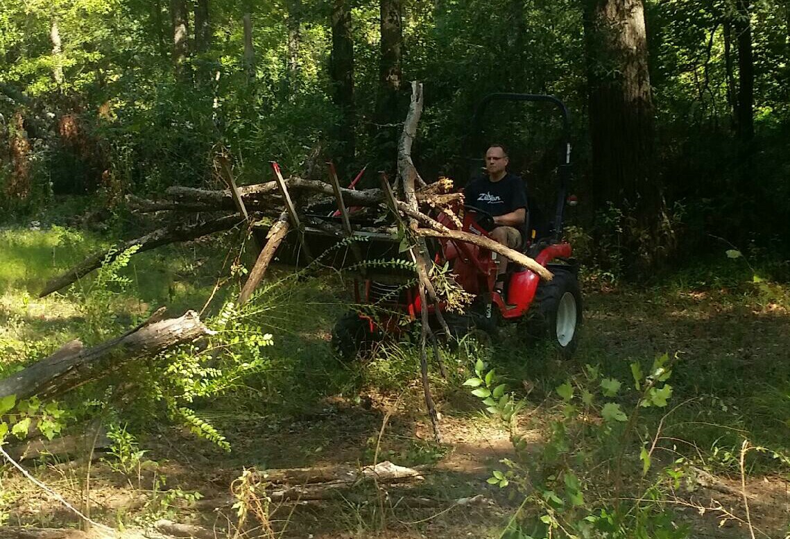

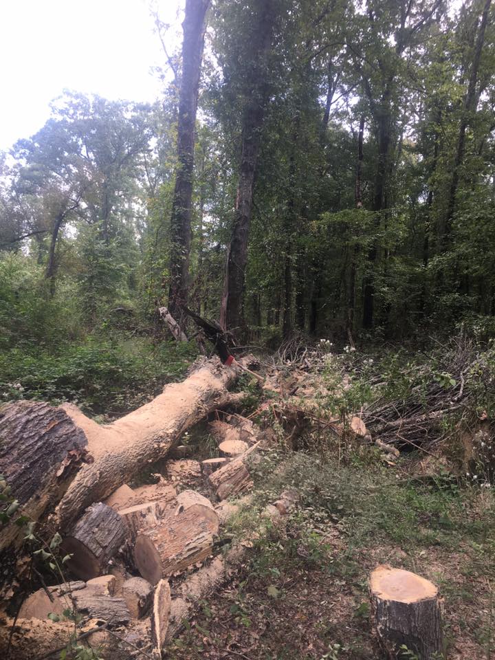

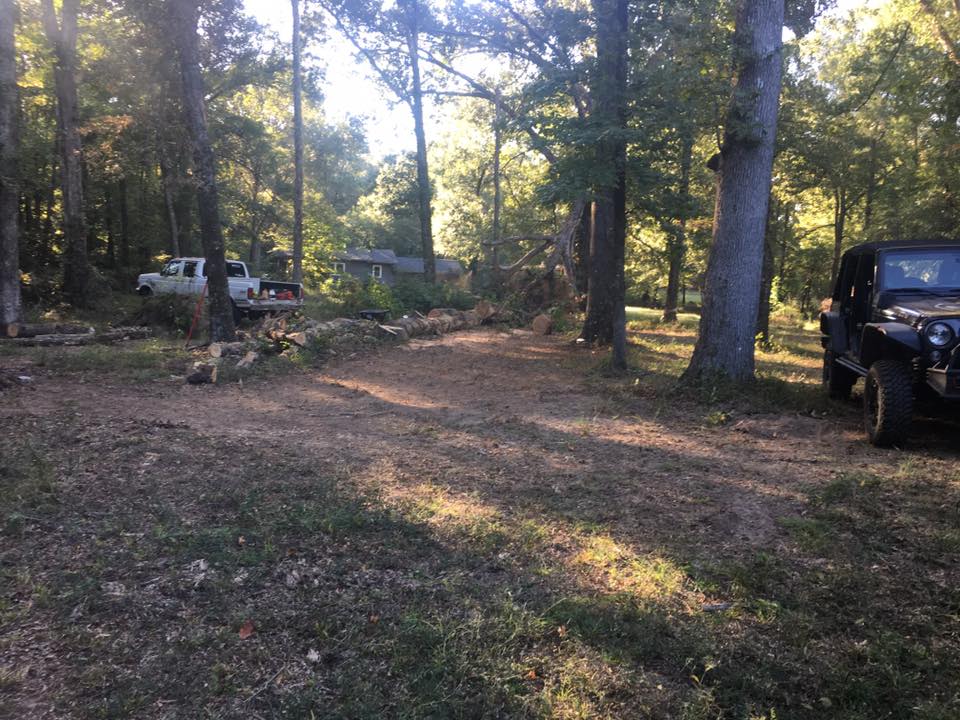

putting the debris forks and Ratchet Rake to work for a few hours on my 2400H
before:
Friend taking a test ride
Area after a couple hours work

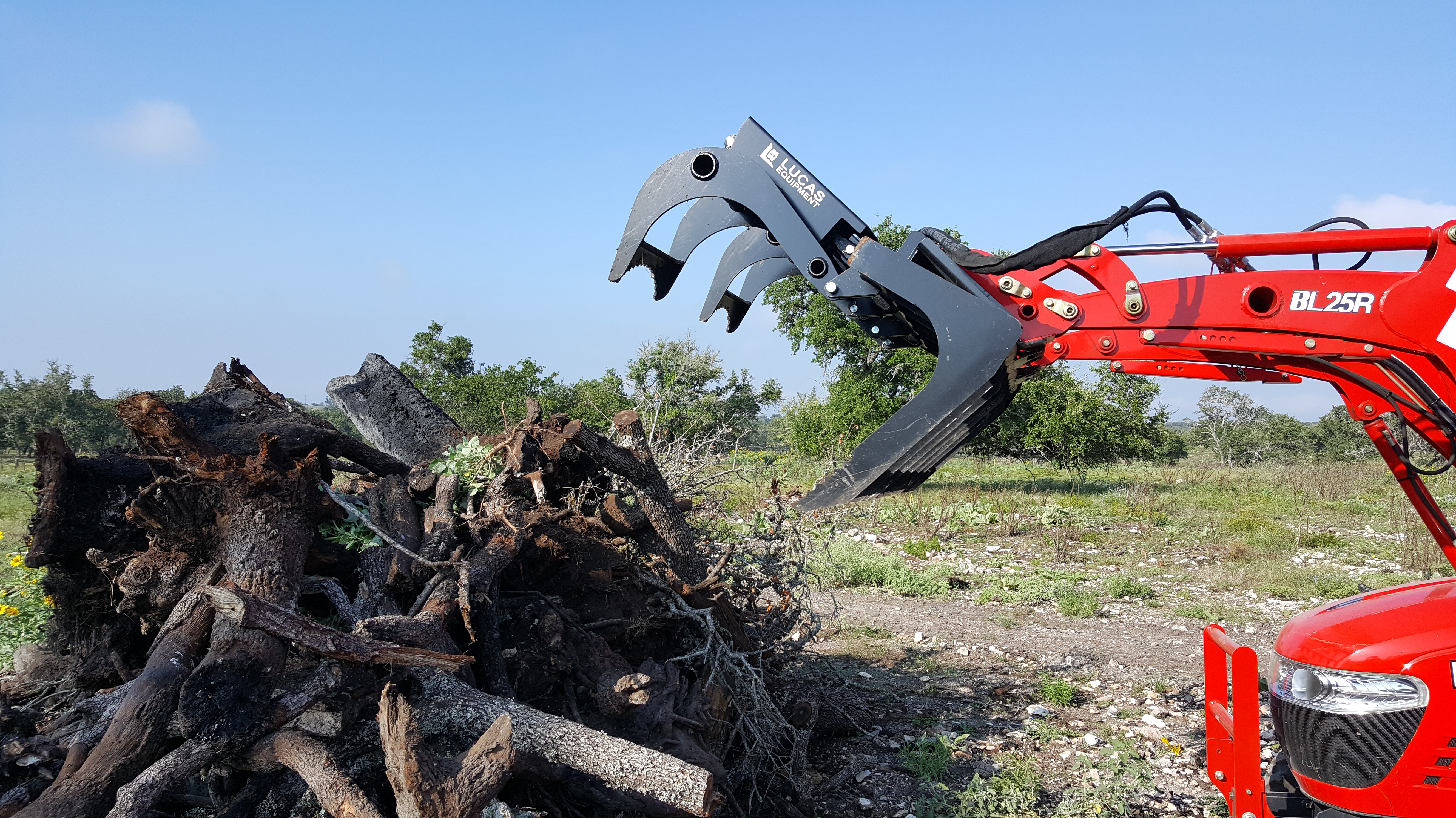

Ran the hydraulic lines for the grapple to the rear remote... I debated on getting the 3rd function for the joystick but after using it this way I'm actually good with how it's working....20160828_092430.jpg
